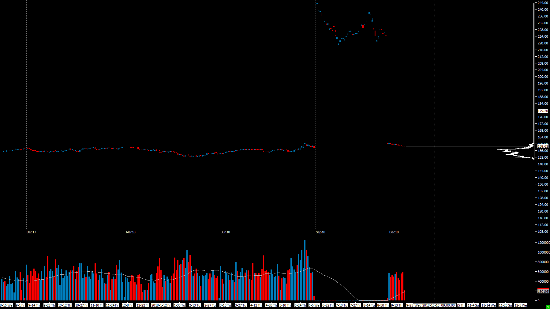

Using IQ-feed. Why does the september contract get out of order like this?
I have set "continous contract to Date rollover, back adjusted" and 800 days to load.
http://www.sierrachart.com/image.php?Image=1537445318678.png
Date Time Of Last Edit: 2018-09-20 16:58:21
[2018-09-20 19:43:17]
In general none of the continuous futures contract functionality works with IQ Feed symbols. We do not recommend using it.
Re-download all the data in the chart by going to the chart and selecting "Edit >> Delete All Data and Download".

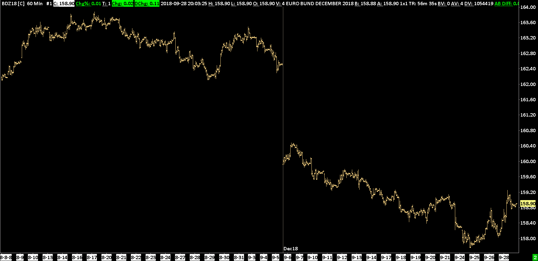

User750920 - Posts: 297
I am new to Sierra but am familiar with used to use IQfeed. I would try this. Use the actual front month symbol for IQfeed (in this case it appears to be BDZ18) and then use the continuous contract functionality in Sierra Chart.
What I think is the issue is using the Continuous contract of IQfeed and the continuous contract functionality of Sierra at the same time.
Unless I am wrong (possible) then there should not be any conflict, unless there are problems with IQfeed symbols altogether which I would think unlikely.
[2018-09-28 20:43:00]
We have now looked and we see that we have defined rollover rules for the IQ Feed BD futures symbol. Therefore you can reliably use the Sierra Chart Continuous Futures Contract feature.
But then again if there are no rollover rules defined for the symbol within Sierra Chart, it would be of no consequence to use the functionality in Sierra Chart. It just would not do anything.
This is what we currently see for that contract:
http://www.sierrachart.com/image.php?Image=1538167350192.png
We want you to follow the instructions here to re-download the data for all contract months:
Date Time Of Last Edit: 2018-09-28 20:43:38
