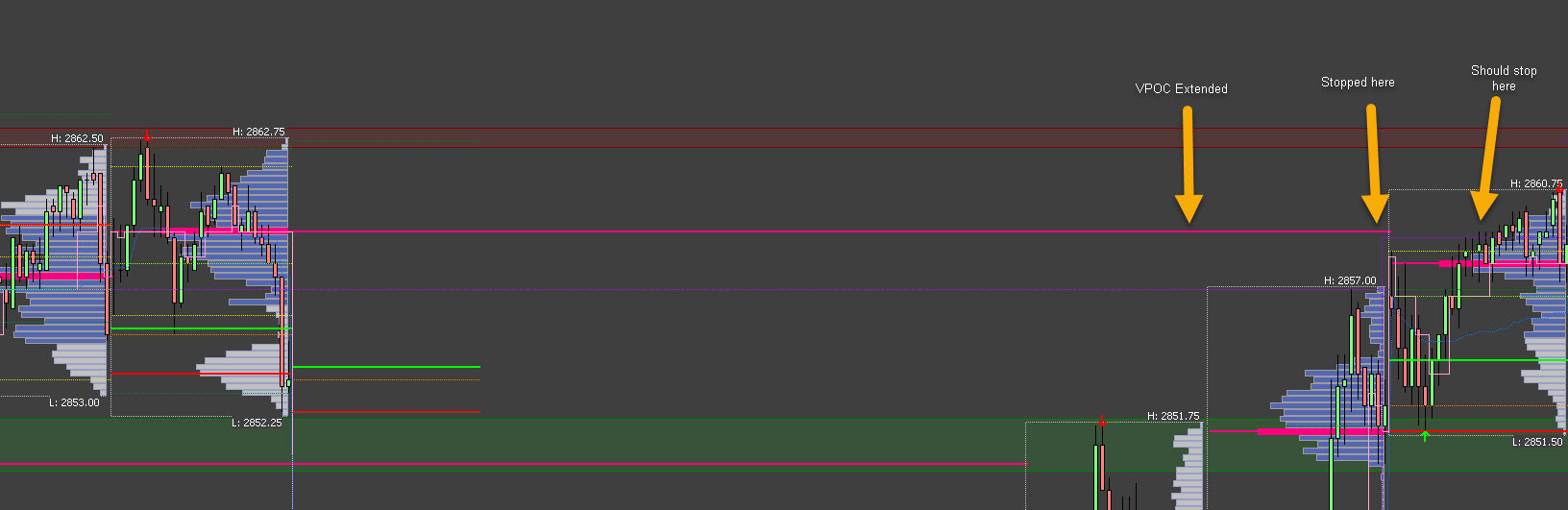

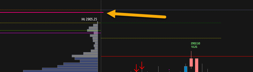

I have POC enabled to extend until future intersection however the line stops at the beginning of the day instead of the point of intersection and it's not visible anymore. Is there a way to make the line go until the bar that made the POC touch?
Screenshot attached
Date Time Of Last Edit: 2018-09-18 15:06:21
image2018-09-18_11-01-15.jpg / V - Attached On 2018-09-18 15:04:01 UTC - Size: 41.61 KB - 669 views
image2018-09-18_11-05-57.jpg / V - Attached On 2018-09-18 15:06:18 UTC - Size: 138.13 KB - 586 views
[2018-09-18 16:20:15]
No, there is no other option to have the line extend any further than it currently does.

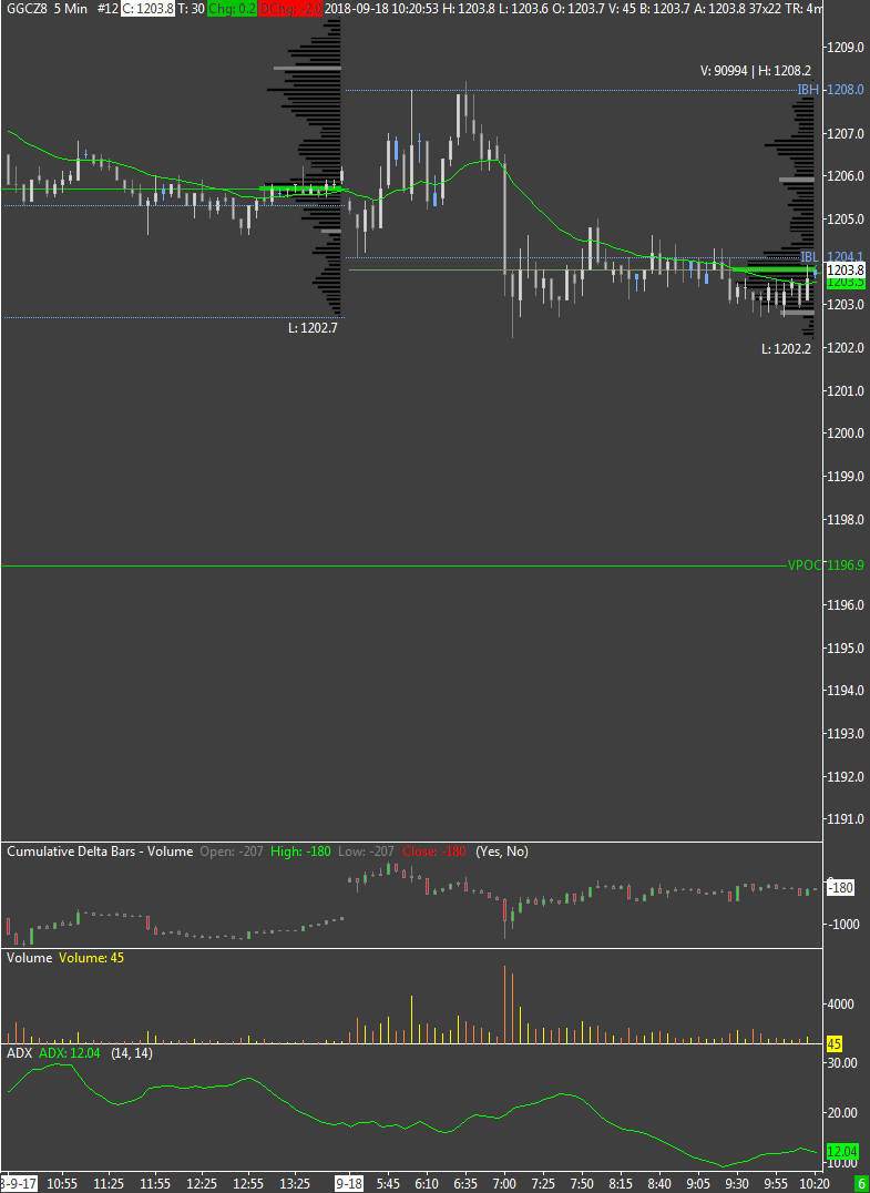

User750920 - Posts: 297
@PF_FD Curious as your first picture shows what you are saying but your second picture the vpoc was intersected so it will stop at the day of intersection.
Unless I am misunderstanding see the picture below - The naked vpoc is extended to the price scale.
http://www.sierrachart.com/image.php?Image=1537291255975.png

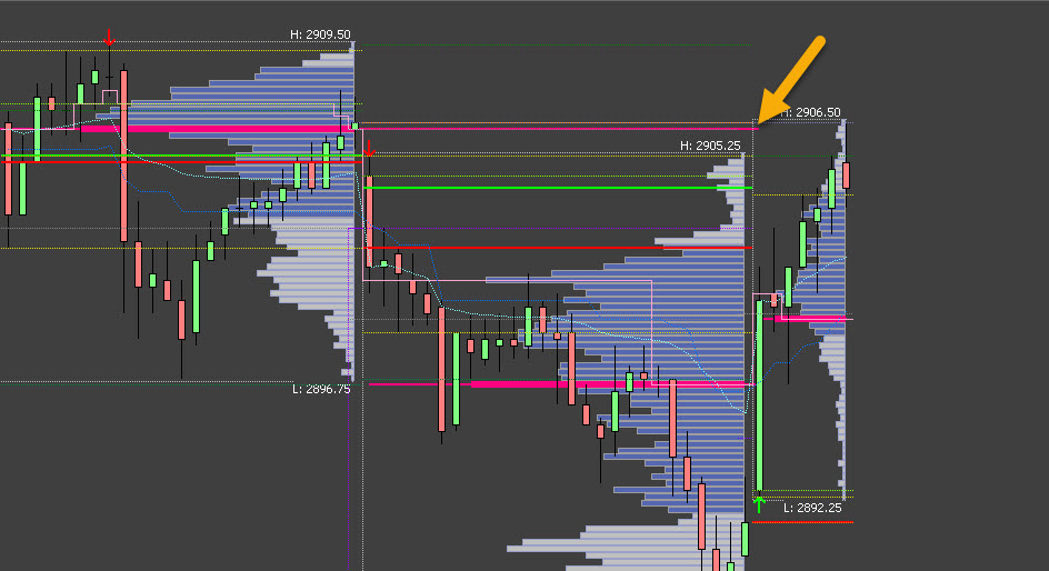

See attached.
You can clearly see that it stops at the beginning of the day IF there is a bar during that day that touched that price.
What I want to see is that pink line touch the actual bar that reached POC price.
Hope it makes sense.

Rino - Posts: 124
I would have to guess that it is calculated using day.
Which would make sense. How could they do it otherwise
with so many chart variables. (Times, Range, Renko, Etc)
However it works on Numbers bars. But then again you are specifying the
bar type.
PS As you know you can do as I do in prep, and draw a horizontal line
using the same color. That is what I do.
PSS Naturally I concur with you and would be nice if they could do it.
