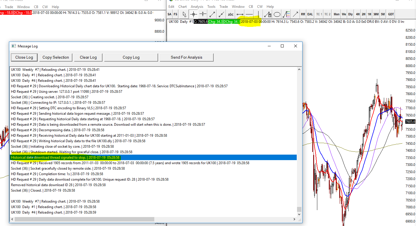

I have noticed that SC is not downloading all of the 'UK100' symbol data and actually stop st 2018-07-03 for some reason. The Message Log doesn't give any sign that there is a download issue? I have also noticed I have the same issue with the following:
US30
SPX500
NAS100
UK100
ESP35
EUSTX50
FRA40
GER30
All of the FX pairs appears normal.
Please can you advise whatever maybe going on and for me to resolve? I have tried the Remove Data and Download Data option in the Edit menu already which didn't help.

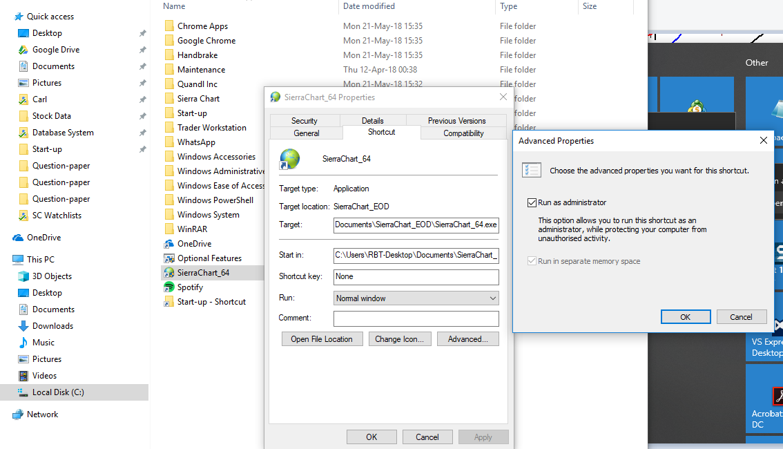

The actual problem was my clock. For other users, ensure that your
Periodically Set System Date-Time from Server option
System Error When Setting Date-Time
If you receive the following error in the Window >> Message Log, then either uncheck the Global Settings >> General Settings >> Periodically Set System Date-Time from Server option or set Sierra Chart to run with administrator level access (explained below). This error is an indication that the operating system permissions or version is not allowing a program to set the system Date-Time.
Additionally, I noticed tat my Shortcut to the 64 bit version wasn't set to Run as Administrator. To do this, I have created a simple Screenshot. This was the problem. Ensure this is set to Administrator as this was causing my chart not to show the latest data. Presumably the connection failed because my Clock was somehow set incorrectly.
imageRun As Admin.png / V - Attached On 2018-07-20 06:30:01 UTC - Size: 107.29 KB - 439 views
