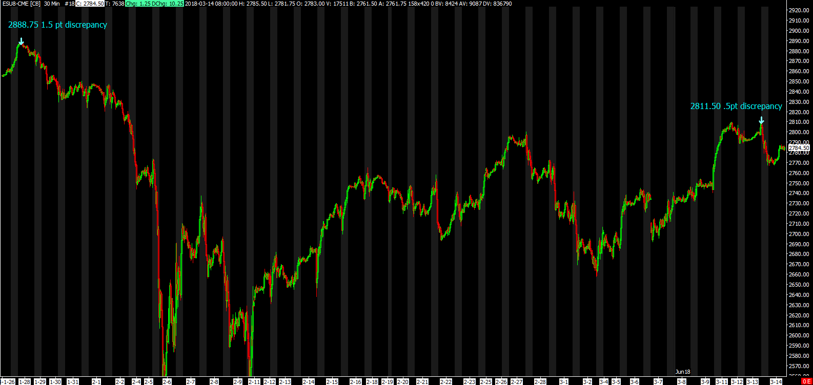

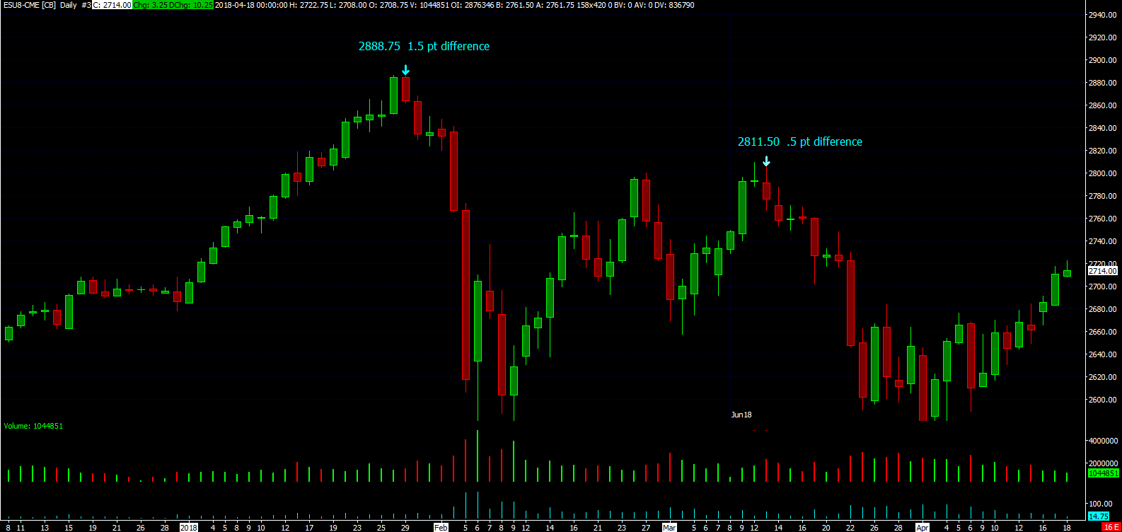

Going back six or more months in both Historical and intraday charts, exchange pricing using Rithmic data is incorrect, by four to six ticks. Current data is OK.
I've compared to Tradestation and talked to other traders using other services, and the discrepancy holds up.
See the attached charts. This issue seems to be recent. I'm running SC v.1767, and have deleted and reloaded data several times.
Thanks,
Tom Hervert
Historical chart:
http://www.sierrachart.com/image.php?Image=1529699365278.png
Intraday chart:
http://www.sierrachart.com/image.php?Image=1529699444717.png

I've followed all instructions provided, but no data adjustment has successfully occurred. The discrepancy still exists.
I also attempted adjustment per chart using the Edit << Adjust Data command. No change to the data resulted. As it stands, the following inaccuracy still exists:
ESH8: chart data reads 1.5 points high
ESM8: chart data reads .5 points high
This discrepancy is unacceptable for accurate historical data construction needed for proper analysis. Future rollover issues are likely if not addressed.
I'd appreciate any other suggestions you may have.
Tom Hervert
