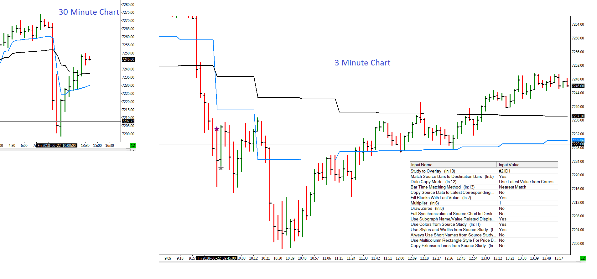

[2018-06-22 18:21:27]
rahul - Posts: 173
I am attaching an example of a 30 minute chart crossover on a 3 minute chart. After the crossover on the 30 minute bar is done at 10:00 AM, it shows up on the 3 minute chart at 9:45 AM. Is there anyway to calculate the 30 minute bar value on the 3 minute chart to reflect crossover at 9:45 AM in real-time instead of waiting for 30 minute bar close?
I am attaching the Study Overlay settings and snapshot of the example
imageSettings.png / V - Attached On 2018-06-22 18:20:11 UTC - Size: 70.19 KB - 463 views
[2018-06-23 19:44:42]
Set Data Copy Mode to Containing Match:
Study/Price Overlay Study: Data Copy Mode
[2018-06-23 19:50:25]
rahul - Posts: 173
Thank you. Setting to containing match worked.
