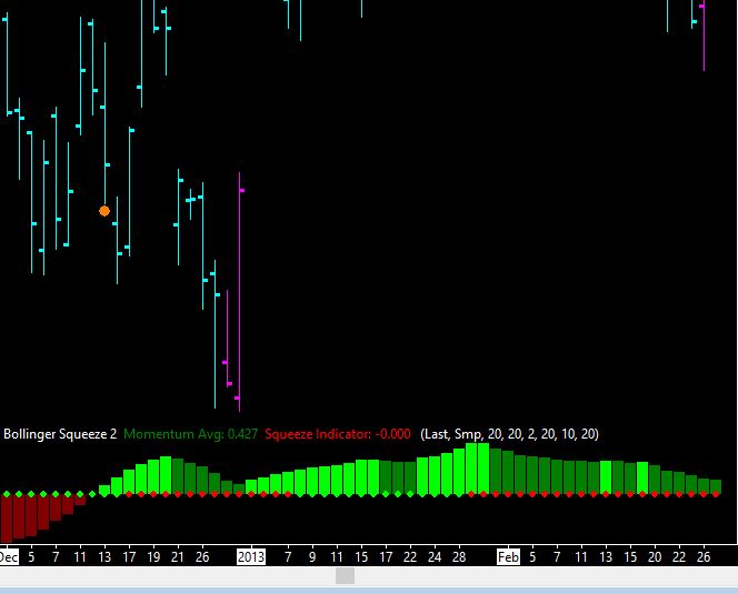

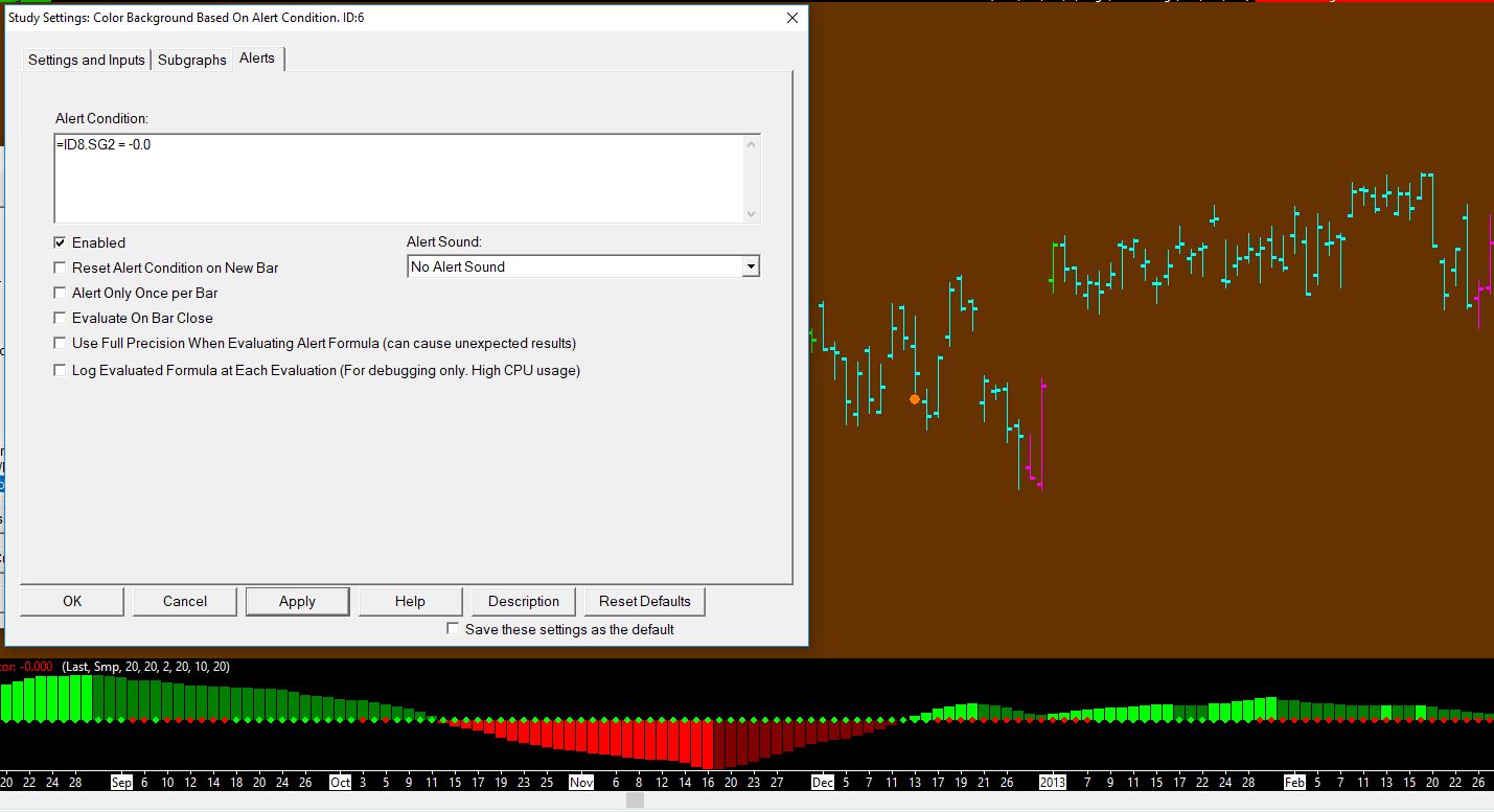

I would like to color background on the red dots which have a value of -0.0. The green dots have a value of 0.0. Attached shows the -0.0 value, and the failed attempt.
TIA
imageBBS2 Red Dot.JPG / V - Attached On 2018-01-05 18:46:51 UTC - Size: 42.2 KB - 513 views
imageBBS2 Fail.JPG / V - Attached On 2018-01-05 18:53:00 UTC - Size: 124.28 KB - 516 views

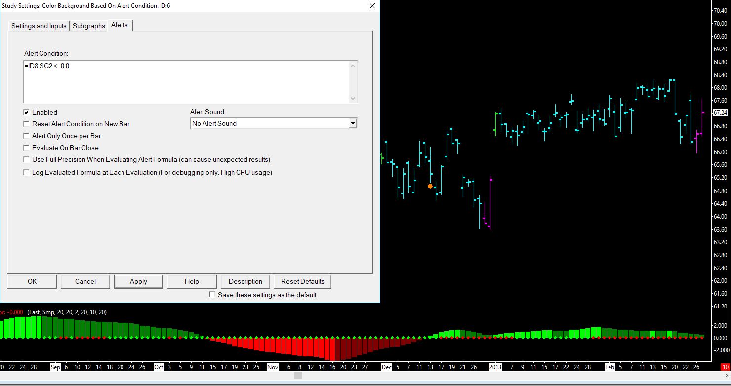

User312841 - Posts: 26
I did try that previously, and that did not work either.
imageBBS2 Less Than Fail.JPG / V - Attached On 2018-01-05 19:29:46 UTC - Size: 126.37 KB - 474 views
[2018-01-05 20:12:15]
Do not use -0 but just 0.

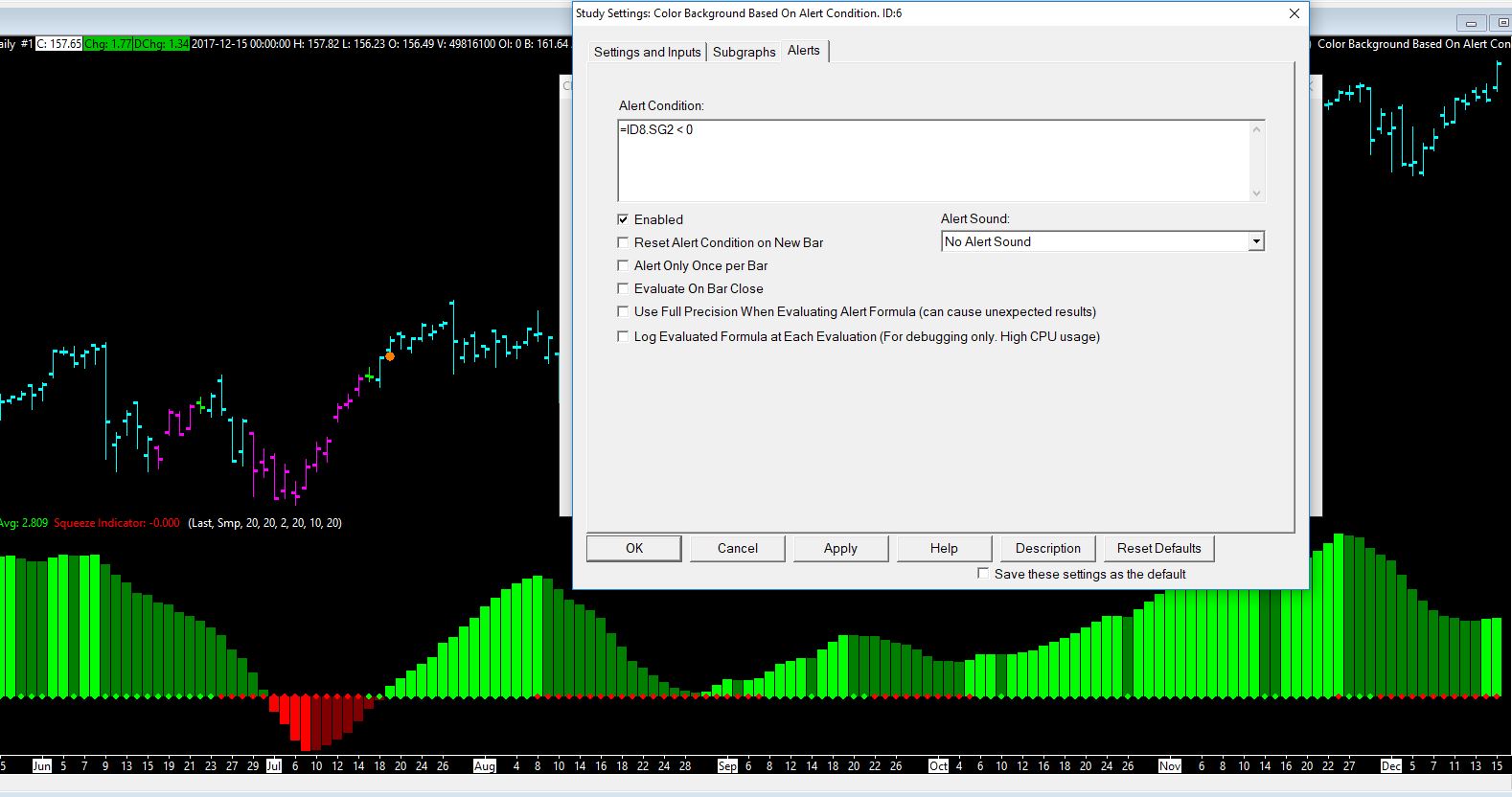

imageBBS2 Less Than - no minus - Fail.JPG / V - Attached On 2018-01-05 20:33:15 UTC - Size: 160.04 KB - 543 views
[2018-01-08 06:02:03]
Enable the option Use Full Precision when Evaluating Alert Formula.
We will make the value for the dots .001.
