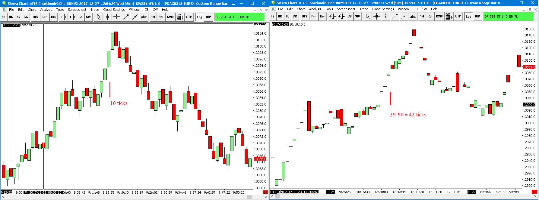

[2017-12-27 11:17:24]
gomifromparis - Posts: 244
I tried it, but like my own code, it doesn't fill the gaps
See DAX : when market is liquid it's ok we get 10 range bars, but on the start on the march contract, with big gaps, they are not filled.
The debugger also shows that IsInsertFileRecordsProcessing is never true.
Anything I need to set somewhere ?
Date Time Of Last Edit: 2017-12-27 11:17:34
imagesierrarangegap.png / V - Attached On 2017-12-27 11:16:31 UTC - Size: 63.62 KB - 684 views

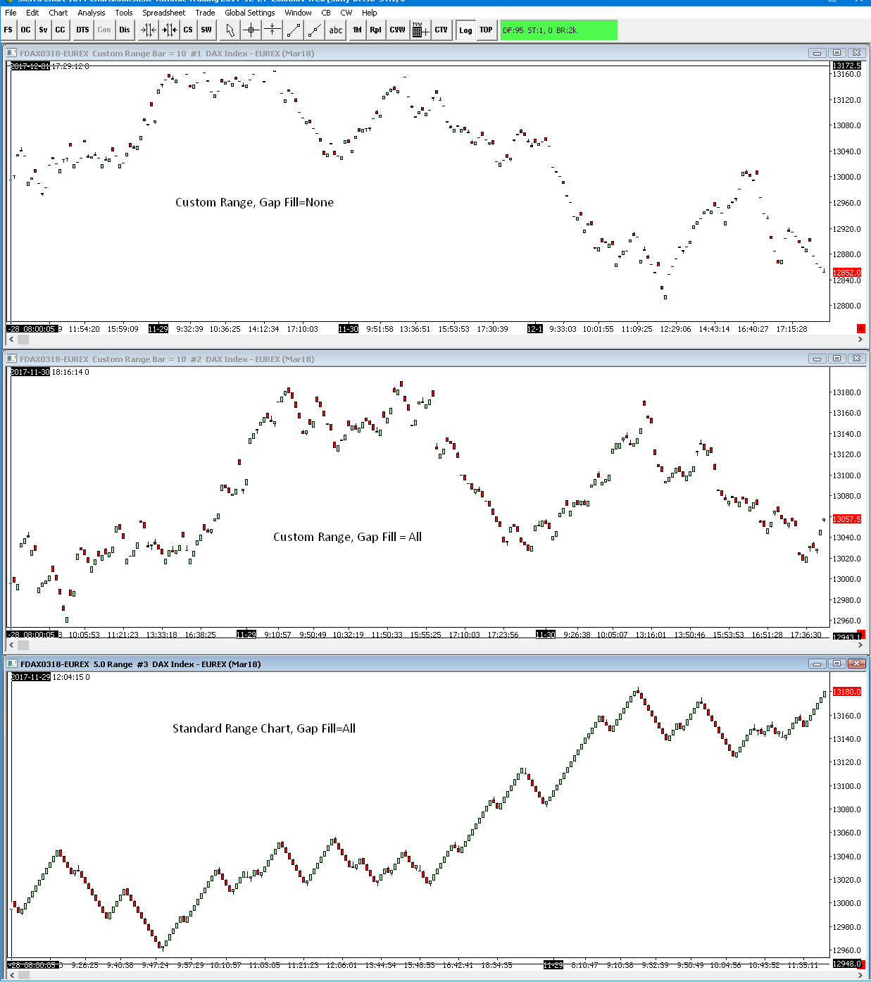

[2017-12-27 22:20:42]
I tried the 1677, but it's still not behaving like expected.
Now IsInsertFileRecordsProcessing is always true, on every call of the function ; it appears some bars do get created, but the chart still does not have the correct look of the standard gap filled Range chart.
imagecustomgapfill.png / V - Attached On 2017-12-27 22:19:55 UTC - Size: 64.58 KB - 664 views
[2017-12-27 23:03:39]
We apologize for this. We had not done any testing related to the variable. We have now and it is corrected.
We have now released a new revision of 1677. Update again. Although the version will remain the same.
Regarding gaps, we do not have much time to look at that now, but see if there is any difference.
