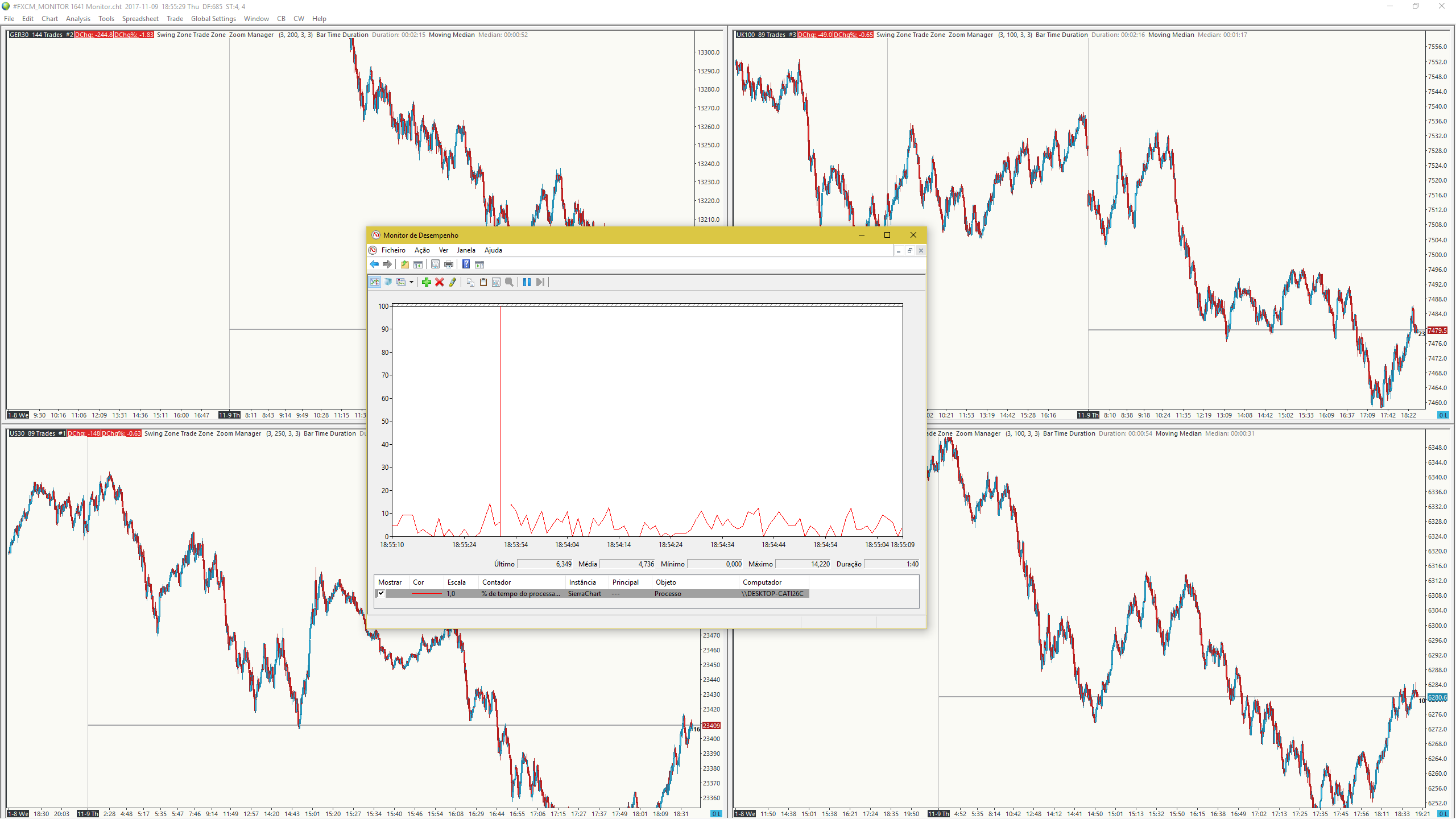

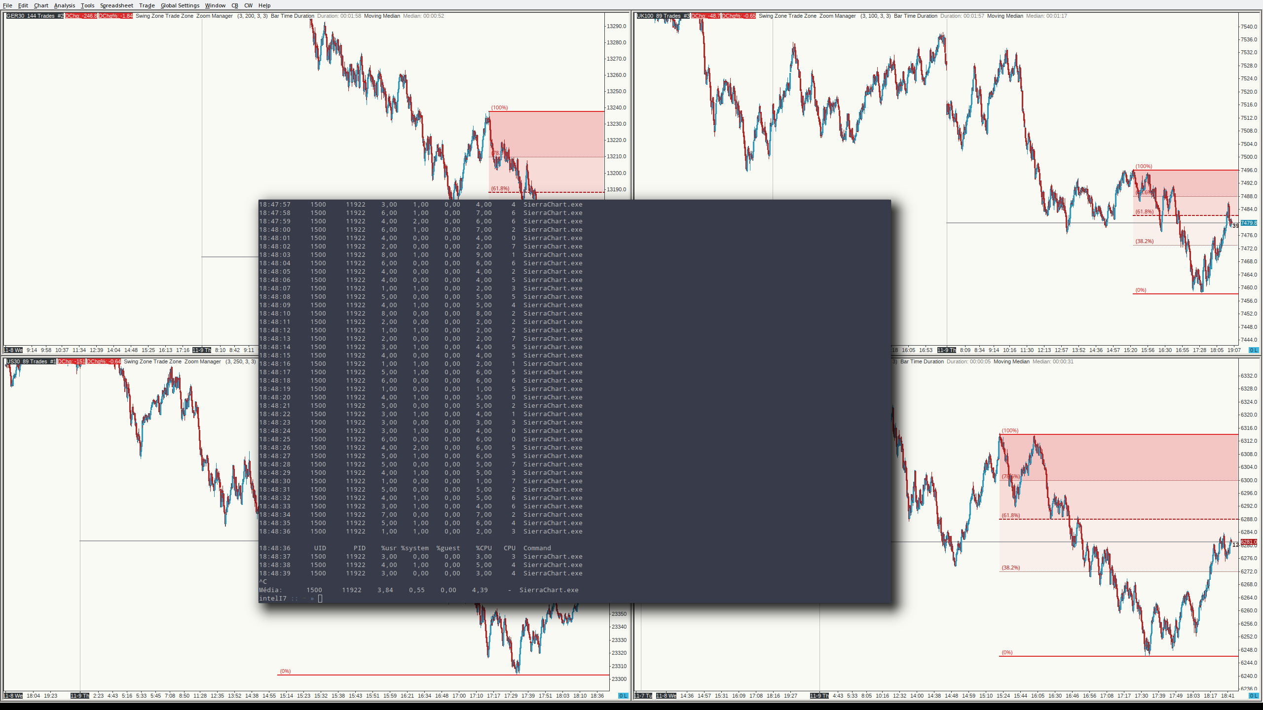

[2017-11-09 19:06:13]
AlexPereira - Posts: 197
Ganz, is this enough for you to buy and AMD card ? Or at least to not think I was making it up ?
imageLinuxWine.png / V - Attached On 2017-11-09 19:03:26 UTC - Size: 306.89 KB - 542 views
imageWindows10.png / V - Attached On 2017-11-09 19:03:36 UTC - Size: 190.94 KB - 552 views

[2017-11-09 20:30:50]
Ganz,
linux video: https://youtu.be/obSHtph7BsI
windows video: https://youtu.be/RfqaWNOIb-0
was this kind of test ok ?

[2017-11-09 21:25:16]
2. Set the Same Link number and Scroll Position to On and move all charts at once from left to right with the middle speed you choose - it sholud takes 2-3 sec-s -then back 2-3 times.
Didn't understood this well: "I don't know Scroll Position to On" ? I have enabled "Synchronized charts" to on, since they move all charts.
There is a process viewer on the left, and the history of cpu usage from sierrachart on the left terminal.
Hope what you were looking for is in here : https://youtu.be/T-yRni4gtLM
PS: if you have trouble because of the multi monitors, let me know, i will do everything in one crowded monitor.
