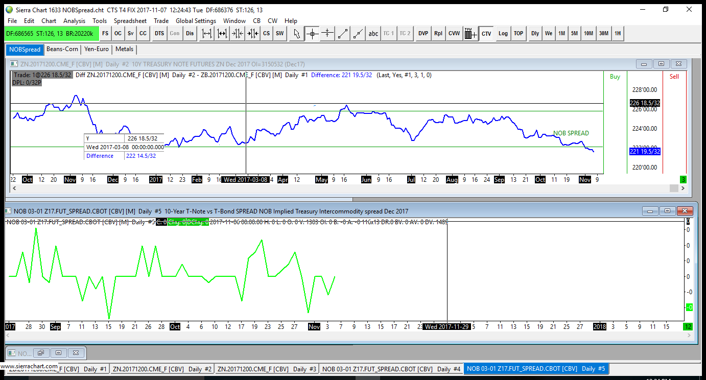

User841161 - Posts: 356
Also in looking at NOB Spread, the top chart is NOB Spread in which I created manually and NOB Spread below is from the exchange traded symbol in Sierra Charts. The NOB spreads should look the same..
imageUploadImage.png / V - Attached On 2017-11-07 18:26:25 UTC - Size: 79.81 KB - 596 views
[2017-11-07 19:08:55]
We would not expect them to be the same because there is going to be a variation of the data between these two different methods.
If you want to trade exchange traded spreads with CTS, follow the instructions here to get the spread symbols:
https://www.sierrachart.com/index.php?page=doc/CTS_T4.php#GettingAdditionalFuturesAndSpreadSymbols
Once you have a chart open for the spread you can just trade them just normally.
Date Time Of Last Edit: 2017-11-07 19:10:30

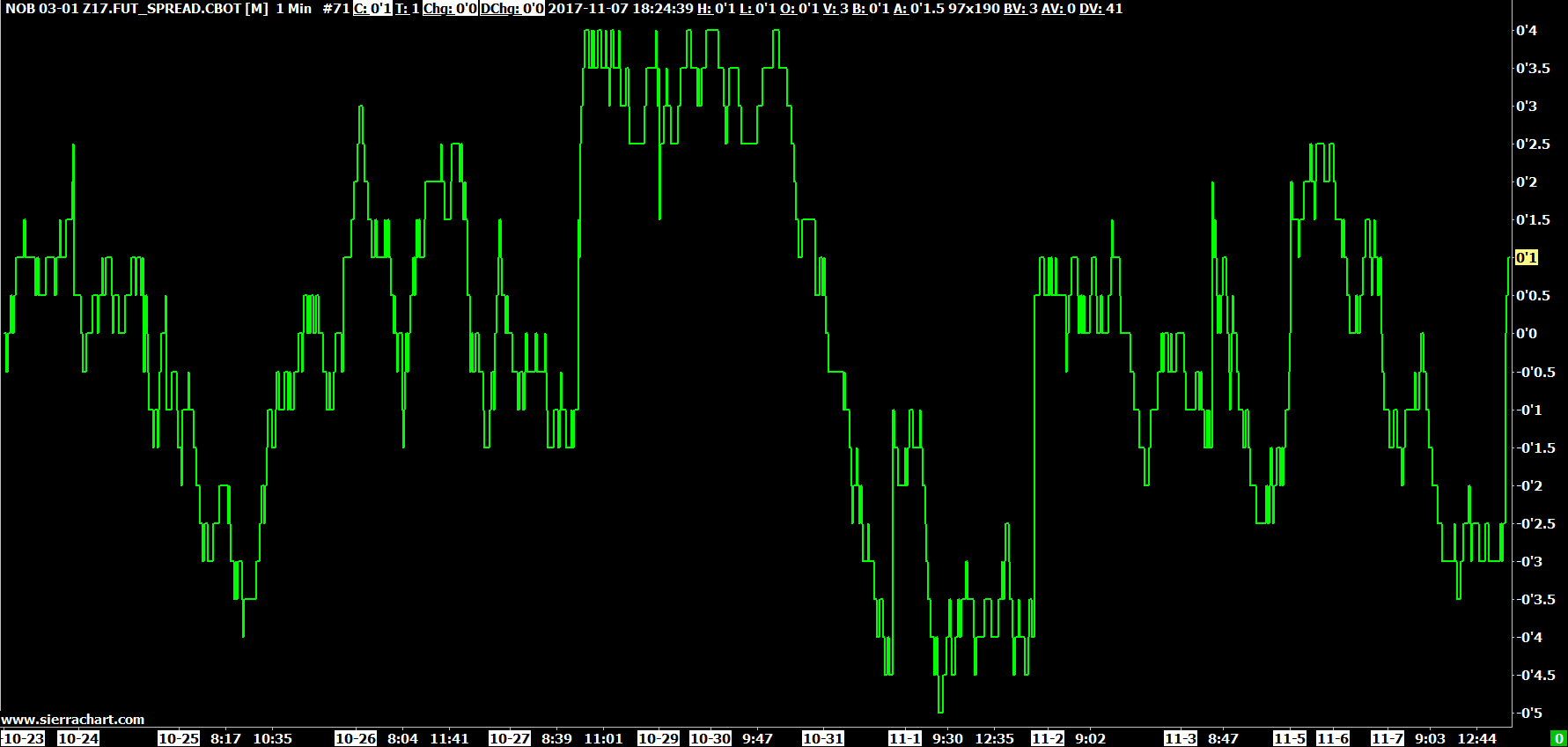

[2017-11-07 22:07:30]
This NOB Spread chart from Sierra Charts Data, charts with no Y axis. Doesn't look anything close to what NOB Spread should look like.
Don't know if there is a setting awry.
[2017-11-07 23:29:42]
Using a Line on Close Graph Draw Type, this is what we see for the NOB spread:
http://www.sierrachart.com/image.php?Image=1510097337403.png
Make sure Chart >> Chart Settings >> Auto Set From Data Feed is enabled.

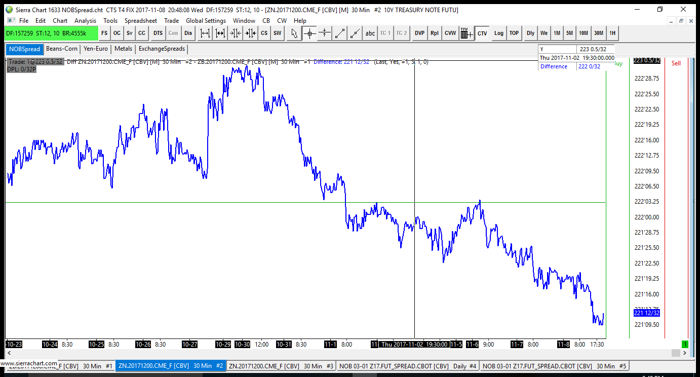

Yes Price increment changes by .5/32 but Nob Spread should be 3 Notes - Bonds, where Notes price is 125 5/32 and Bonds Price is 154 4/32. So 3*(125 5/32)- 154 4/32= =221 11/32= NOB Price. So axis should have 221 11/32 on it along with other 221 ' increments. Like manual chart attached..
imageUploadImage.png / V - Attached On 2017-11-09 02:49:44 UTC - Size: 73.12 KB - 570 views
[2017-11-09 02:52:58]
The data you see is straight from the exchange. It must be correct.
