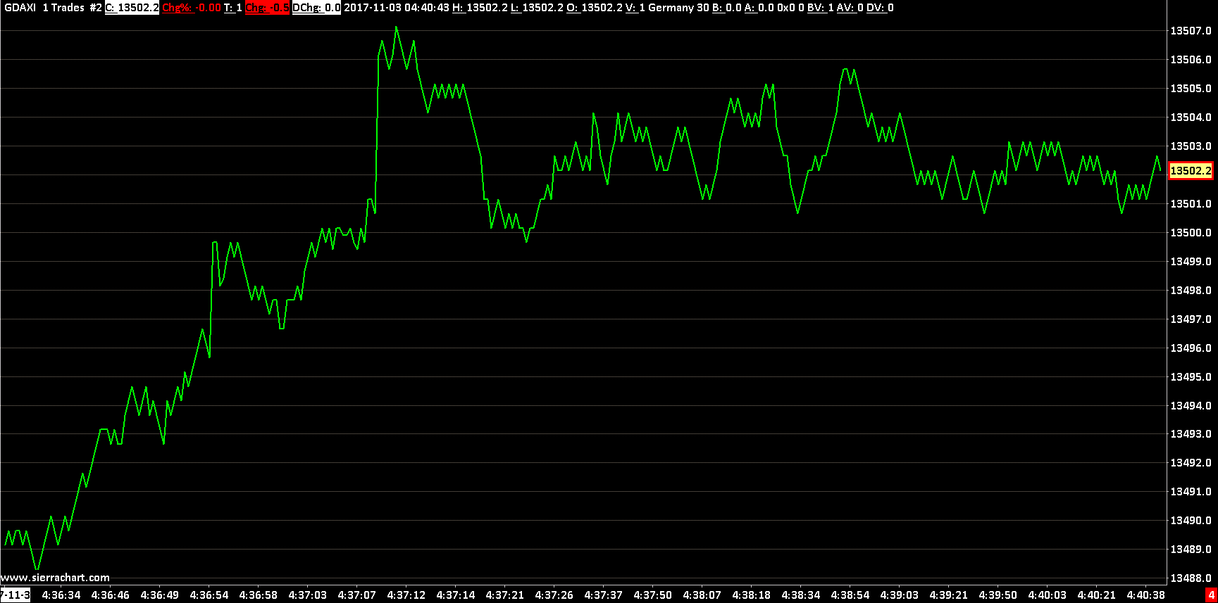

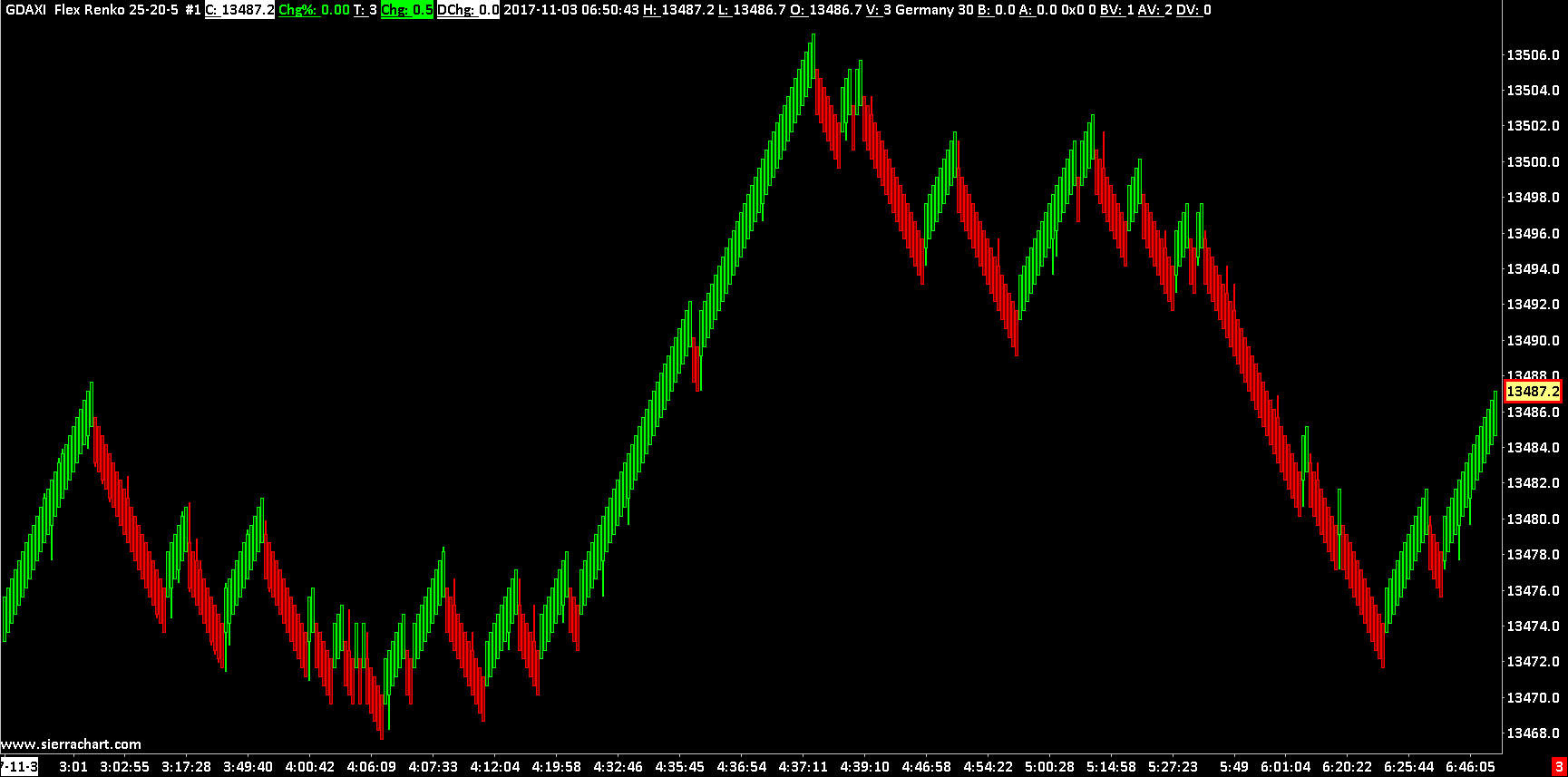

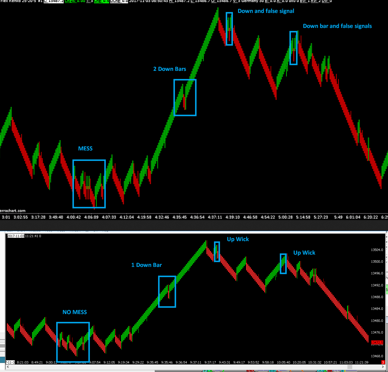

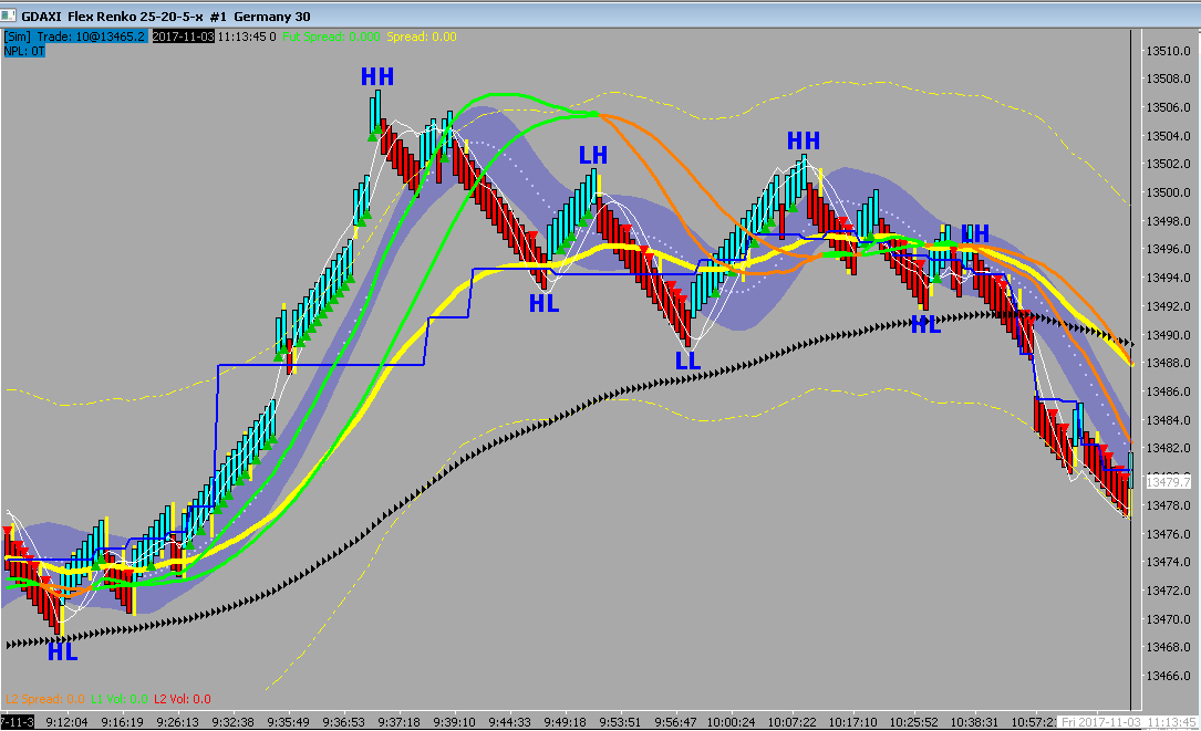

The title pretty much sums it up, here's LMAX GDAXI 1605 vs 1635
image1605.png / V - Attached On 2017-11-03 19:44:45 UTC - Size: 56.9 KB - 776 views
image1635.png / V - Attached On 2017-11-03 19:44:49 UTC - Size: 45.66 KB - 809 views

There are no problems with Flex Renko bars on the current version. Instead refer to:
Renko Bar Charts: Filling of Price Gaps with Renko Bars
If you are not happy with what we are currently offering, then stay on the previous version.
Date Time Of Last Edit: 2017-11-03 21:34:00
[2017-11-03 20:58:08]
We tested the configuration you are using, and even with filling gaps, we do see a small problem where the High-Low of the bar does not match up with the brick/body in a very small number of cases. This detail is going to be resolved in a few days.
Date Time Of Last Edit: 2017-11-03 21:34:48
[2017-11-03 21:11:03]
OK, with filling of gaps as documented in the section we linked to in the prior post, and a small correction related to bar splitting that we just made now but not released, this is what we currently see:
http://www.sierrachart.com/image.php?Image=1509743402731.png
So everything should be 100% good in the next release.
Date Time Of Last Edit: 2017-11-03 21:32:49
[2017-11-03 21:35:16]
We corrected the link in post #2. It was not correct. This is what we meant to link to:
Renko Bar Charts: Filling of Price Gaps with Renko Bars (Filling Price Gaps)

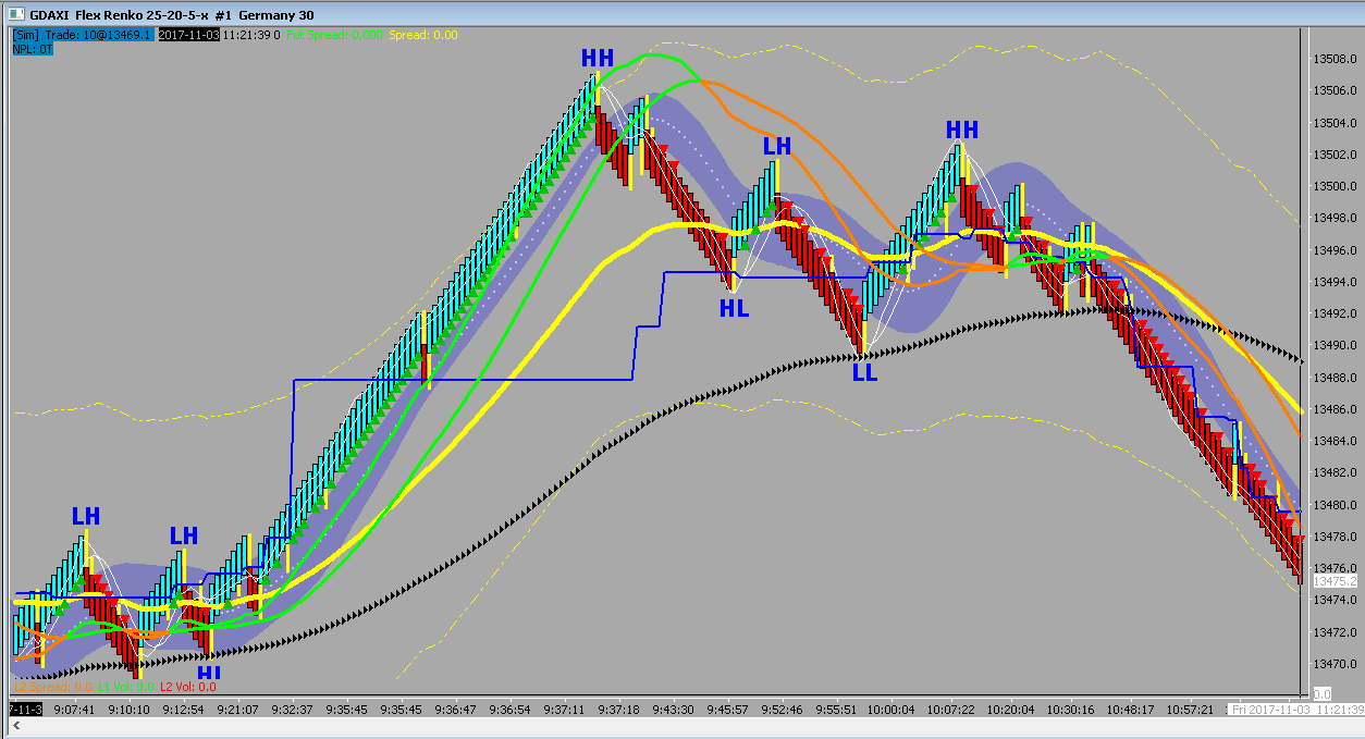

gomifromparis - Posts: 244
This chart is nowhere near of what I have had for years (please see pic).
I checked, my first Flex Renko chart was from april 2015, so these Flex Renko charts have worked for me exactly the same for 2.5 years, now for whatever reason you made a modification on the bar type and the charts look like crap, and if I want to keep the working bars I need to "stay on the previous version" ? So it's 1605 version for me, like... forever ?

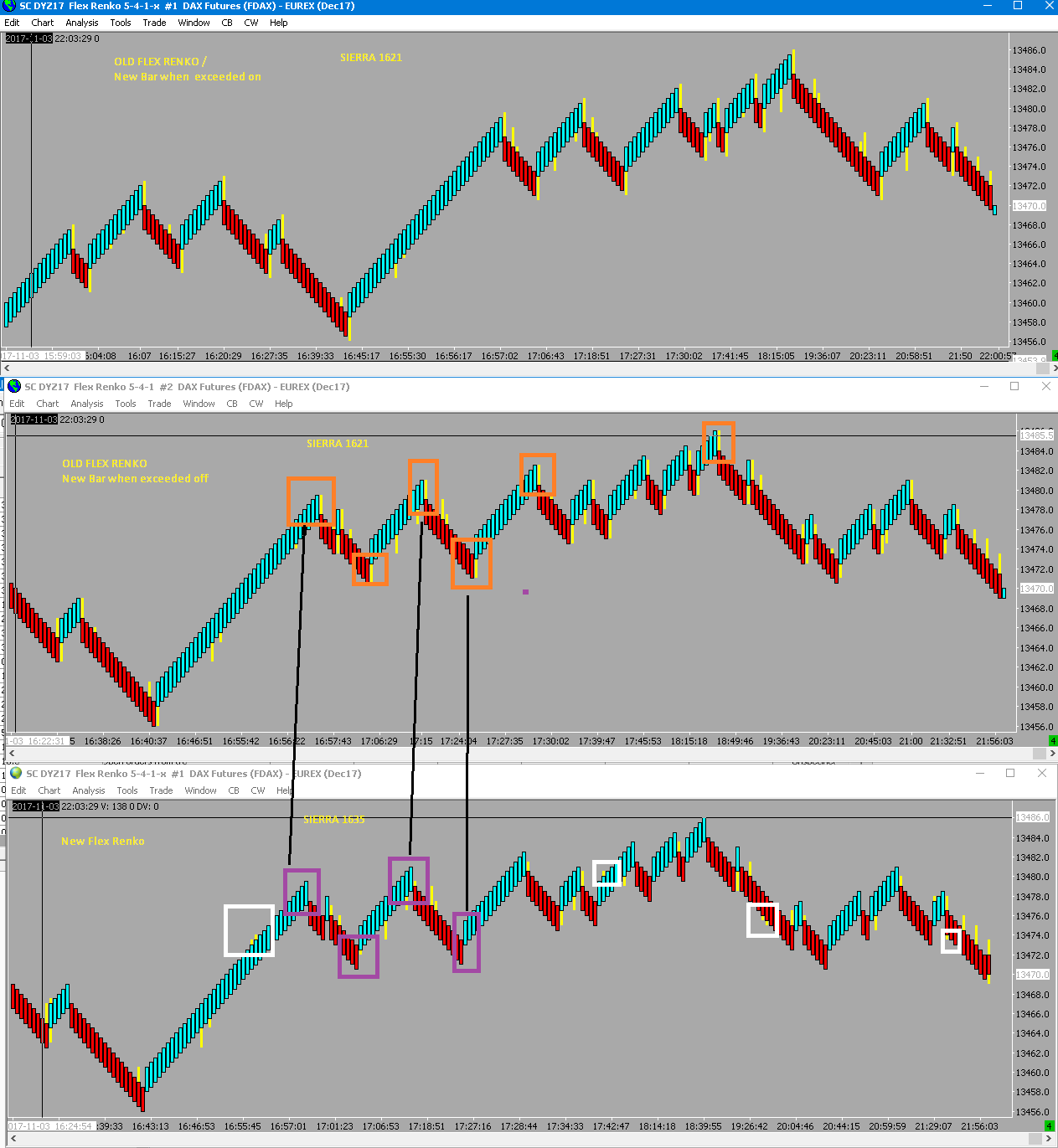

I made a new chart outlining differences between 1621/1635 versions, using DAX futures chart (GDAXI has half tick prices because its (bid+ask)/2 so it can have its own issues). So let's focus on the basic futures chart, tick size 0.5
It seems the new Flex Renko is almost like the old Flex Renko with "New Bar When Exceeded" disabled. I didn't see any way to reenable it.
However, even when comparing to the old version with "New Bar When Exceeded" disabled, there are still 2 modifications :
* Wicks on the wrong side of the candle (white rectangles). I think you corrected that in the last build (your chart on post #4)?
* Reversal wicks are not the same (see orange vs purple rectangles)
imagesierraflexrenko.png / V - Attached On 2017-11-04 15:29:38 UTC - Size: 103.99 KB - 742 views

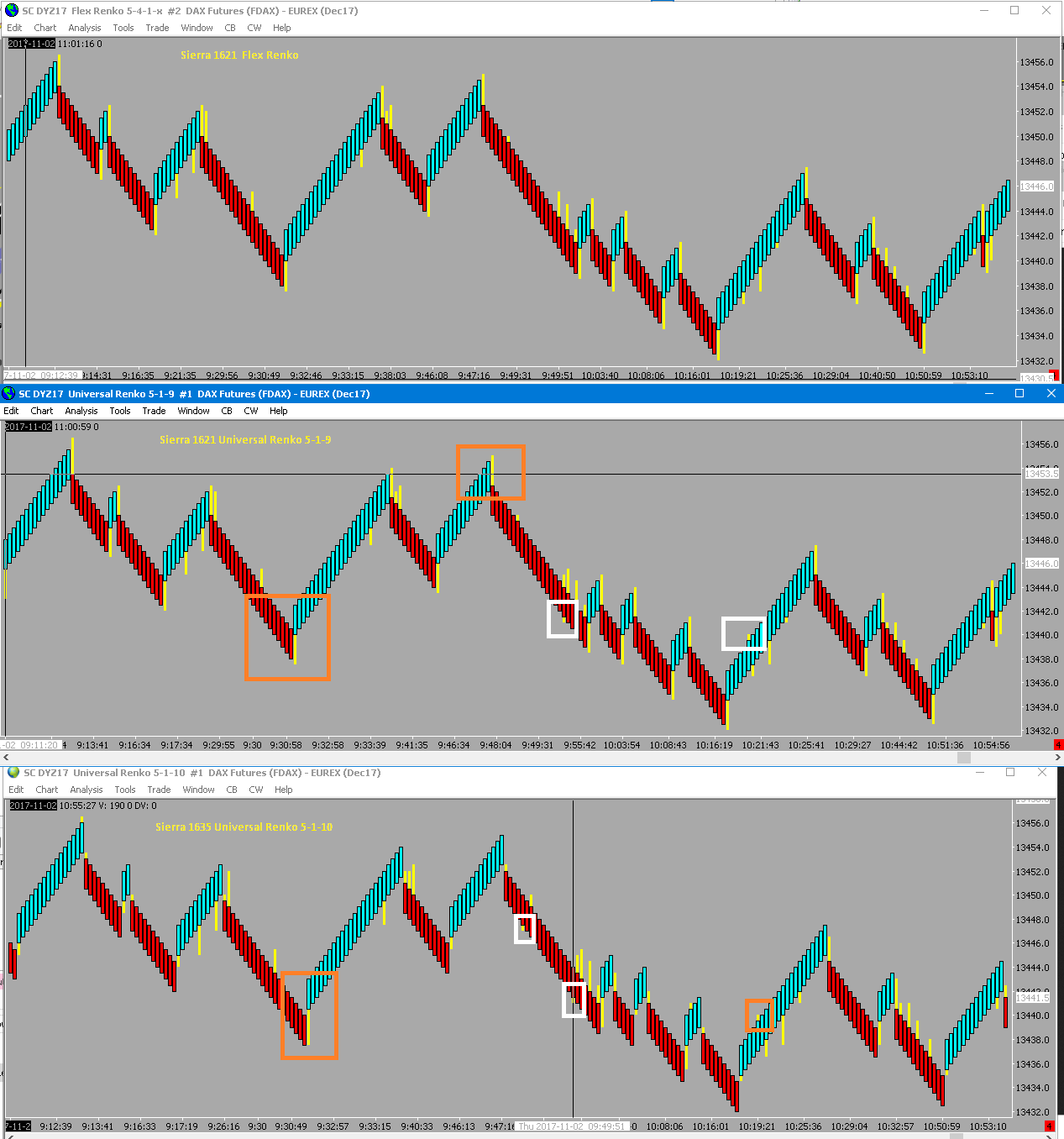

Here's a try with Universal Renko
1st chart : 1621 version with the reference 5-1-9-x Flex Renko chart (my actual reference chart is Ninjatrader Unirenko T1R9O4)
* All reversal look the same (reversal bar has a wick)
* All wicks are on the same sides of the trend
2nd chart : 1621 version with 5-1-9 Universal renko
* All reversal bars look the same (orange squares)
* There are some wicks on the "wrong" side of the trend (white squares)
3rd chart : 1635 version with 5-1-10 Universal Renko (5-1-9 looks different)
* Reversals bars are all different : some have wicks, in different positions, some don't.
* Like in 1621, wicks on the "wrong" side of the trend.
So with the current 1635 , there is no way I can have a chart with
* Candle up/down structure the same as 1621 Flex Renko 5-1-9-x/ Universal Renko 5-1-9
* No wicks on the "wrong" side of the trend
* All reversal candles with the same look (full reversal candle with a big wick)
Date Time Of Last Edit: 2017-11-04 17:02:46

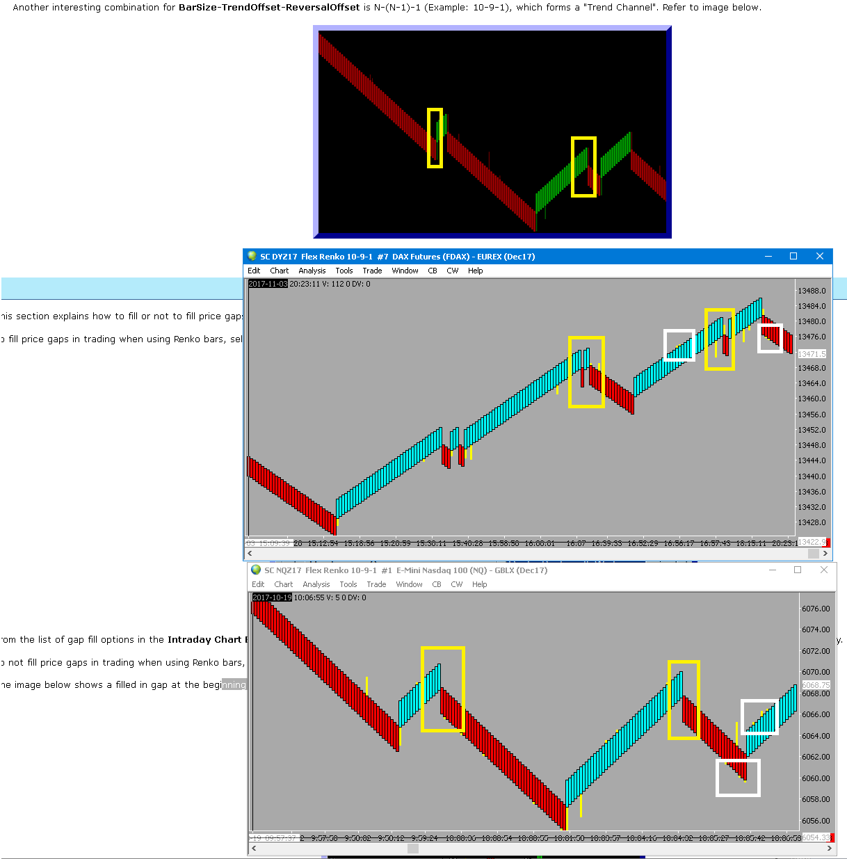

I tried to reproduce the chart you posted on the documention using a N - N-1 - 1 ( 10-9-1) Flex Renko chart.
The current implementation does not show the same bars as the documentation.
The posted pic on the doc site has
*full candle reversal wicks (yellow rectangles)
*no wick on the wrong side of trend.
The actual charts on NQ and DAX have
*no full candle reversal wicks (yellow rectangles)
*wicks on wrong side of the trend (white rectangles)
By the way, because of the name, shouldn't we be expecting to be able to build Ninja-like "UniRenko" bars with something you called "Universal Renko". If not, that name is quite misleading... There were plenty other names available.
imagedocchart.png / V - Attached On 2017-11-05 10:39:05 UTC - Size: 77.29 KB - 703 views

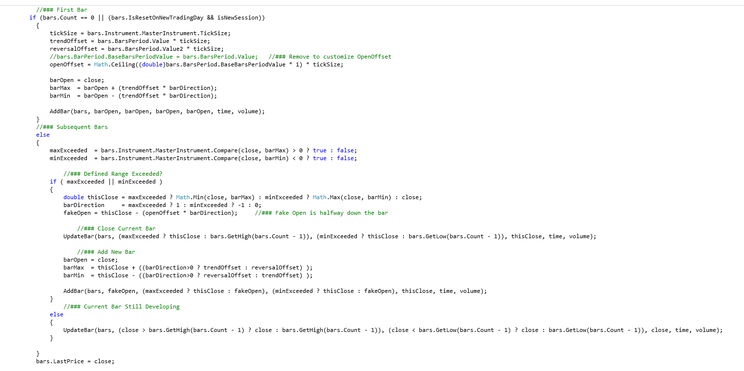

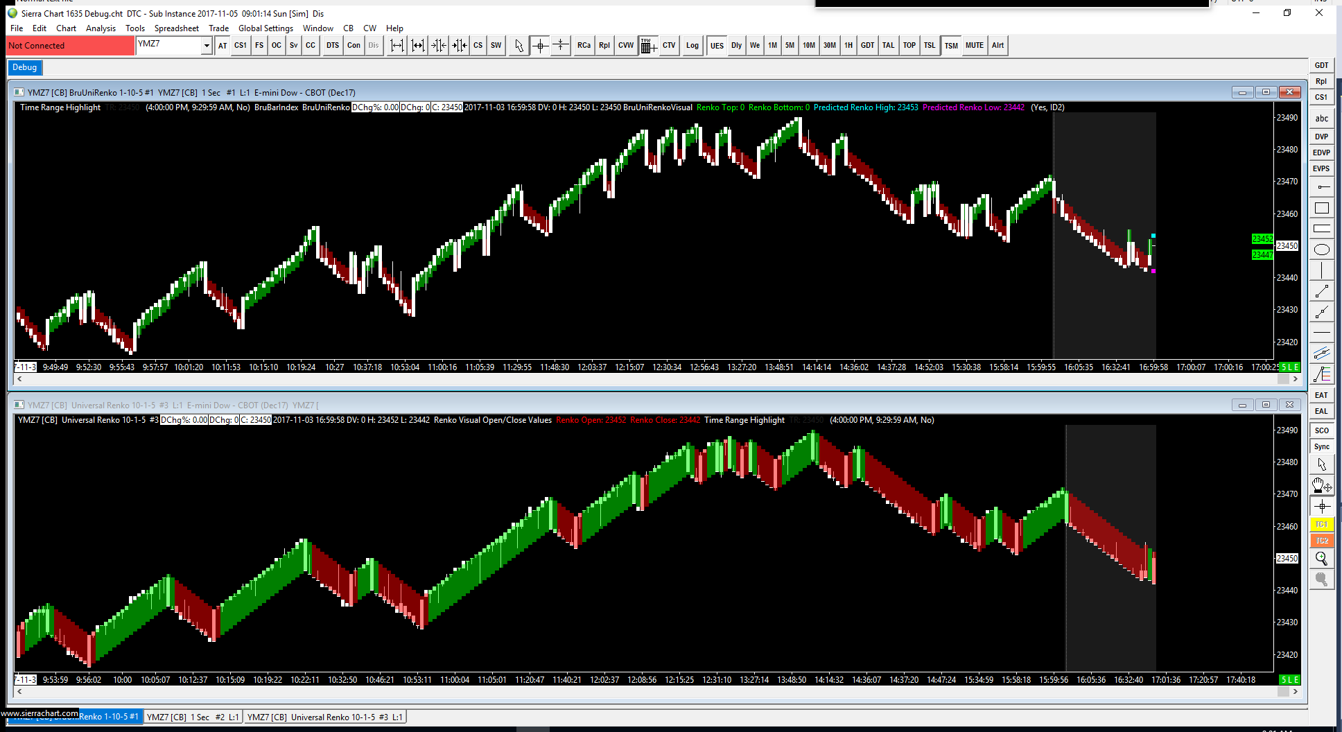

For what it's worth, I've written a uniRenko custom chart that is close, I think, to the Ninja Trader one. It's a kludge of two studies in combination, but it does what I need it to do, for now.
One difference is that is that it creates no fake bars (yet), so it is backtestable.
Another difference is that it doesn't (yet) used "exceeded" to create new bars, which will affect your input parameters.
http://www.sierrachart.com/image.php?Image=1509890474785.png
The code is in a public GitHub repository at https://github.com/dalebrubaker/BruSierraChart
There is a sample chartbook in the repository that shows how these studies work together. The visual study one points at the custom chart study.
No promises. Good luck.

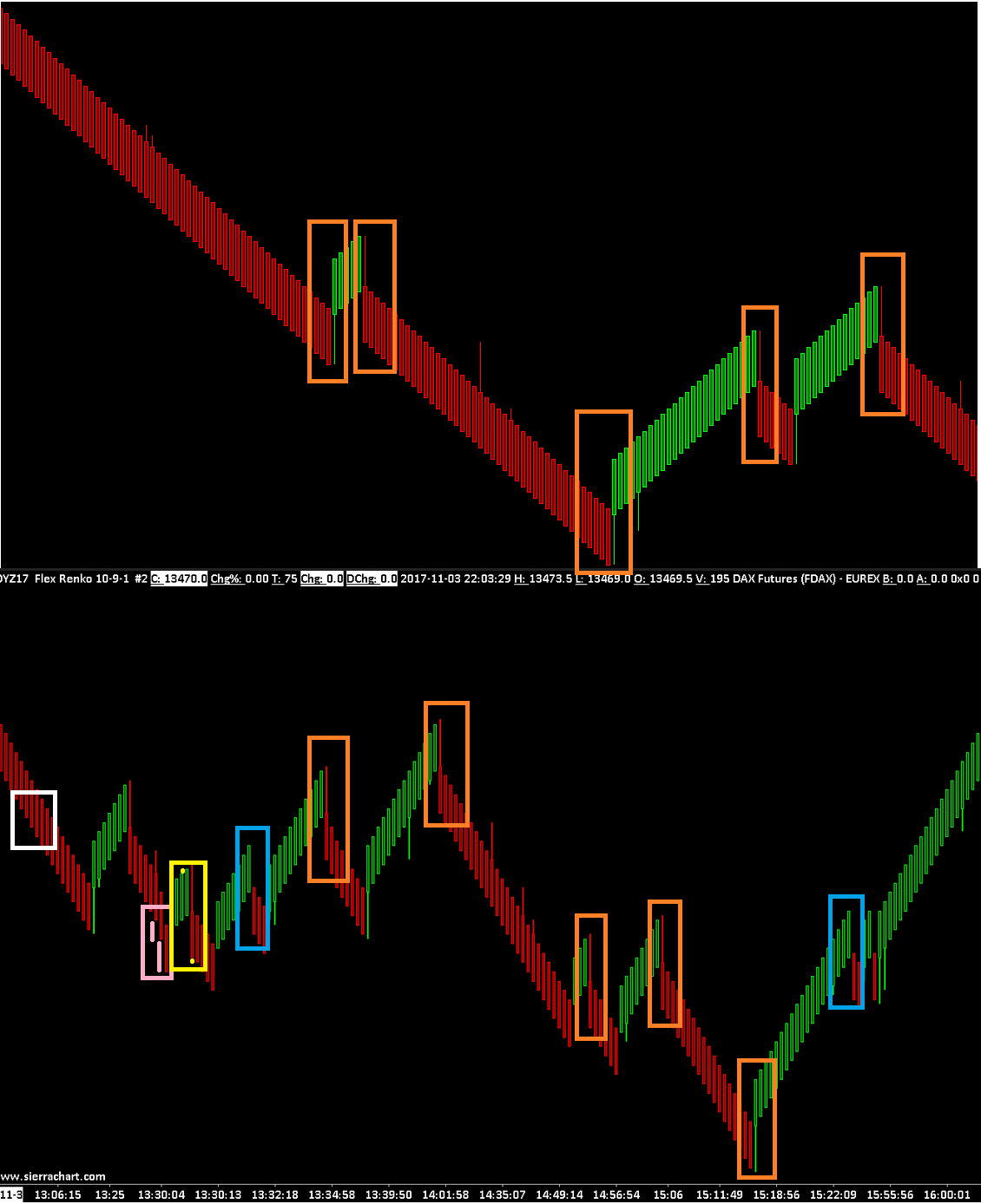

I had a look at your chart. It still doesn't look like what you have on your documentation web site.
On the documentation chart, all reversal bars look exactly the same. (orange rectangles : 1 full wick reversal bar). Nice chart.
On your new chart, the reversal are sometimes like the previous ones (orange rectangles), sometimes not (blue rectangles). Why this change ?
Moreover, it seems that most consective bars are 1 tick apart, but some are 2 or 3 ticks apart(pink rectangle), and some 0.5 tick apart(yellow rectangle)

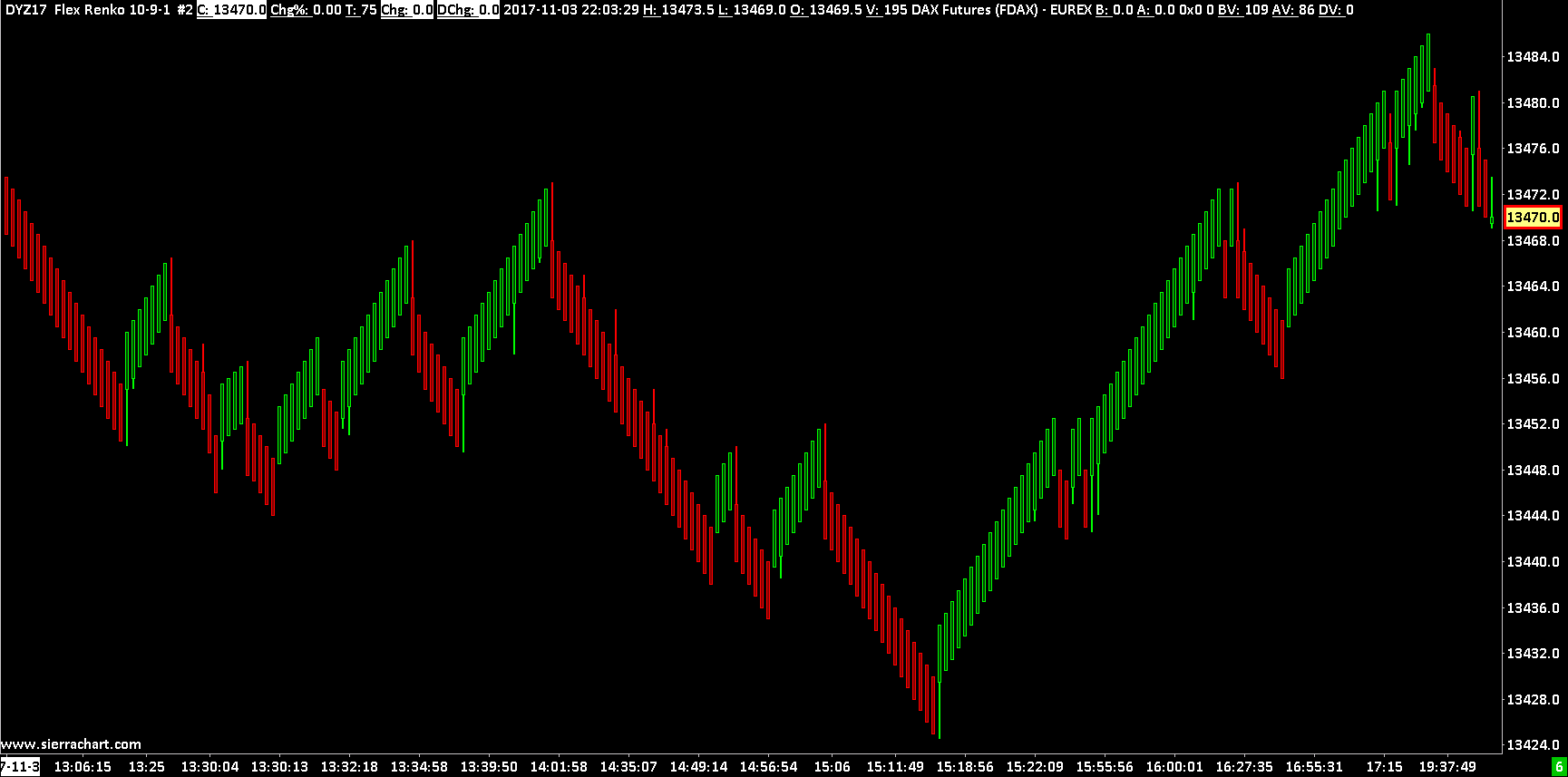

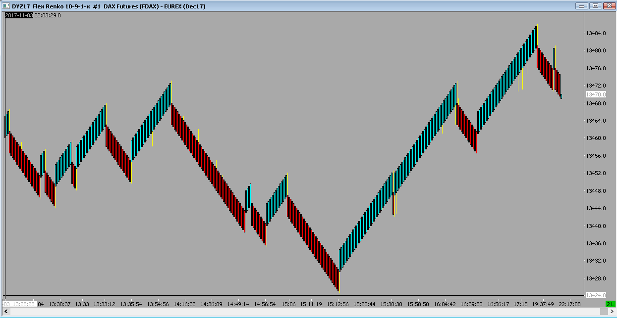

If we are to focus on the 10-9-1 settings, I'm attaching the 1621 10-9-1-x chart. This is what I would expect to be able to reproduce in the recent "new renko" builds.
imageflexrenkonew.png / V - Attached On 2017-11-05 17:57:39 UTC - Size: 76.85 KB - 843 views
imageflexrenkoold.png / V - Attached On 2017-11-05 17:58:50 UTC - Size: 36.1 KB - 680 views

This is what was awesome with the old Flex Renko with 'New bar when exceeded'
imagescvsntrenko.png / V - Attached On 2017-11-05 21:03:45 UTC - Size: 44.89 KB - 636 views
[2017-11-06 03:56:01]
We will write up documentation responses as well but here are the responses.
First we should have no trouble to get what you ultimately want through options which will make the new Renko bars provide the greatest flexibility.
This part of the documentation explains some of this:
However, in the case of a completed Renko bar, when it is an Up Renko bar, once the price moves below the lower Open price, a new bar begins because a reversal potentially can occur. But this new bar has no known direction until it is established. In the case of a Down Renko bar, once the price moves above the higher Open price, a new bar begins. The reason for this behavior is to support the use of the Numbers Bars study on Renko bars so that the chart bar where the reversal occurs, contains the volume at price data for all of the levels of the reversal bar. Otherwise, this would not happen.
Taking that functionality out, this is what we see:
http://www.sierrachart.com/image.php?Image=1509939583695.png
We will add an option to for that. We also need to add an option, which will start a new Renko bar when the new bar range has been met and not exceeded. We have added this to the code now and this is what we see:
http://www.sierrachart.com/image.php?Image=1509940478496.png
The images you are looking at in the documentation are still old. And not updated.
This is handled just by filling the gaps using one of the options here:
The chart images provided in this post, do use Fill All Bar Gaps.
At this point just wait for the new options. So as you can see, with the addition of just simply single-line if statements, we can modify the behavior easily. The new code is very well structured.
The fact is that you did a massive functional change here with no warning,
Finally this really is not a fair statement. To say there is a massive functional change, is completely inconsistent with actual fact. Some change yes, and we can see now that some of the change, were subtle details that we were not aware of. The Renko related development has already been announced on the What is New webpage:
https://www.sierrachart.com/index.php?page=doc/Whats_New.php
Also when you see the interface for how to build chart bars, which is still not done, we need about another two days on this, you will see just how easy it is.
Date Time Of Last Edit: 2017-11-06 04:06:33
[2017-11-06 06:49:33]
user8888 - Posts: 159
Why could it be that my chart looks quite different than the one in post #22? the wicks in the turns aren't there. different data feed?
Thank you!
imageflexrenko1636.PNG / V - Attached On 2017-11-06 06:47:52 UTC - Size: 44.44 KB - 560 views
[2017-11-06 07:42:32]
@sctr4d3rIt's because you are using post 1621 sierra where the Renko bar handling has been rewritten and modified.
@sierra : nice, it looks like we'll be able to get the previous functionality back. Can't wait for the new version !
