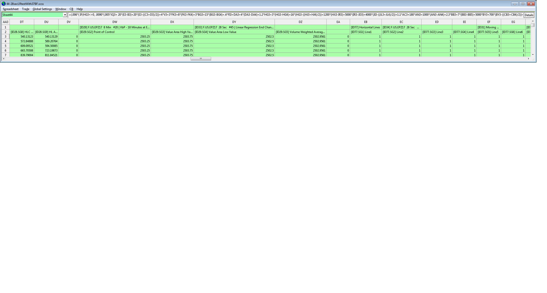

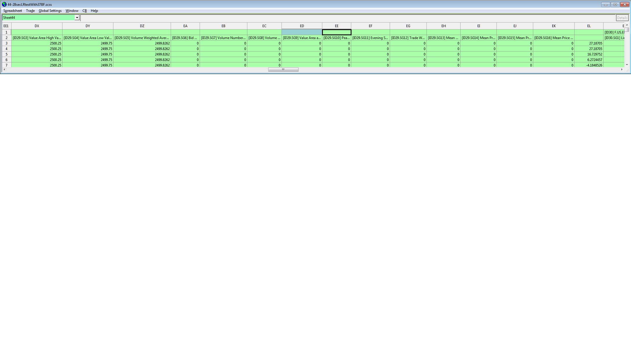

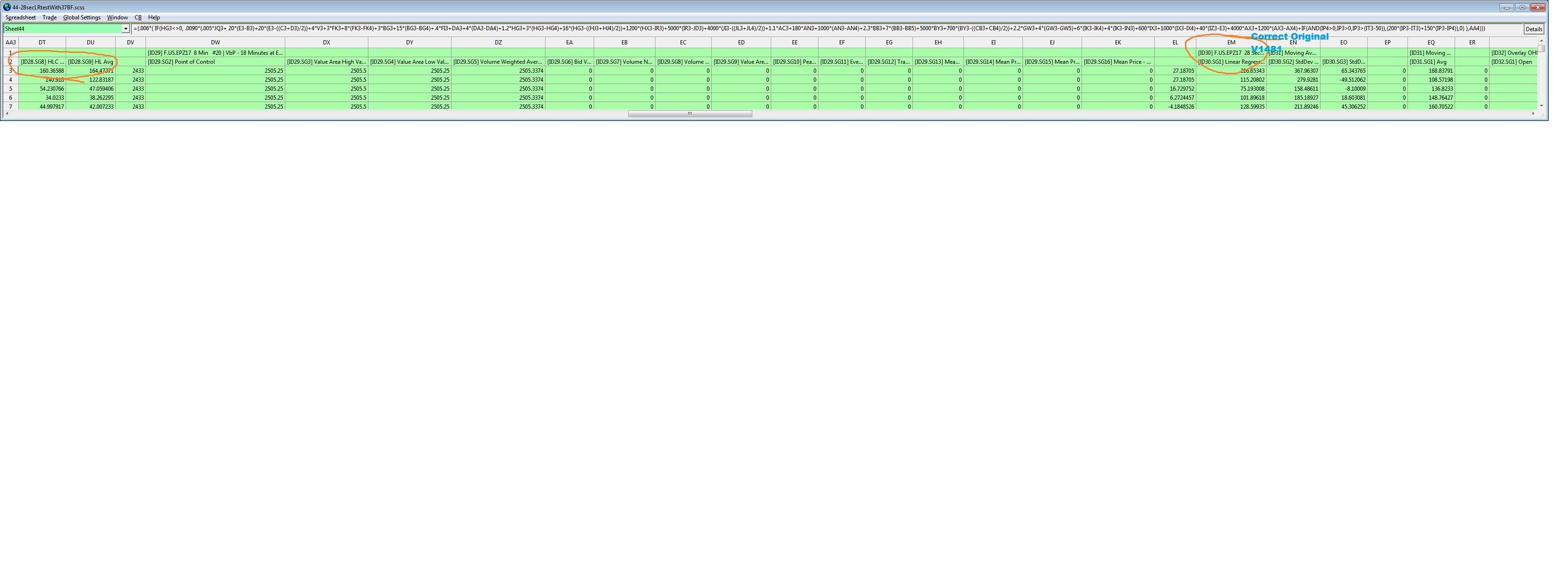

Here're pictures, each Version, spreadsheets, Study ID29 VbP (neither has 3 cols.)
(The V1615 new-created temporary test spreadsheet in Source chart for target-ID29 did have 3 cols.)
V1481 showing 16 columns
vs
1615 shows 4 columns same ID29 study
I don't need any of the extra columns generated by V1481
Suggested General Fix: VbP Option for Number Cols. to Output to Spreadsheet
or
a general handy "Correct-Add Fill Columns" study to adjust-fix Spreadsht columns (can add at end and move up Study list to where needed) (<-- but not add a blank column before added filler columns)
CORRECTION: The Spreadsheet with 16 col's VbP study overlay was first-created by Version 1453 or prior.
Date Time Of Last Edit: 2017-09-26 00:17:11
imageV1481Chart44-VbPoutputs16Cols.jpg / V - Attached On 2017-09-25 19:01:49 UTC - Size: 209.36 KB - 549 views
imageV1615Chart44-VbPoutputs4Cols-StudyID29.jpg / V - Attached On 2017-09-25 19:02:10 UTC - Size: 217.72 KB - 551 views

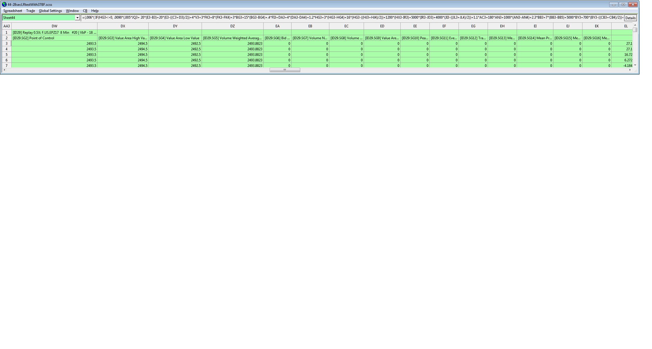

I'll study your suggestions. Without my sequence of versions/spreadsheet creations/VbP overlays, from V1450, V1454, V1481, you can't reproduce what happened. But I can show you.
In re your "We want to understand why there are 4", here's a pic of a new test spreadsheet created by V1615 source chart #20:
V1615 creates 3 cols.--what you said/ expect. Creation-not overlay, is consistent, 3 cols after V1454.
V1454 or prior created the 4-column VbP and the 15-col. (not 16) VbP
(the prior #44 spreadsheet pic cut off SG2, SC not running, trailing 11 col's had 0 - no data)
I ran a V1481 Replay to see if #44 Sheet would ever fill data into trailing 11 VbP columns (4+11=15) when running:
NO, did not,
only 4 columns had data updating in the overlay- from the source VbP 4 columns created by V1454 or prior.
Here is a better pic, 15 cols of V1450-81 target #44 overlay from source #20, SC running.
For a new sheet, V1481 creates 3 columns for VbP, like V1615 (not overlay).
The only issue is "consistent overlay prior column count fidelity" from old source study overlays with inconsistent col's.
or: How to fill 11 additional columns that were in the old spreadsheet that V1615 overlay now drops.
V1615 overlay probably keeps 4 of old 15 cols because 4 have data and trailing 11 SG6-SG16 have 0's.
Does "[reproduce] however many columns there may be in a VbP?
The answer to the question is yes"
mean you'll try to make overlays look for spreadsht columns by prior spreadsheet headings, not just by data other than 0-zeros?
Before building/changing a spreadsheet, the overlay should look to see how many headings were in the old spreadsheet,
(preserve column count with fidelity), regardless whether any data is in columns.
EDITED: Meanwhile, Trying Workarounds: I tried "Horizontal Lines" as a columns filler; Almost works.
(Your old solutions don't seem to fit).
40 lines in the sub-headings makes the spreadsheet look screwy, though.
Could you add a "Number of Lines" option? (now a set #, 40) Or a similar study with 10 lines?
LATEST:

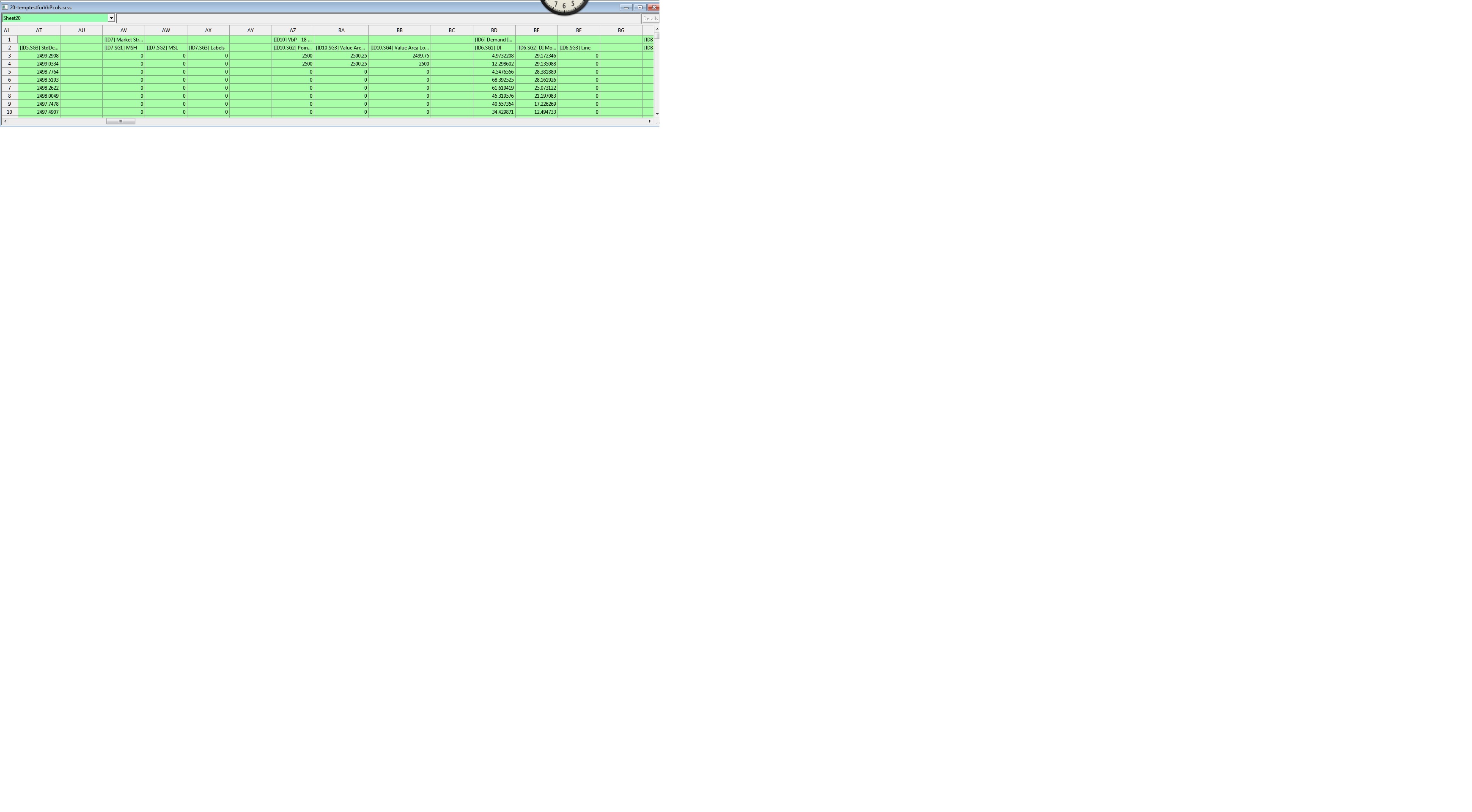

The V1615 overlay apparently completely lost ID30 Study. Last Pic added shows it gone, other studies now out of sequence
Pic V1615Chart44-VbPoutputs4Cols-StudyID29-2-HorLines-Study30Missing
Date Time Of Last Edit: 2017-09-28 16:03:42
image20-testtempVbP-V1615.jpg / V - Attached On 2017-09-27 16:57:58 UTC - Size: 249.81 KB - 497 views
imageV1481Chart44-VbPoutputs16Cols-2-SimRunning.jpg / V - Attached On 2017-09-27 16:58:15 UTC - Size: 240.29 KB - 515 views
imageV1615Chart44-VbPoutputs4Cols-StudyID29-2-HorLines-Study30Mis.jpg / V - Attached On 2017-09-28 16:03:24 UTC - Size: 249.29 KB - 518 views

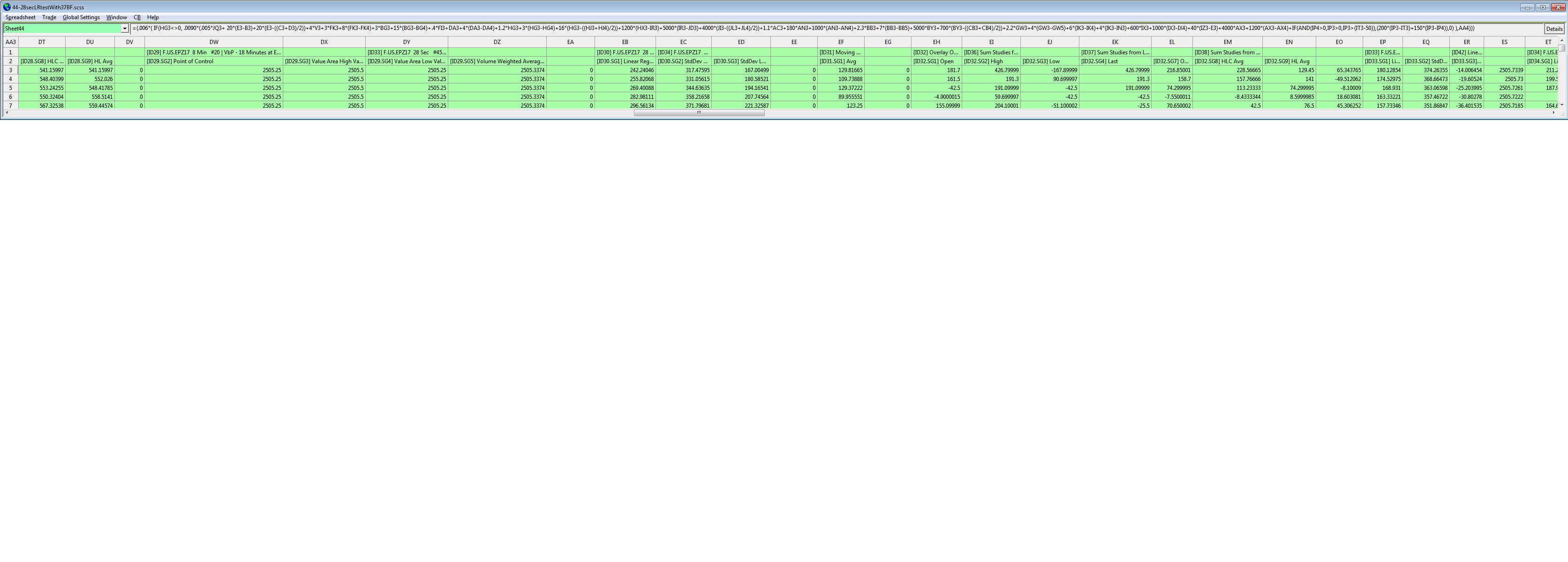

The Horizontal Lines Study for Filler caused the Mess seen in the last-above pic.
I started over: before & after upgrade nothing else, but a wider view of #44 Spreadsheet.
See wider view pics here.
All studies are there, just shifted by the 11 missing columns, as explained to you.
Just stop the sheet builder from replacing the old Spreadsheet if column counts don't match prior.
imageV1481Chart44-VbPoutputs16Cols-WideView-withID30.jpg / V - Attached On 2017-09-28 17:06:59 UTC - Size: 386.37 KB - 656 views
imageV1615Chart44-VbPoutputs4Cols-WideView-withID30showing-but-di.jpg / V - Attached On 2017-09-28 17:07:19 UTC - Size: 416.82 KB - 529 views

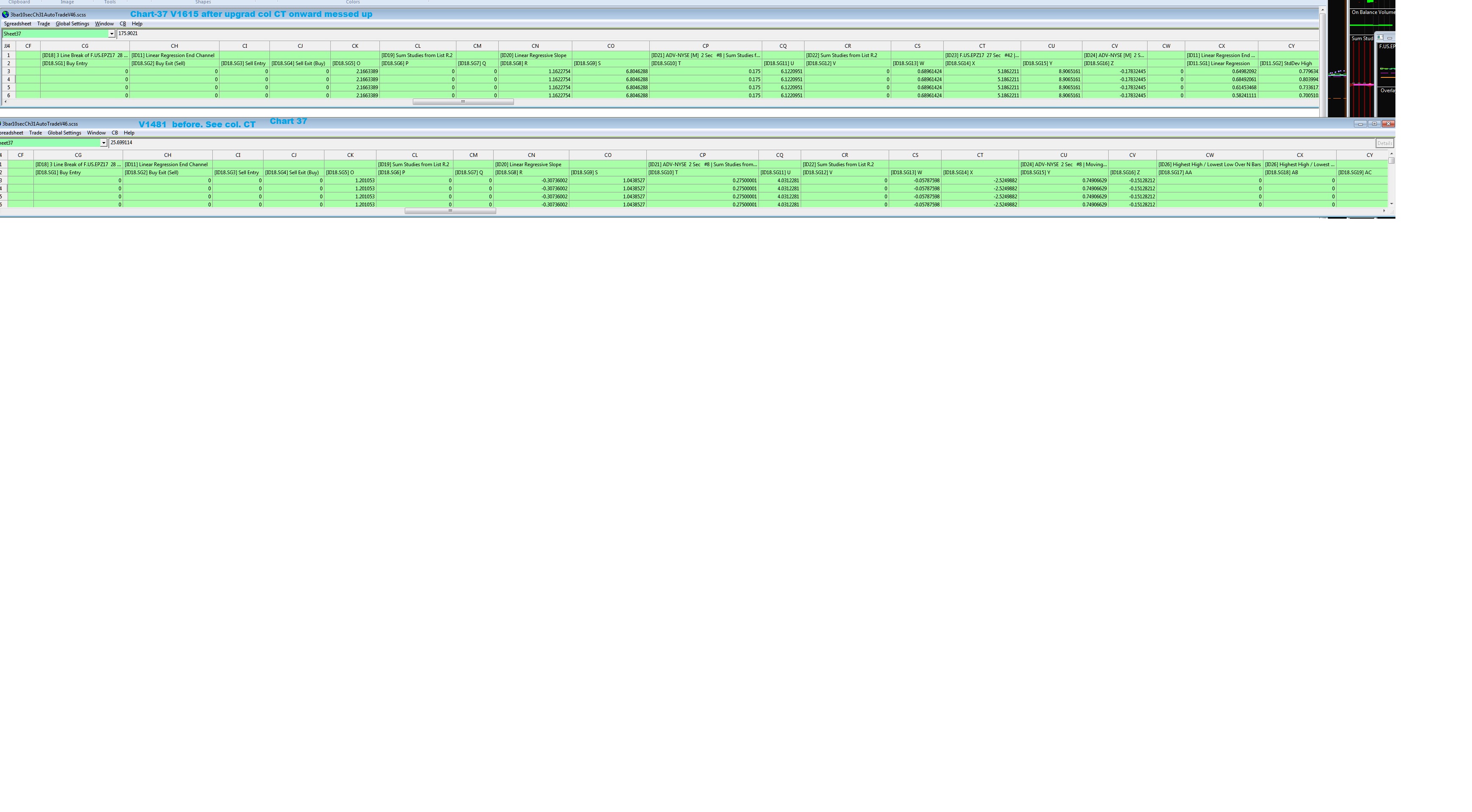

My Chart 37 Spreadsheet also messed up by V1615
Pic of before vs after, errors missing and shifted after col CS.
System needs to keep old spreadsheets. Your nice Sequence ordering in Study List has done something.
imageChart37-Spreadsheet-Before-After-Upgrade-1481to1614-colCT-on.jpg / V - Attached On 2017-09-28 19:47:06 UTC - Size: 605.67 KB - 620 views

User931283 - Posts: 55
V1481 Sheets w/ sheet overlay #31 to #37 Worked Great
V1617 Ruins #37 Sheet.
EDITED: Here's an Excel Spreadsheet of both, aligned to compare the V1481 Ch#37 Spreadsheet 37, to V1617
Looks like V1481 includes all Sheet31 Overlay Columns
but V1617 puts out only col's with data?
Otherwise columns both resume with ID11 after ID18. That's the problem- the shifted columns.
Date Time Of Last Edit: 2017-10-01 23:14:32
