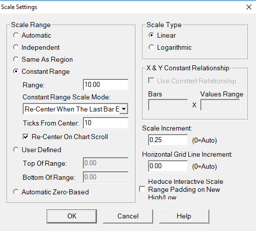

I have scaling on three windows set to attached pic on one minute chart on NQ. The first window works fine. When I put the scaling on the other two windows, they started the scale at zero and for the last 10 minutes they have been working there way up to 6000 price level.
image918.PNG / V - Attached On 2017-09-18 19:12:52 UTC - Size: 21.01 KB - 562 views

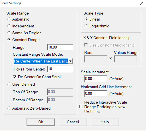

[2017-09-28 14:22:45]
User99934 - Posts: 227
When I have a number bar chart and set scaling to attached pic from automatic, the scaling starts from 0 and slowly scrolls back to price and takes half an hour, even when following instructions Chart Scale and Scale Adjusting: Resetting the Scale
Date Time Of Last Edit: 2017-09-28 14:23:15
image928.PNG / V - Attached On 2017-09-28 14:20:54 UTC - Size: 20.92 KB - 507 views

[2017-09-28 20:55:20]
"Make sure you set this Scale through the Chart Settings when using the Numbers Bars study. Refer to:
Chart Scale and Scale Adjusting: Opening the Scale Settings Window for the Main Price Graph" - did this.
If you open the attached chart there will be no problem. However, if you open another window with a basic bar chart and then add a basic number bar study to it with the scaling parameters I have in first chart, you will see scaling problem - a scrolling scaling adjustment that will take 30 minutes to adjust.
Date Time Of Last Edit: 2017-09-28 20:56:15

[2017-09-29 01:46:17]
A chart image would have been enough. The problem is we did not set the Constant Range Scale Mode correctly when testing.
There apparently is not an initialization of one of the variables when setting a Constant Range Scale through the Scale Window directly. If you right-click on the Values Scale and set it to Constant Range and then after change the Constant Range Scale Mode to what you are using, you would not have the issue.
Anyway, we will determine a solution.
Date Time Of Last Edit: 2017-09-29 01:46:51
