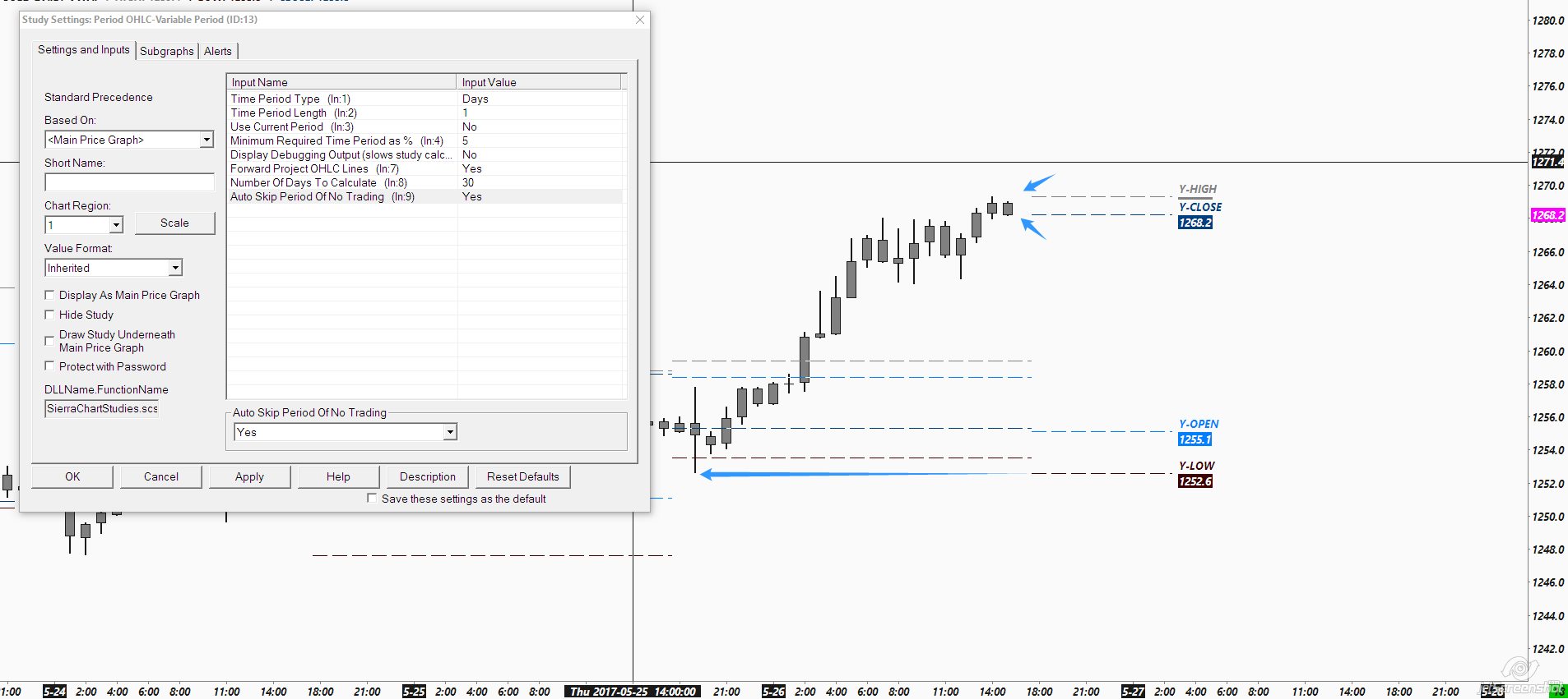

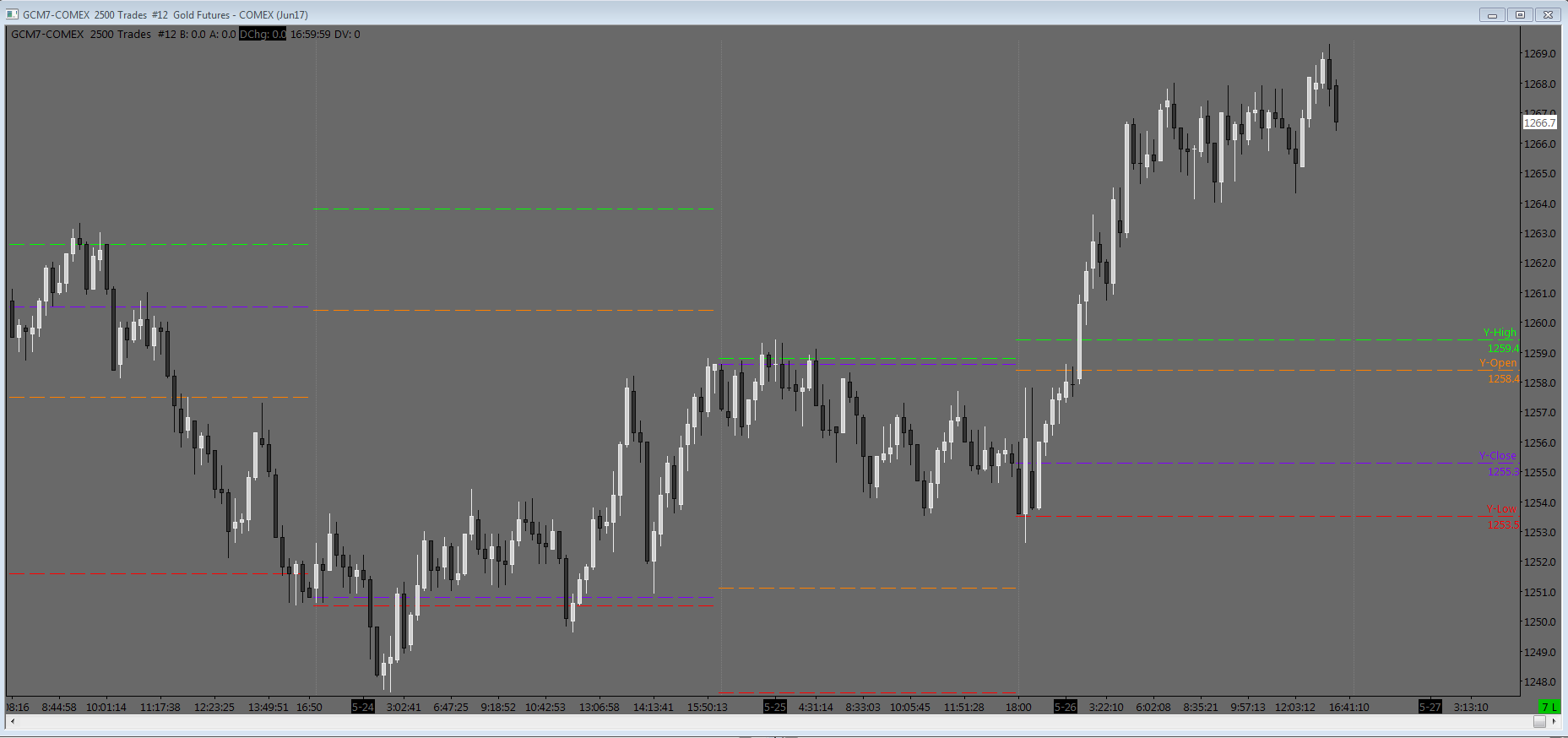

here is gold 2500 chart , im trying to plot yesterdays OHLC which its plotting , but also plotting the OHLC of today with labels , this is the problem as its cutting the OHLC at last bar for some reason my start time is 1800 to 1700

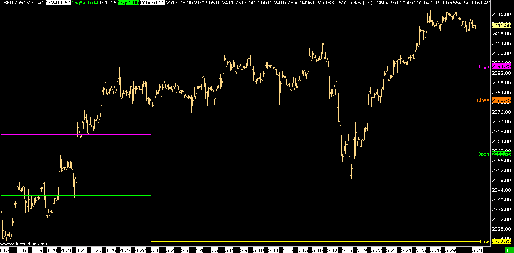

then here is same chart with same settings on ES and look how its plotting yesterdays OHLC perfect , so my question is whats going on that there changing or different some days and other days there fine
image2017-05-26_15-21.jpg / V - Attached On 2017-05-26 19:22:06 UTC - Size: 145.56 KB - 483 views

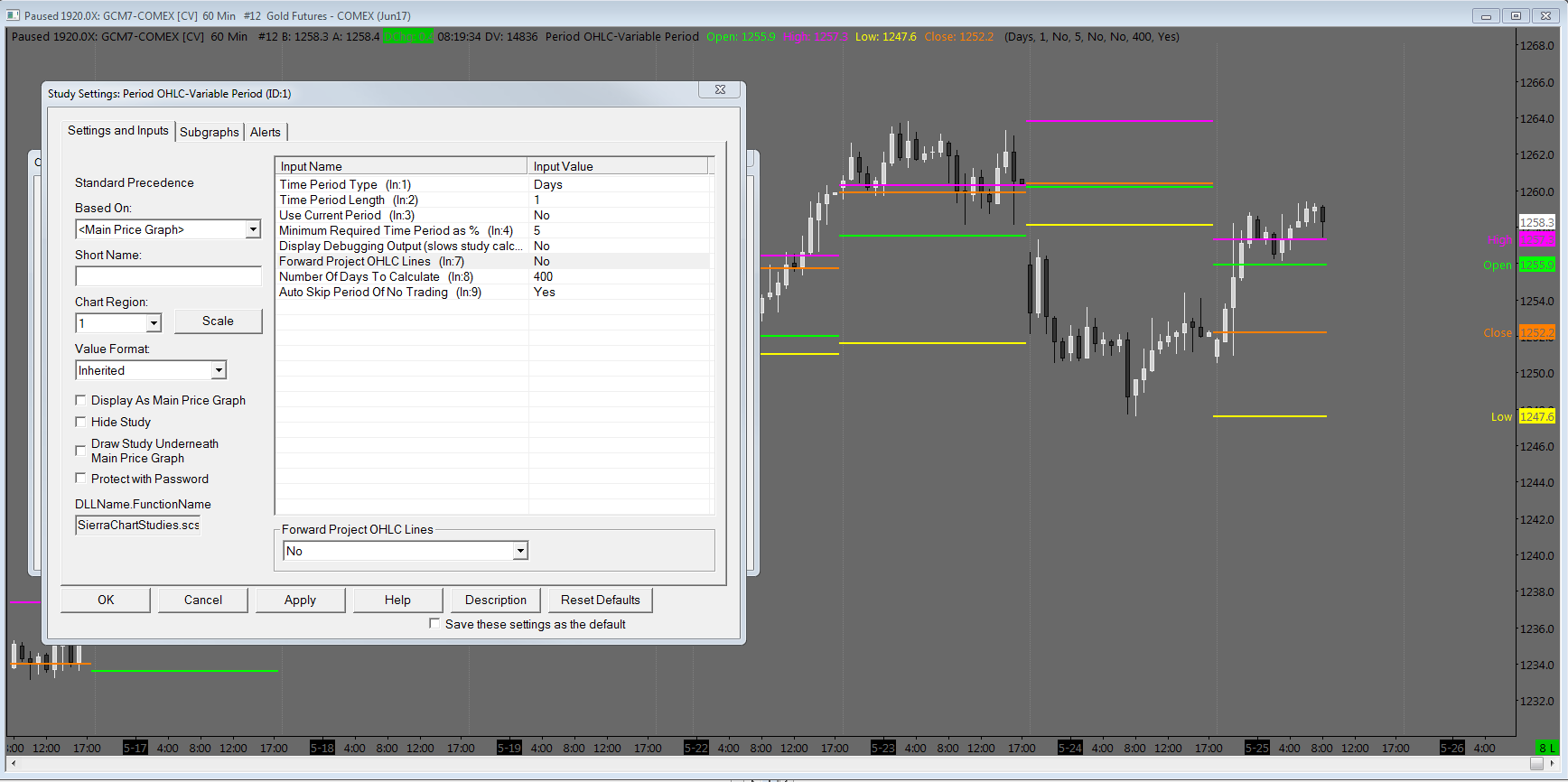

The problem you are having seems to be created by the "Forward Projecting" of the OHLC lines. From what I can see, and you can verify this by watching this study in replay, is that the OHLC lines can only be a maximum length which corresponds to the length of the session. So when you forward project the lines, that "forward projection line length" is added to the length of the forming OHLC line (included as part of the session and not over and above) and once it reaches it's maximum length (session length), even though the session hasn't closed, it changes value to the next session which is today's session from yesterday's. The only way you can get round this is if you don't use forward projection or if SC includes an option for which session it is applied to. You can see what is taking place in the two attached images:
imageOHLC1.PNG / V - Attached On 2017-05-27 07:56:27 UTC - Size: 88.83 KB - 502 views
imageOHLC2.PNG / V - Attached On 2017-05-27 07:56:41 UTC - Size: 93.93 KB - 530 views

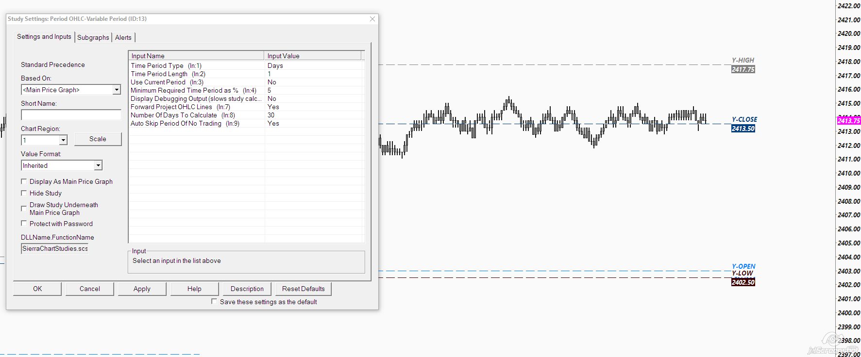

This is what it should look like:
Date Time Of Last Edit: 2017-05-28 08:28:49
imageOHLC3.PNG / V - Attached On 2017-05-28 08:28:41 UTC - Size: 64.49 KB - 510 views
