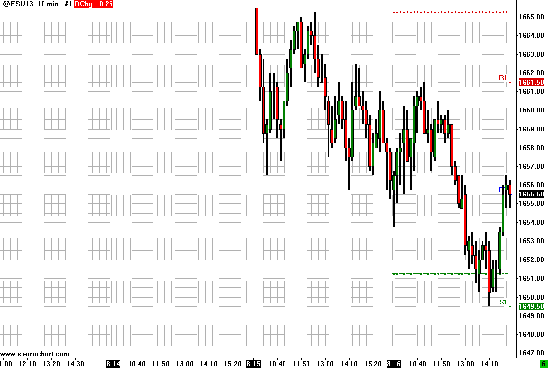

Chart image requested Not sure if this is correct, could not find a clipboard in Win XP
http://www.sierrachart.com/image.php?l=1376680668991.png

Dennis B. - Posts: 303
Well it worked, funny, the pivot point study is fine till about 1 est then gets weird.
[2013-08-16 19:40:11]
One other thing..the "new pivot point" goes up and or down with each change in price.

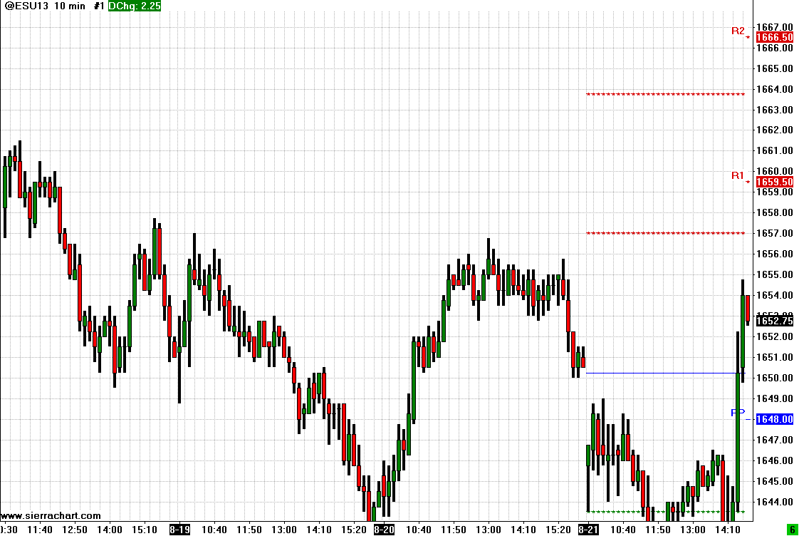

http://www.sierrachart.com/image.php?l=1377111180272.png
Chart as requested, getting you my chartbook, just too hard for me..sorry. At this point I know a quick work -around so can live with it.
http://www.sierrachart.com/image.php?l=1377177494662.png
Clearer picture of problem.
