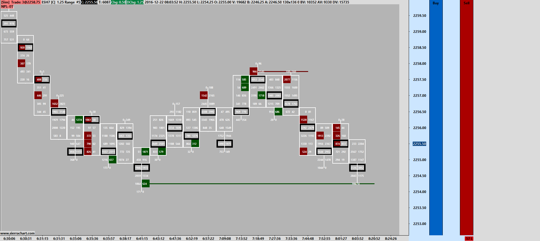

[2016-12-29 04:46:05]
User104854 - Posts: 460
I understand what you're saying. Technically it would be a line that is between the bid and ask prices. I would just like to have the lines and the colors on my numbers bars match up like the attached image link. Is this doable? Or maybe do it in between the bid and ask. I suppose if the bid was 2254.50 and the ask was 2254.75 then the line would be at 2254.625 right? Thanks for your help.
http://www.sierrachart.com/image.php?Image=1482986362374.png

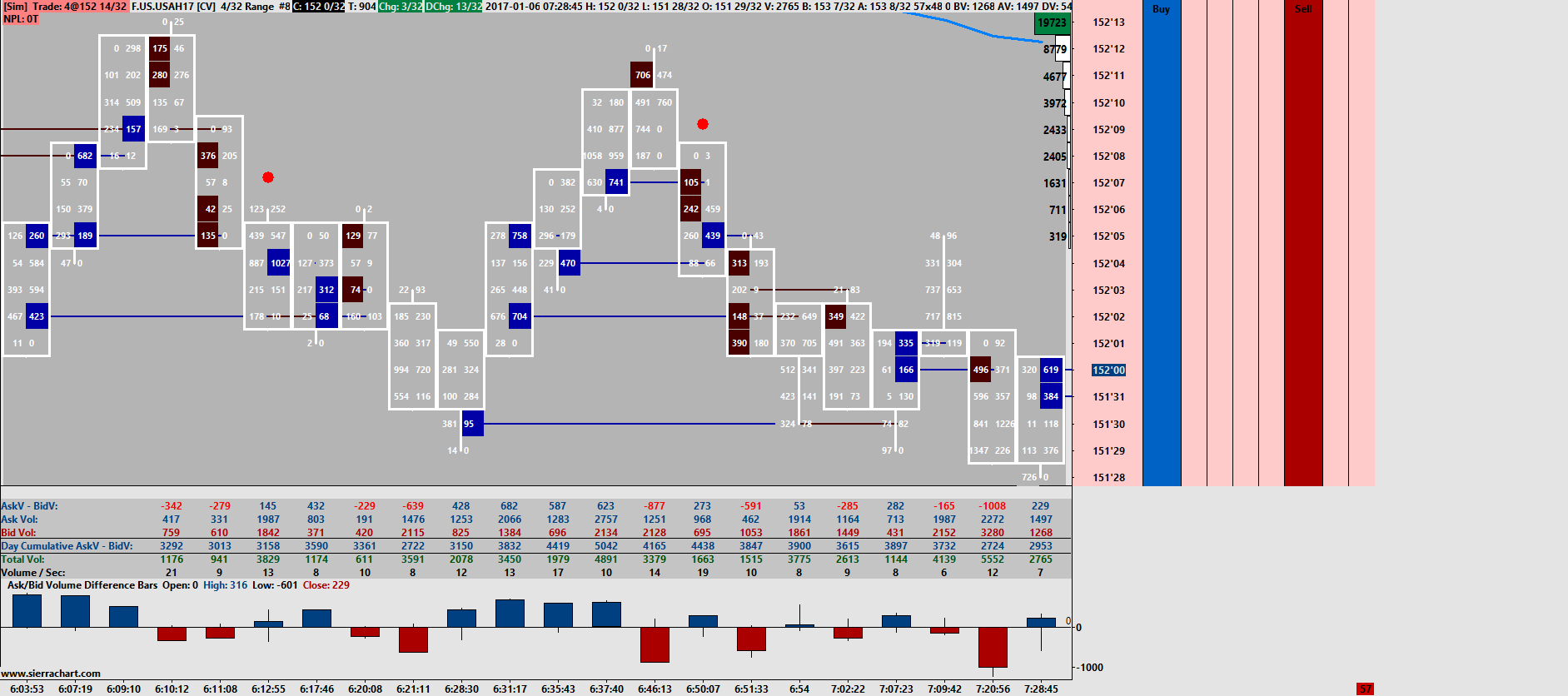

I sent the last response after I did the ask lines but I am having trouble with the bid lines. You'll see in the image that every single ask line matches the numbers bars and is extended. My settings for this threshold in both the numbers bars and the V2 indicator is 400% compared diagonally. For the ask lines my settings for the V2 indicator are as follows:
Comparison: Ask Vol Bid Vol Diagonal Diff
Volume Threshold: 0
Vol Alert: Disabled
Ext Lines: Yes
Bid Ask Comp Method: Percentage Diff
Percent Threshold: 400
This works great. I then made a duplicate of this and switched the color of the lines and made the Percent Threshold -400 for the bid lines. The lines aren't matching up at all. There's a big 706 vs 17 in the top middle that should definitely have a line. Is there a setting that I'm missing? It is comparing the bid price to the ask price above it yes? Please help. Thank you.
http://www.sierrachart.com/image.php?Image=1484186049356.png
[2017-01-12 02:25:27]
We see the problem. We will fix this.
[2017-01-12 16:13:08]
Thank you. Is there any way I can be notified once it's fixed?
