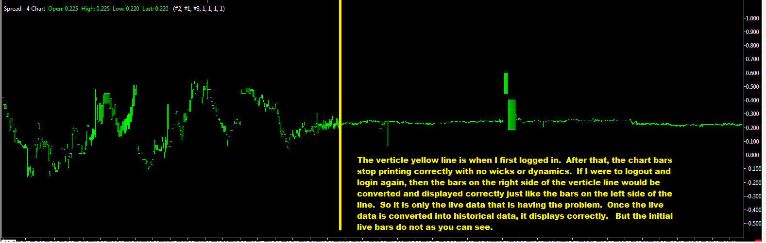

One additional note that may be helpful. The problem doesn't seem to be about creating custom spread symbols as you mentioned above. For example the Spread 4 Indicator seems to be fine the way it is set up for inputting various symbols. Instead, the problem is the way the actual chart functions and prints the data. Live data bars retrace and do not print the wicks of the bar so most of the bar's dynamic range is missing; making the bar incomplete. If you logout and log back in, those same bars will show the full dynamic range.
Thanks again. Any response is appreciated because I can't trade without this one issue being resolved.

The capability for customs symbols now exists. Can you just tell us the exact spread symbols and the overall formula and we will tell you the symbol to use and the necessary Symbol Settings. These customs symbols can only create chart data from the real-time data. There is no historical data created other than from what is recorded in real-time. So you need to keep Sierra Chart running.
In regards to the problem you describe in the post above, we do not know why you would have that issue but we would like to know what the timeframe of the bars in those charts is.
But all you need to do is just select Chart >> Recalculate if there is a problem with the study result.

I am trading a variety of commodity symbols using the Spread 4 indicator. The custom symbols capability really isn't the issue and doesn't apply here. My main problem is when using any type of Spread or Difference indicator, the historical and real time data are treated differently somehow. In answer to your question, I have used various bar times from 1 second up to 15 minutes and the same problem occurs regardless of the underlying time frame used. If you test out any of your Spread or Difference indicators, you will see for yourself how it reacts to incoming data (as my screenshot shows). Watch the current bar and how it will retrace and not print the entire price history. The entire bar will also disappear and reappear during price spikes.

What we would not expect and something we could never reproduce, is where when recalculate the chart, you are seeing a different result at historical bars created during real-time updating from a study like the Difference (Bar) study. So there must be something more complex that you are doing that we cannot see because you are providing an extremely narrow and hidden context of what you are doing. So in essence what you are showing us is next to useless.
In any case one thing came to mind about about studies referencing other charts like the Difference (Bar) study that we want to improve upon and we will do that but we do not think that is related to the core issue you are having.

Sorry if my example seem narrow, but I provided a simple screenshot just to give you an idea of what I am seeing. But what I am doing is very straightforward. I open an new chartbook, I add four charts with different symbols and I use the Spread 4 Indicator to create a spread from those four charts. The resulting output is what you saw in my screenshot. That's as strait forward as it gets. The only additional thing I can think of that I'm doing is I added the BAAVG suffix to the end of each symbol. But I have this issue with or without the BAAVG suffix.
When you say "this is expected when using a study like the Difference (Bar) study and is documented." Can you explain what you mean by that and show me where I can read more documentation about why this is happening? Are you saying it is normal for the current bar to retrace like that?
