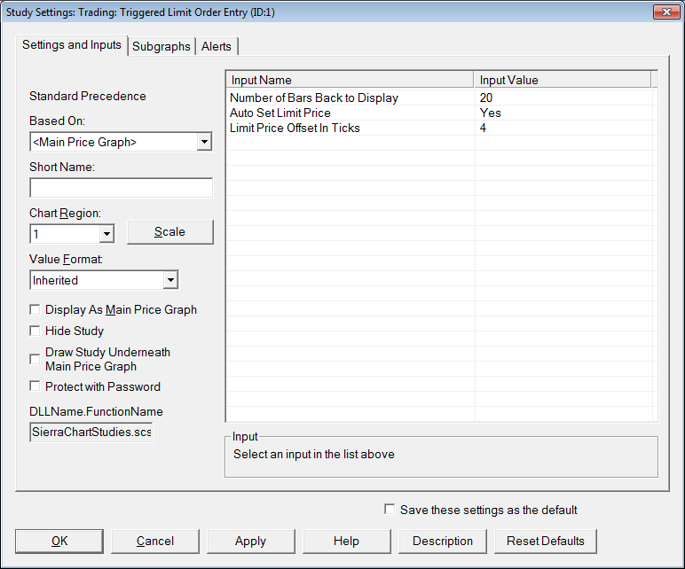

[2016-08-16 02:07:07]
This is solved in prerelease 1454.
There is new Input setting to automatically set the limit price based upon a certain number of ticks from the trigger price and it is automatically determined to be a buy or sell.
Date Time Of Last Edit: 2016-08-16 02:07:58
