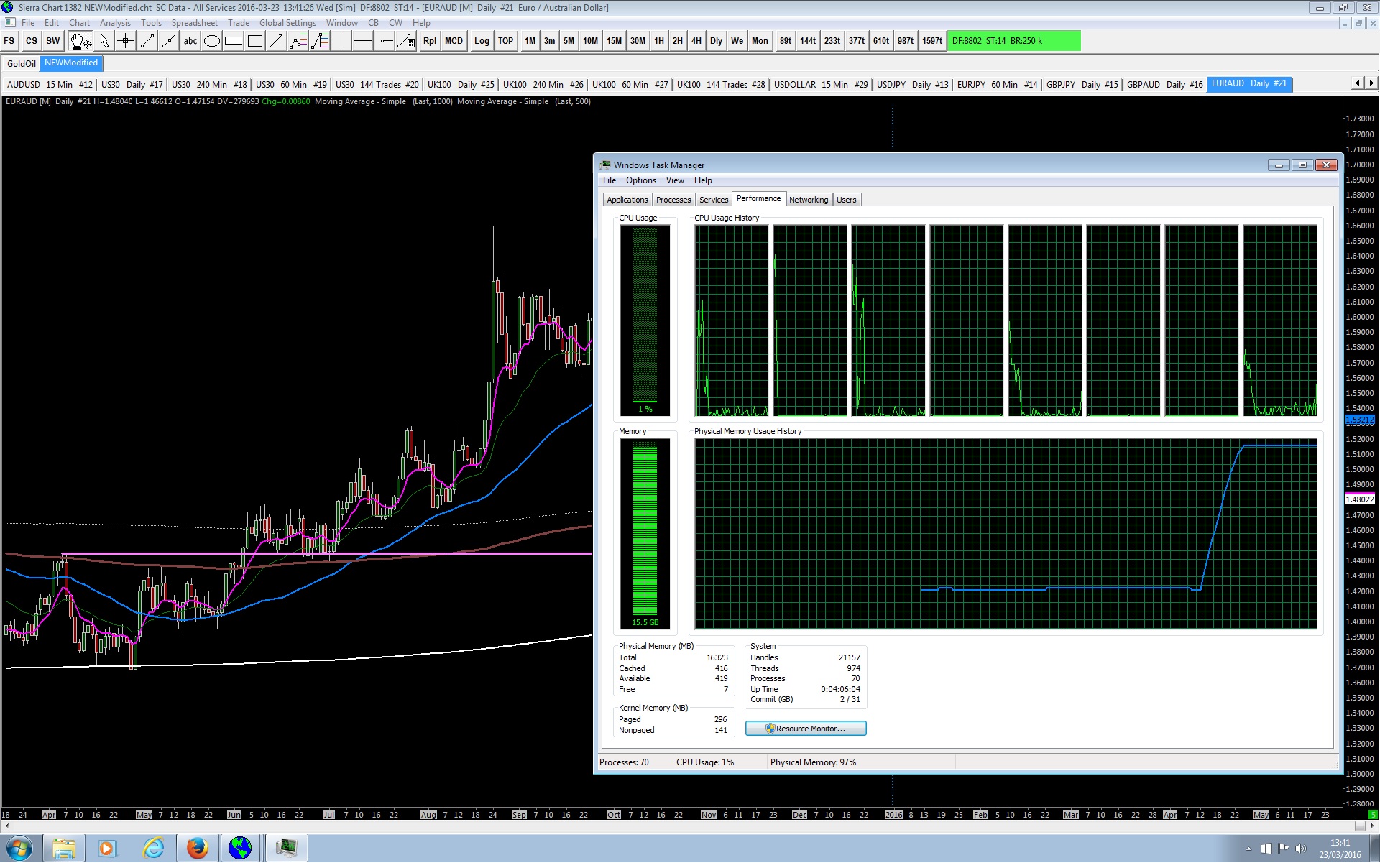

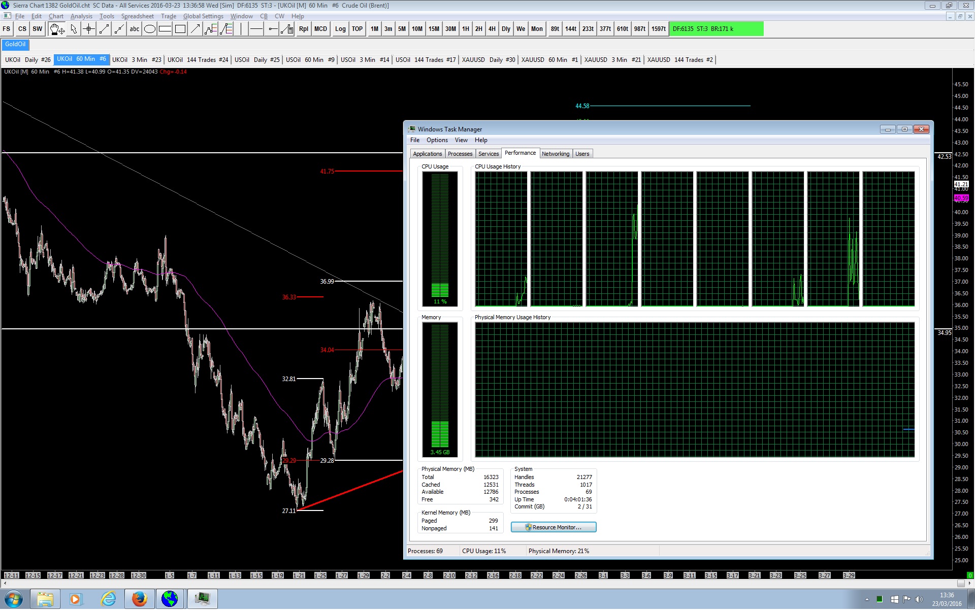

When using 12 charts my computer shows memory utalisation of 21%
When using 38 charts my computer shows memory utalisation of 97%
I am surprised that so much physical memory is being used by Sierra Charts. I have already contacted AntiVirus and other technical guys and they indicated that there may be some memory leak with SC.
Please help. How can I make SC use less memory.

[2016-03-23 17:12:05]
It is not possible for Sierra Chart to have a memory leak. This is something that we monitor extremely closely and there is no memory leak.
Based upon the large amount of memory use, this most likely is from the reading of Intraday data files and the caching of that data by the operating system.
You really should not be concerned about this because the operating system will manage this. It also could be caused by your antivirus software.
But it is not possible for Sierra Chart itself to be using that amount of memory. It cannot directly access more than 4 GB.
