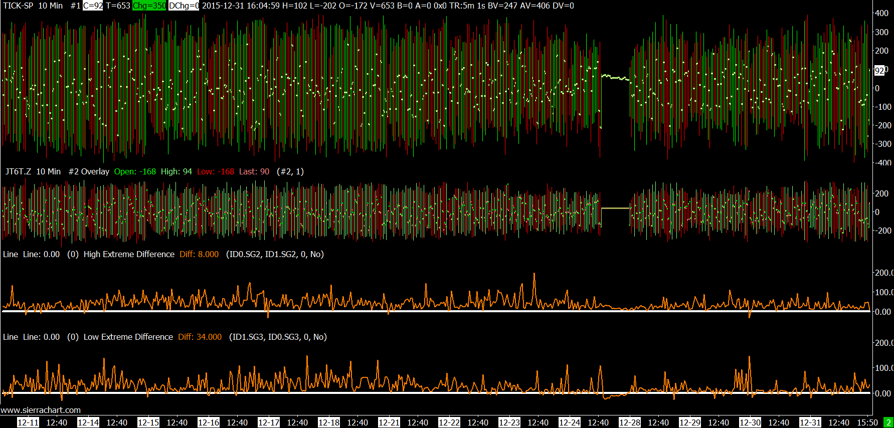

This is something we have mentioned in the article but we are only now paying more close attention to it:
http://www.sierrachart.com/image.php?l=1451785554504.png
This is a chart with two studies at the bottom showing that the extremes that the Sierra Chart calculated TICK for the S&P 500 stocks has are more than IQ Feed for the same S&P 500 TICK statistic symbol.
What does this tell us? We are sure we are using the correct IQ Feed symbol because that is what they specify for their S&P 500 TICK symbol:
http://forums.iqfeed.net/index.cfm?page=topic&topicID=3383
We cannot say with certainty, but the higher highs and lower lows, greater extremes, do indicate that Sierra Chart is delivering a much more complete data presentation. Sierra Chart does not use a sampling method but instead uses all trades of the S&P 500 stocks in the TICK calculation.
This chart here indicates the number of stocks that are used in the S&P 500 TICK calculation:
http://www.sierrachart.com/image.php?l=1451786374675.png
It increases on December 14, 2015 but we still notice greater extremes with the SC calculated TICK for the S&P 500 before this date. You can easily validate this yourself by looking at the TICK-SP symbol. We will see why there is a jump at this date.

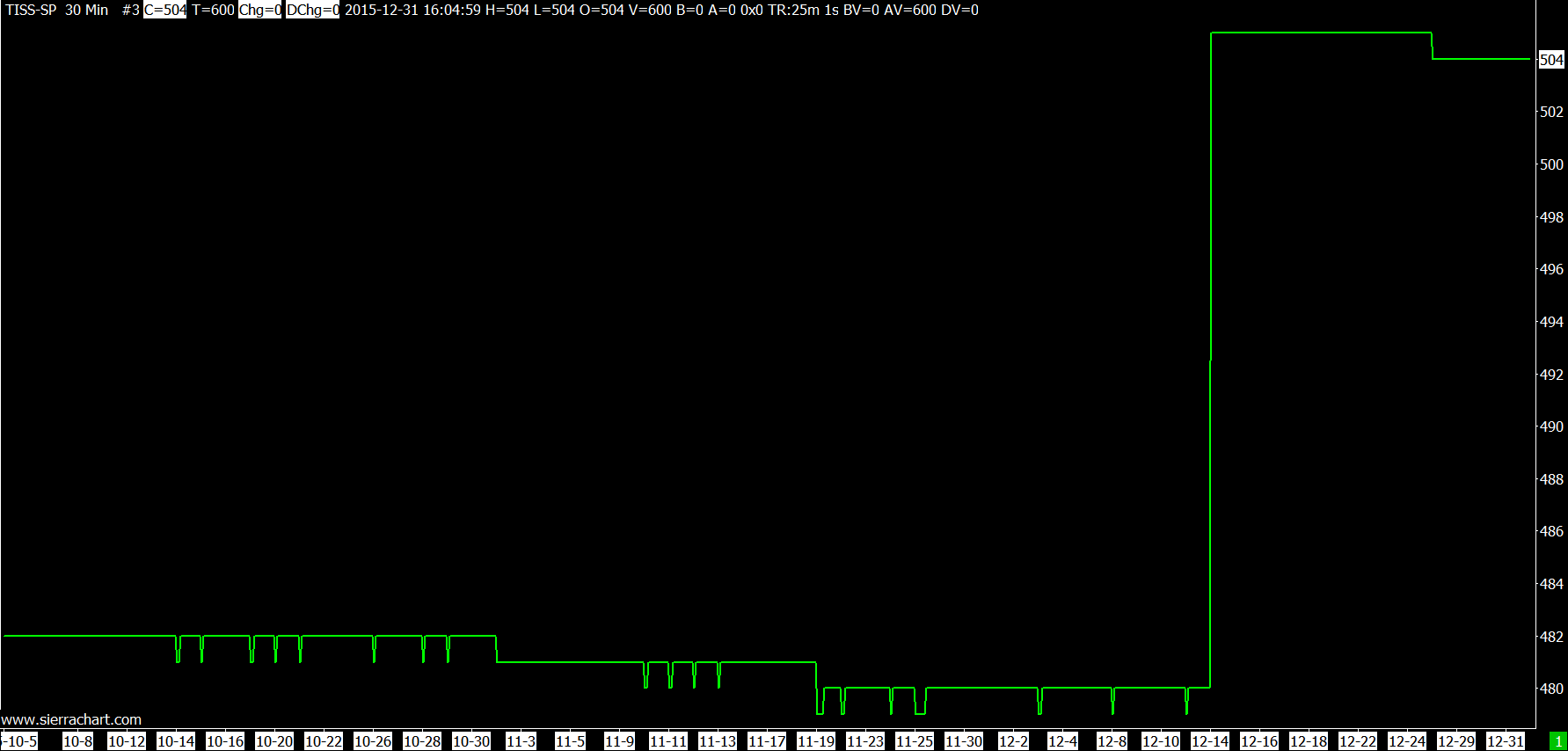

Out of interest did you discover why the jump in stocks in the basket on 14 December?
Is it possible S&P re-balanced the top 500 index on this date ie maybe 20 odd stock symbols were dropped and 20 new ones were added on this date to comprise the new top 500. If so this could perhaps explain that prior to 14 December those 20 new symbols will not be in your data set for the top 500.

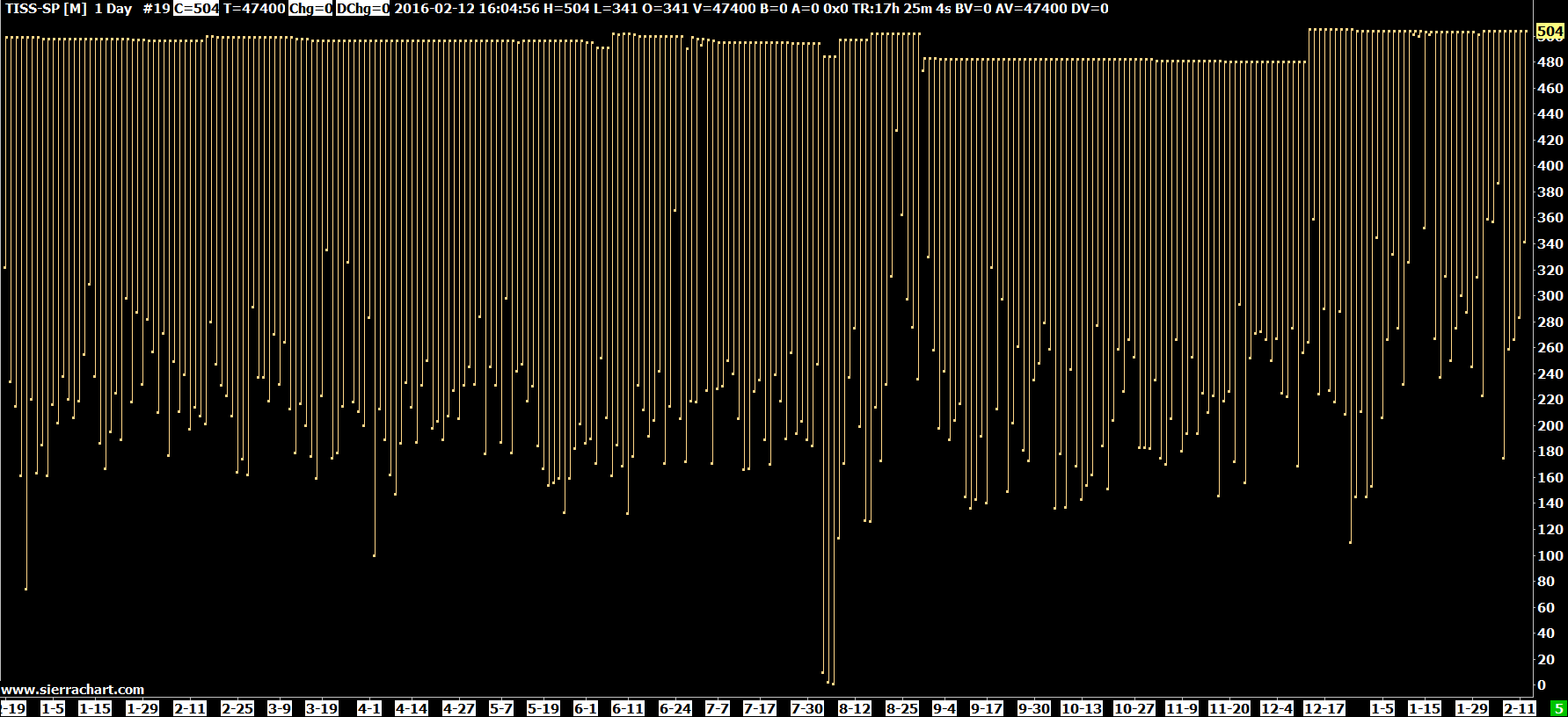

In this chart here:
http://www.sierrachart.com/image.php?l=1455484843825.png
You can see that the number of S&P 500 stocks drops to around 480 to 483 during 2015-8-31 to 2015-12-11.
Possibly the number of stocks in the index was actually was reduced during that time.
Possibly during the trading day not all of the S&P 500 stocks were trading during that time. This would seem very unlikely though.
Possibly the list of S&P 500 stocks that we use, was missing some of the S&P 500 stock symbols.
Possibly the data feed that we use to calculate the statistics from was not transmitting data for those stocks. Although this is extremely unlikely.
So we do not know.

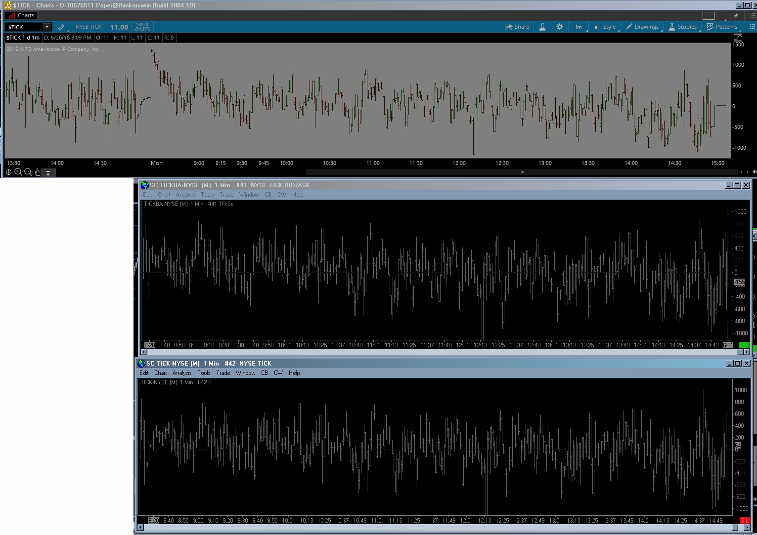

Paul.M - Posts: 115
Today's TICK showed a major difference to ThinkorSwim- and Tradestation TICK.
See the major difference at the open.
The market reacted to the version of TOS & Tradestation.
A sierra tick-version that mirrors TOS & Tradestation exactly would be helpful.
TY

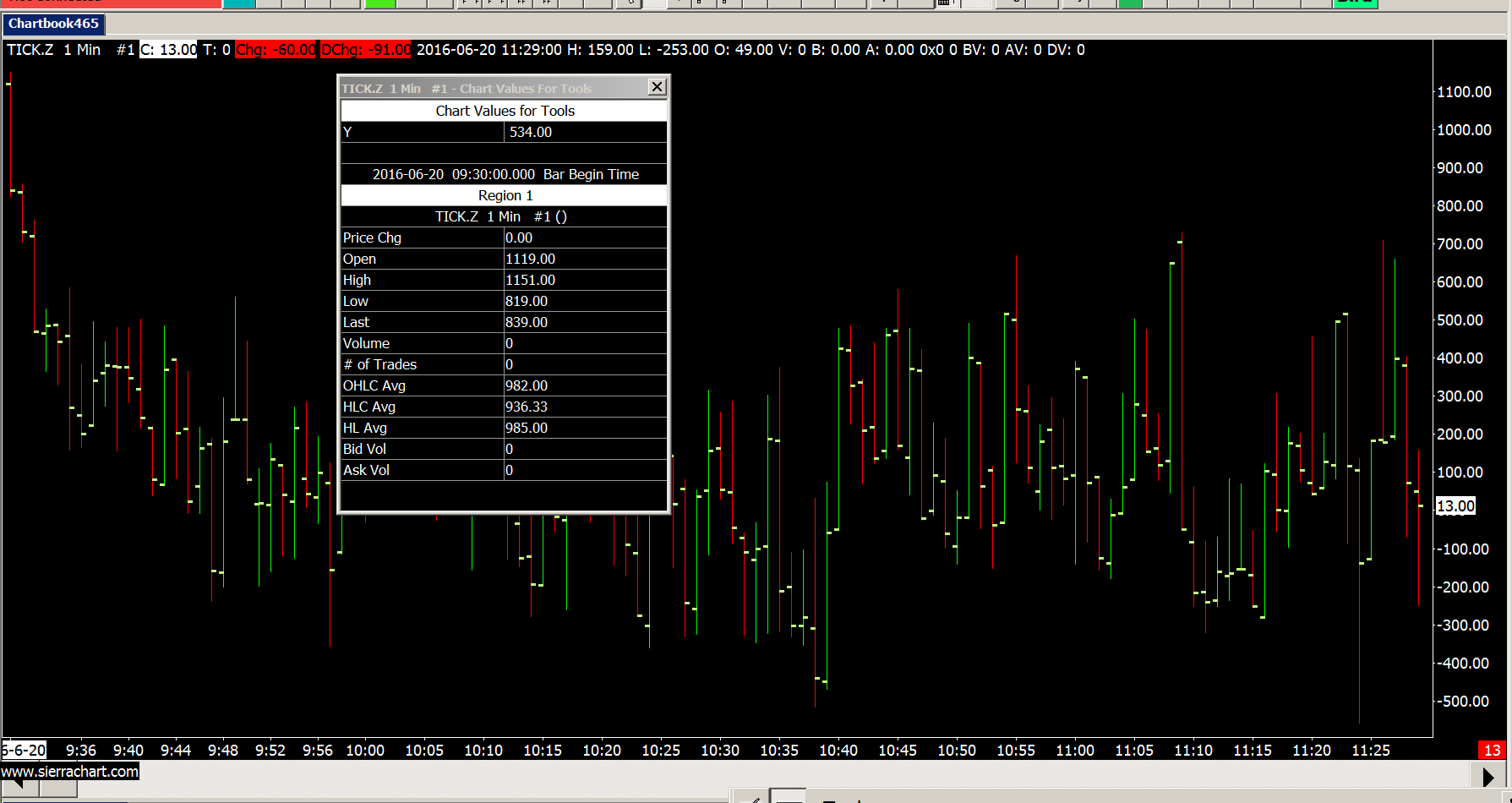

One thing that people do not realize, is that when you see the net TICK calculation start off at a very negative or very positive value at the very point in time where the calculation begins for the day, it must inherently be wrong. So are we saying those other calculations are wrong? Yes we are. They make no sense. We have confidence in what we say, unless the other services can explain how it is they do the calculation.
Here is a chart image of the calculation from IQ Feed:
http://www.sierrachart.com/image.php?Image=1466482465940.png
We see the very same thing. But it does not make sense.
In the past, the Sierra Chart TICK-NYSE would begin the calculation at 4 AM US Eastern time when the market begins to trade. However, because users would notice differences compared to our calculation and other services, we decided to change the start time to 9:30 AM US Eastern time. This is how it works now. Today the Sierra Chart TICK opens at 0.
The basic problem is that the market data is a high-speed single stream of data. Therefore, the calculation has to start off at 0, -1 or 1 since the very first trade is going to be a single stock. It can rise up or down very rapidly from that point in a matter of microseconds but it does not make sense for it to open very negative or positive. If it does, it calls into question as to whether the calculation method is even valid to begin with.
Other reasons for differences has to do with the underlying data data feed being used, but there is not an indication there is genuinely anything wrong with the underlying data feed used by Sierra Chart in the market statistics calculation.
However, we will make an inquiry with the data provider about a question we have related to this.
