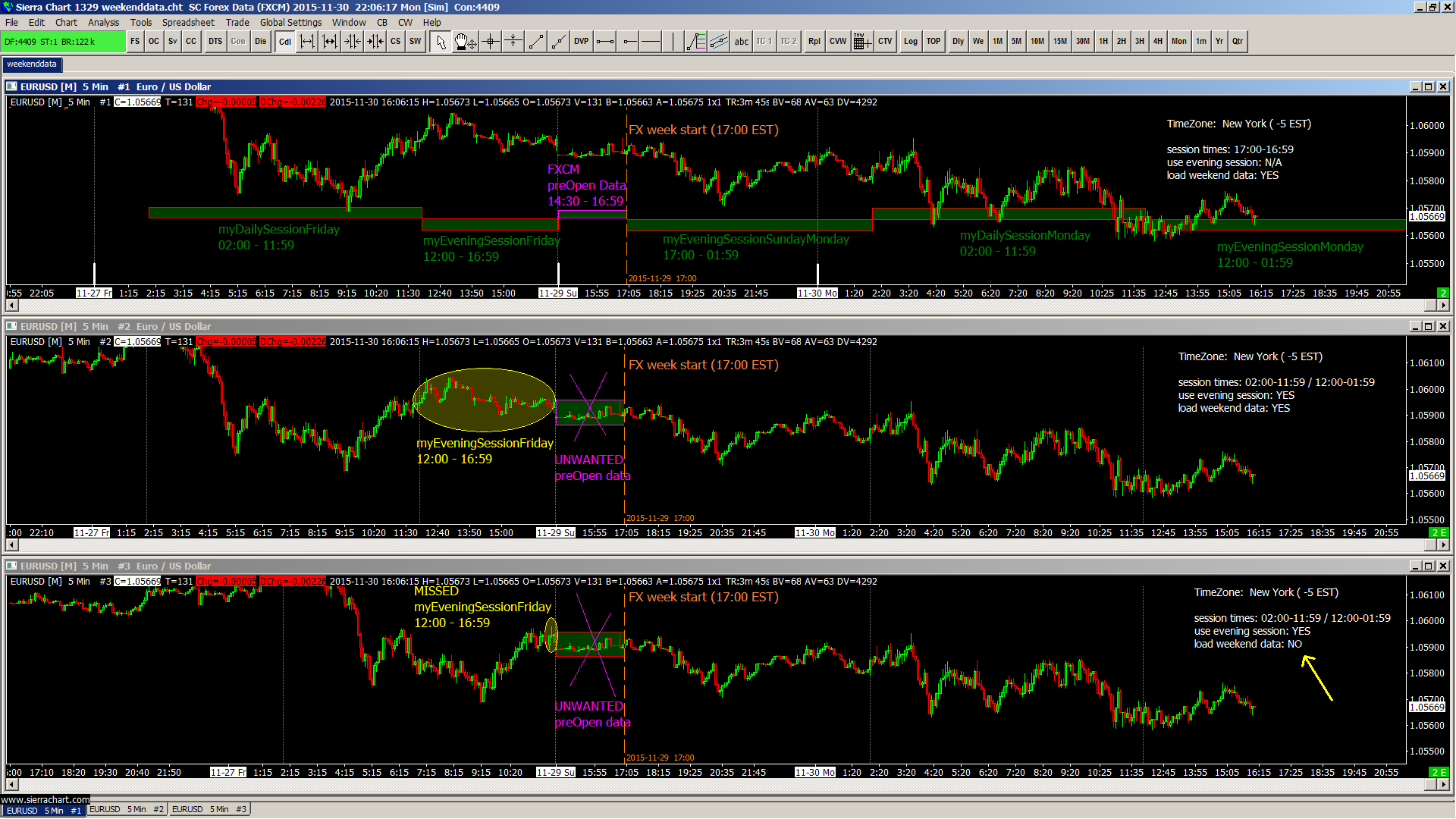

On the FX exchange I want to have two sessions, daily and evening, as follows:
based on 17 EST, a daily session 02-12 and an evening session 12-02(the daily correspond to 08-18 CET European)
I'm using the "SC Forex Data (FXCM)" service.
Unfortunately there are some problems:
chart 1 - (no problems here) classic opening and closing for the FX, one continuous session 17-16.59, I highlighted with rectangles sessions corresponding to sessions I need, which are in charts 2 and 3
chart 2 - if I use two sessions and also load the weekend data, friday evening data remains (correct) but sunday preopen FXCM data remains too, and it's not correct
chart 3 - same settings as in chart 2 but NOT load the weekend data, data on Friday disappear !!!! and, again, FXCM data remains ....
Instead, what I want is that Friday session must have 2 sessions (usual regular daily session and shorter evening session), and NO FXCM preopen data at all when week restarts
FXCM pre open data I think are totally useless, the best thing would be to completely eliminate them from the feed, the market at this time is only an interbank market, no retail can operate on those prices.
Those data changes TPO profile and price distribution and there is no way to remove them from the partial sessions profiles.
Can you resolve this problem?
Thank you

[2015-12-01 04:30:10]
In the US Eastern time zone, so you want to see data after 5 PM on Friday?
The basic problem is that the evening session for Friday is going to be considered Saturday so when you have Load Weekend Data disabled, that is not going to be displayed.
Seems like we would have to add separate Load Saturday and Load Sunday options. But we need a little more time to look this over.

Well.. I used EST time for a general purpose but if and when things will be resolved I will use the European GMT+1 time zone, but I think that should not change using session start/end time accordingly. Anyway , yes, i need to see data after 5PM EST on friday.
But as I said this is not the real point, i can see those data in chart 2 and activate or deactivate loading or unloading weekend data.
The big problem is relative the useless Sunday pre-open data, that can't be removed from the chart. The simplest way will be to delete data directly from the data feed, or an option to non load those preopen data, or don't load sunday data prior xx:xx time, or maybe better, start sunday data after xx:xx time.
Thank you for your kindly attention.
