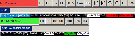

[2015-10-23 12:11:25]
wat - Posts: 67
i am still confused about (M) symbol. I know that the (M) symbol means that the data feed is working. But in first one connection i am not connected, but i can see (M) on chart. Otherwise in second connection, i am connected to your data feed, but there is no (M). As you can see below. I ve checked "Allow support for Sierra chart data feeds" and configuration is absolutely the same amid my sierra charts platforms.
Where is the problem ?
Thank you for your cooperation
Date Time Of Last Edit: 2015-10-23 12:15:33
imagefirst one no connected vs. second one connected.png / V - Attached On 2015-10-23 12:09:16 UTC - Size: 10.14 KB - 520 views
noticed the same as well...(using version 1314 and connected to IB )
If you should be receiving the Sierra Chart Exchange Data Feed for a symbol but you are not, we need to see the Message Log.
Provide a copy of the Message Log by following these instructions:
http://www.sierrachart.com/index.php?l=PostingInformation.php#MessageLog
And tell us one of the symbols and only one of them which should be receiving the data feed but is not.
