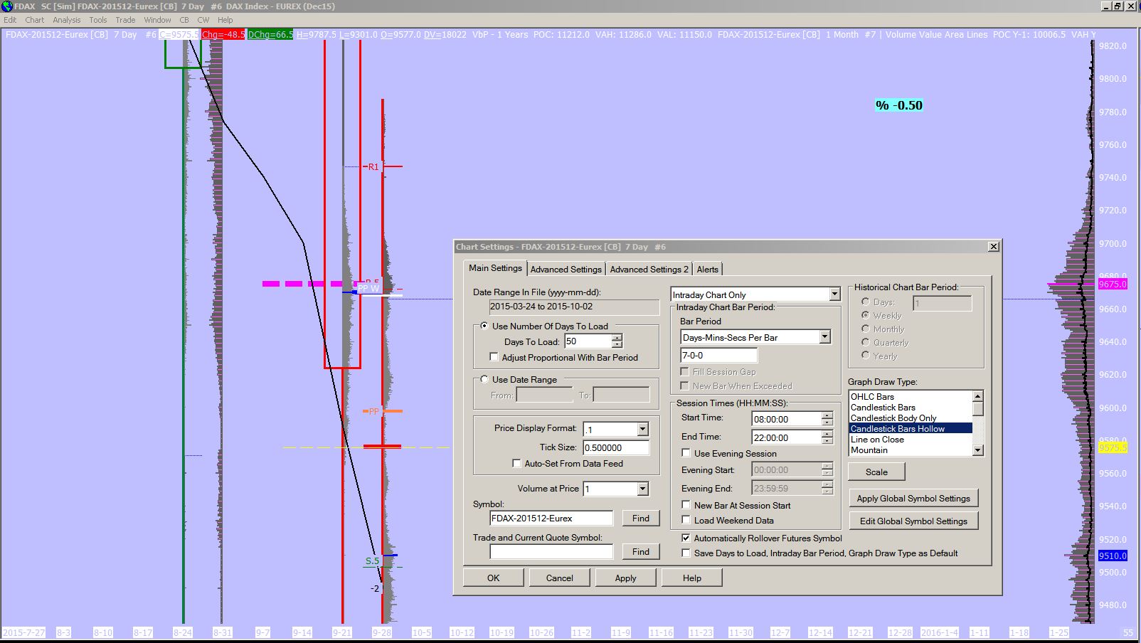

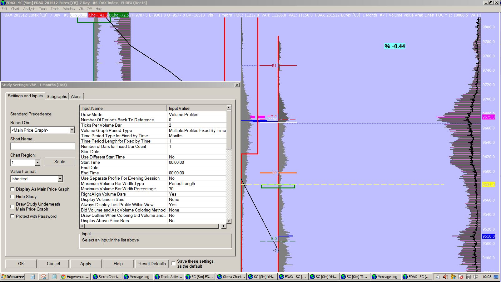

Problem with stard and end date of a monthly VPB studie applied into a weekly candelstick period chart. cf capture:
candelsticks are weekly with weekly vpb (poc in blue):ok.
VPB monthly (poc in pink) on the right :uncorrect : A new one should have started two days ago.
i have try differents parameters but unable to start a new vpb monthly at the beginning of each month with a weekly period chart.
note that vpb monthly are correct if applied into a dayli or monthly period chart.

The basic problem is you are not creating Weekly bars correctly from Intraday data. How to do this is explained here:
Chart Settings: Days-Minutes-Seconds-Milliseconds Per Bar (Chart >> Chart Settings >> Bar Period >> Intraday Chart Bar Period Settings >> Bar Period Type)
It is necessary to set a From date which begins on a Sunday.

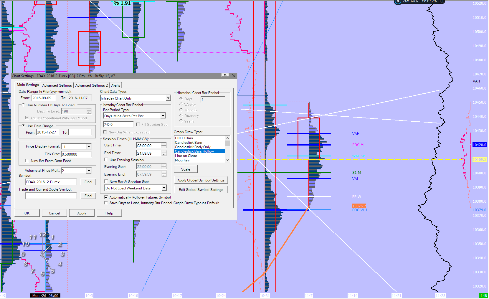

hello,
problem has reappeared, the vbp monthly display in a weekly chart has incorrect date start.
the start date of the week chart begins on a sunday as you ask me to set.
in blue vpb Week
in pink vpb Month

There are two problems here. We are not going to review, what you posted previously. This is out of the question. You need to restate the problem as simply as possible as it currently exists.
And you did not post an image following these instructions:
