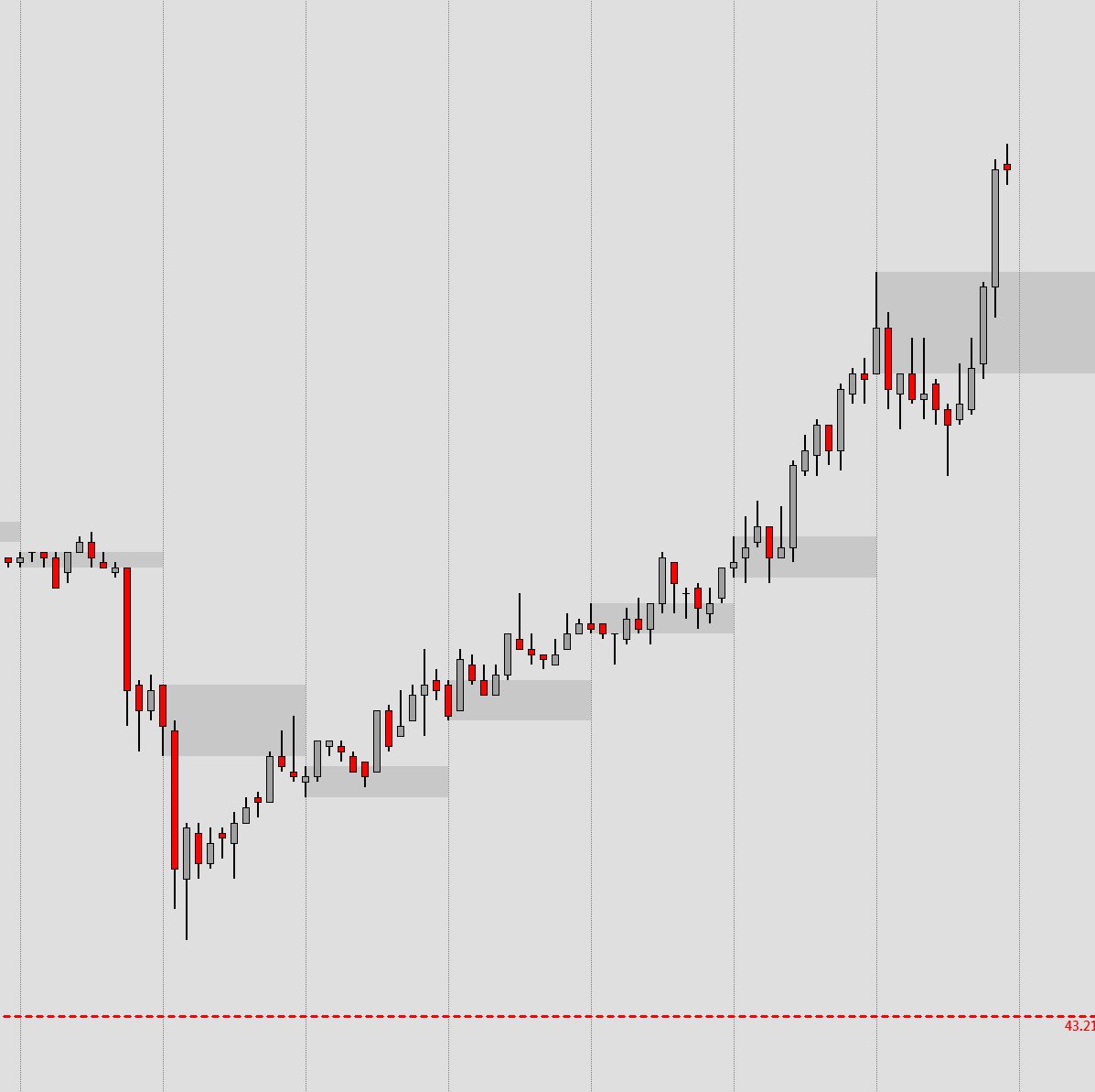

User63439 - Posts: 83
hi there,
i wanted to ask if its possible for you to create an hourly opening range indicator?
please see attached picture how it should look like.
thanks in advance
imagehourly_or.png / V - Attached On 2015-09-10 08:59:08 UTC - Size: 25.3 KB - 1297 views
[2015-09-10 09:26:34]
This can be done with the High/low For Time Period-Extended study:
http://www.sierrachart.com/index.php?page=doc/doc_TechnicalStudiesReference.html#s246
[2015-09-10 09:36:37]
but then the opening range will extend to the end of the day, not only till the end of the hour like in the picture
[2015-09-10 09:56:47]
That picture does not show the shaded area extending until the end of the hour which they are based on.
However, there are many questions about that picture which are not totally certain.
Anyway, just use High/ Low for Time Period instead.
[2015-09-10 10:04:10]
i think your not getting the point.
if you have questions about the chart feel free to ask.
i want the range of the first 5 minutes of an hour extended till the end of that same hour.
[2015-09-10 10:16:20]
No, we did not understand.
There is no built-in study to do exactly what you want.
You will have to program it.

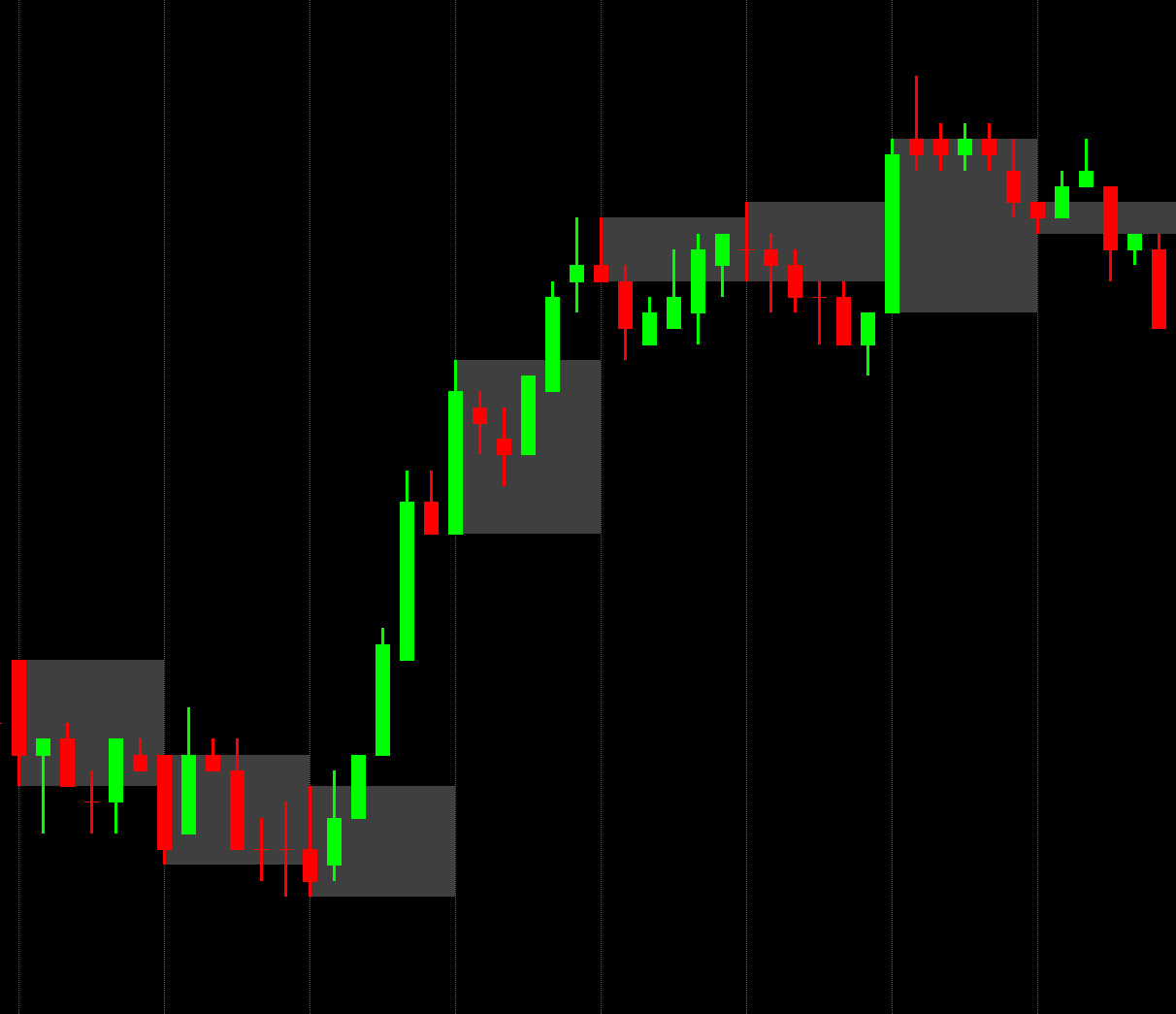

[2017-09-30 12:37:17]
User541842 - Posts: 34
hi tomgilb,
what i want to achieve is an opening range of 5 minutes for every new 30 minutes.
should look like the attachement.
cant get it working
imageor.png / V - Attached On 2017-09-30 12:37:05 UTC - Size: 20.35 KB - 824 views
[2017-09-30 13:47:51]
Sawtooth - Posts: 4360
Follow the instructions in post #8, but enter 30 in M1.
Also, in the spreadsheet study's settings, set the Number of Formula Columns to 60.
Then follow the instructions in post #12, using the examples in post #14, to replicate for other 30min segments of the day.
With the Number of Formula Columns set to the max of 60, there will be a max of twenty 30min segments, and you'll need to use the K3,L3,M3 formulas at the bottom of post #14 instead of those in post #8.

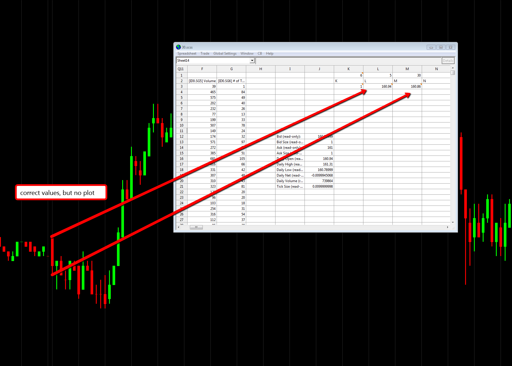

[2017-09-30 15:53:21]
not plotting the range. am i missing something? values are correct though
imageno_plot.png / V - Attached On 2017-09-30 15:52:17 UTC - Size: 147.46 KB - 834 views
[2017-09-30 16:01:26]
You're on Sheet4. Go to the Sheet# that matches the chart #

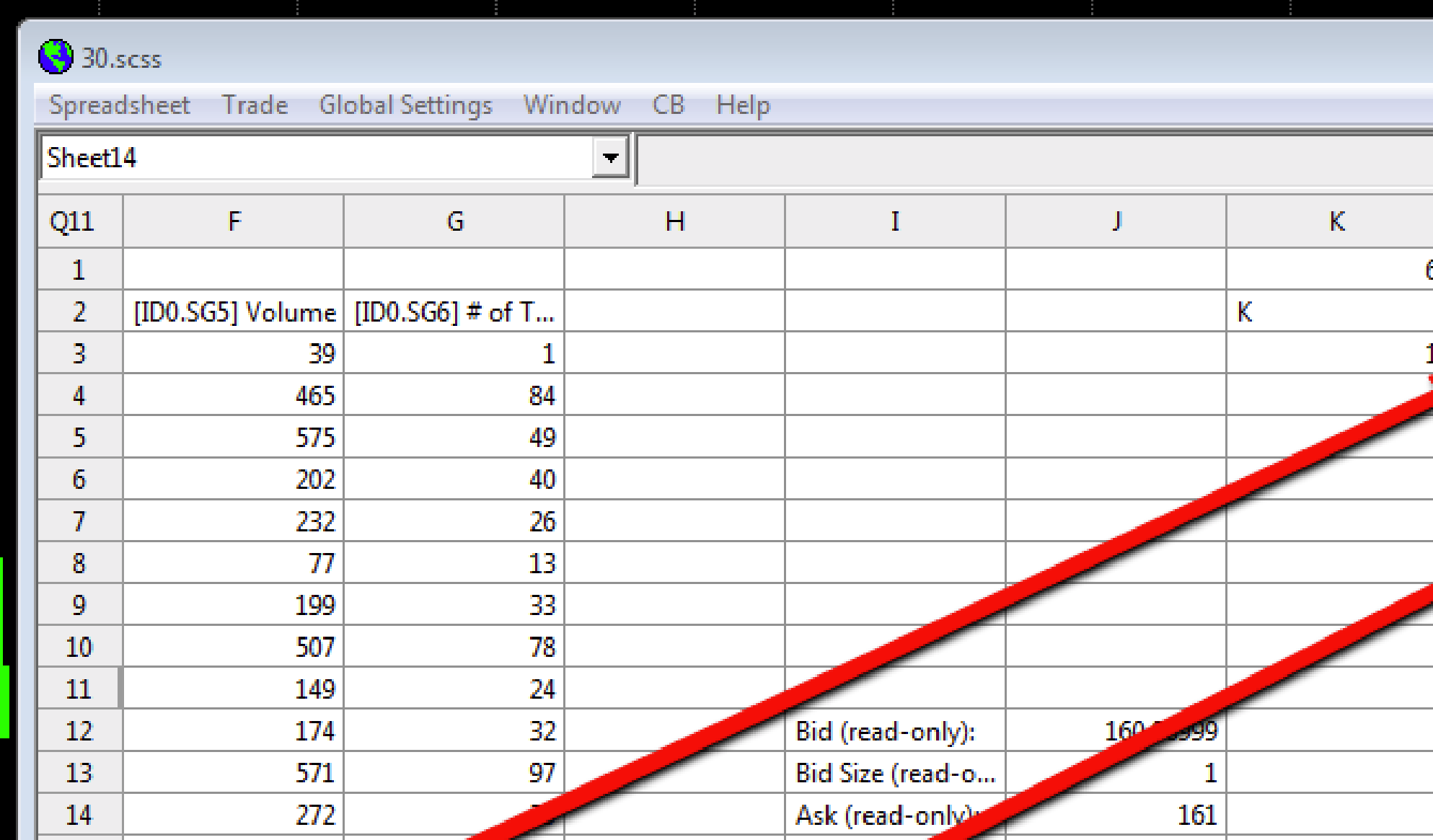

[2017-09-30 16:09:12]
matching the chart number
imagesheet14.png / V - Attached On 2017-09-30 16:09:07 UTC - Size: 100.08 KB - 823 views
[2017-09-30 20:58:01]
Also, make sure the Formula Source Sheet Number is the same as the chart #14
[2017-10-01 11:52:21]
thanks for your efforts tomgilb, but its not working.
no plot on the chart
Date Time Of Last Edit: 2017-10-01 11:52:36
