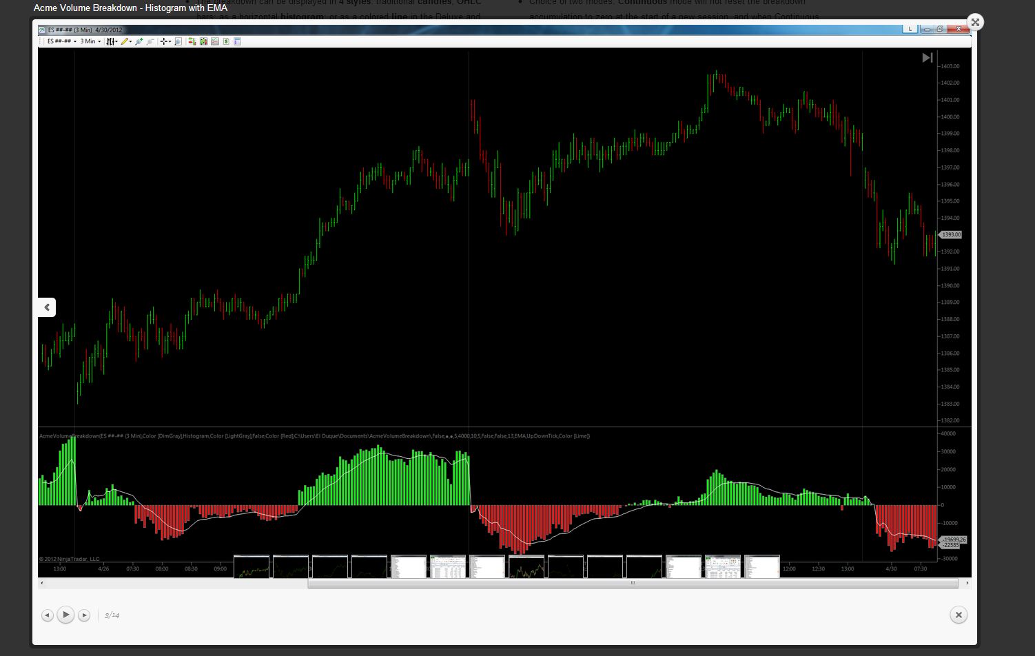

Hi there, is it possible to display this study as per the attached screenshot?
If so how do i go about this and also how do i change the colours for the +ve delta and -ve delta?
Date Time Of Last Edit: 2013-06-10 04:32:15
imagecum vol.JPG / V - Attached On 2013-06-10 04:31:30 UTC - Size: 116.95 KB - 3123 views

TastyRisk - Posts: 119
Try this:
1. Use the "cumulative delta bars - volume" study and set it to be hidden.
2. Add a "moving average simple" based on the above study with period set to 1.
Set the second study's subgraph as per the attached picture. (things to change are; a. Draw style. and b. Auto-Color.)
img: http://www.sierrachart.com/Download.php?Folder=SupportBoard&download=586
imagecdelthelp.png / V - Attached On 2013-06-10 16:00:42 UTC - Size: 21.5 KB - 1856 views

remynz - Posts: 17
Try this:
Thats exactly what i wanted - green grapes to you.. thanks vm!
