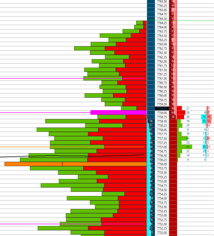

Trader369 - Posts: 24
I’m sorry but I don’t find the settings. The colors seems right red and green but not at the right place, only positive numbers in blue and negative numbers are well set in red in global settings colors. So I don’t understand what I have missed and why there is a gap between the market price and the real price. Btw why did you change a settings which was perfectly working on a former version?
Private File
[2026-09-03 19:20:24]
John - SC Support - Posts: 48259
Exactly what color are you wanting to change?
Assuming that the Pulling/Stacking columns are the ones on the far right of your image, there are no negative values displayed at the time of the image, so there is nothing to compare the current color setting to.
What exactly is the issue with the price? What is the gap you are referring to and what you are comparing against?

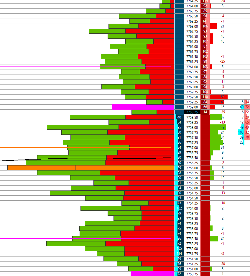

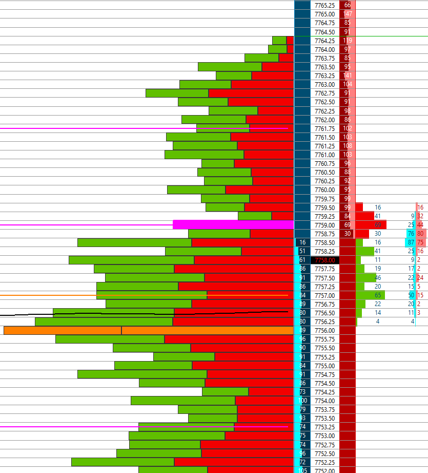

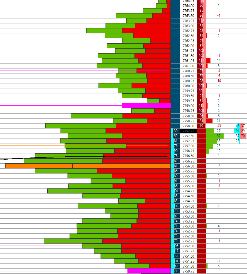

[2026-09-04 07:27:17]
Attached, screenshots of the two doms, you can see an issue with the negative pulling red numbers and gap between price and real market price. 2931 is good, 2947 is wrong.
[2026-09-04 07:27:39]
File attached
imageDOM 2931 1.png / V - Attached On 2026-09-04 07:27:26 UTC - Size: 53.33 KB - 53 views
imageDOM 2931 2.png / V - Attached On 2026-09-04 07:27:30 UTC - Size: 58.15 KB - 46 views
[2026-09-04 07:28:01]
File attached
imageDOM 2947 1.png / V - Attached On 2026-09-04 07:27:51 UTC - Size: 53.06 KB - 50 views
imageDOM 2947 2.png / V - Attached On 2026-09-04 07:27:56 UTC - Size: 54.03 KB - 52 views
[2026-09-04 13:28:42]
We now understand what you are seeing, but we do not understand why. Attached is what we see when we open your DOM from version 2947. Everything looks correct.
