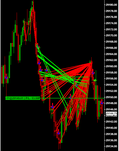

[2026-11-06 17:26:47]
User512353 - Posts: 198
There are more strange things observable with spreadsheets.
This time it is about obscure entries.
Preliminary remarks:
1. In the spreadsheets used, a buy/sell can only occur if a) v2:J34>0, i.e. not in a losing position, and b) add-to-position can only occur if ID0.SG4@3>v2:J48 (for buy; '<' for sell), i.e. if market price is above/below last entry price.
Case 1 (screenshot 15:11 UTC):
During heavy volume in short time, SC started to "binge sell" over 120 contracts.
While the chart shows a sell signal from an ss/alert study, the actual ss/trade study conforms to remark 1 above, so no entry should be made.
During this specific event, I had the spreadsheet right in front of me, and M3 (sell entry) was 0 all the time.
However, strangely, M4 was 1 all the time, which cannot be explained either.
The sells occurred rapidly after another with multiple entries in one bar, which also should be impossible, because 'signal only once per bar' is active.
Case 2 (screenshot 15:52 UTC):
Similar case, this time with buy entries, but not that rapid as at 15:11.
The volume per time interval was lower here, but still high.
The entries should not occur because of remark 1 above.
It is not clear why SC executes these entries. The implemented logic is clearly opposing this.
And also no 1 can be observed in the K3 or M3 cells, except maybe for the very first entry.
Generally, these observations (the new ones here on entries, as well as the previously reported ones for exits) always occur during times where an extremely high volume is processed. The chart update interval was deliberately set to 250ms to slow down processing. I have set it to 30ms now and will observe further. The actual measured chart update time is 6ms.

imageScreenshot From 2026-11-06 15-11-03.png / V - Attached On 2026-11-06 16:59:51 UTC - Size: 10.1 KB - 29 views
imageScreenshot From 2026-11-06 15-52-38.png / V - Attached On 2026-11-06 16:59:57 UTC - Size: 12.64 KB - 28 views

[2026-11-06 20:56:17]
John - SC Support - Posts: 48646
We also wonder if those entries/exits were actually created by the spreadsheet. Be sure to look at your Trade Activity Log and see if it shows the source of those trades as coming from the Spreadsheet.
Typically when we see a lot of orders being sent like this, it is due to a stuck key on the keyboard that is tied to a trading shortcut.
