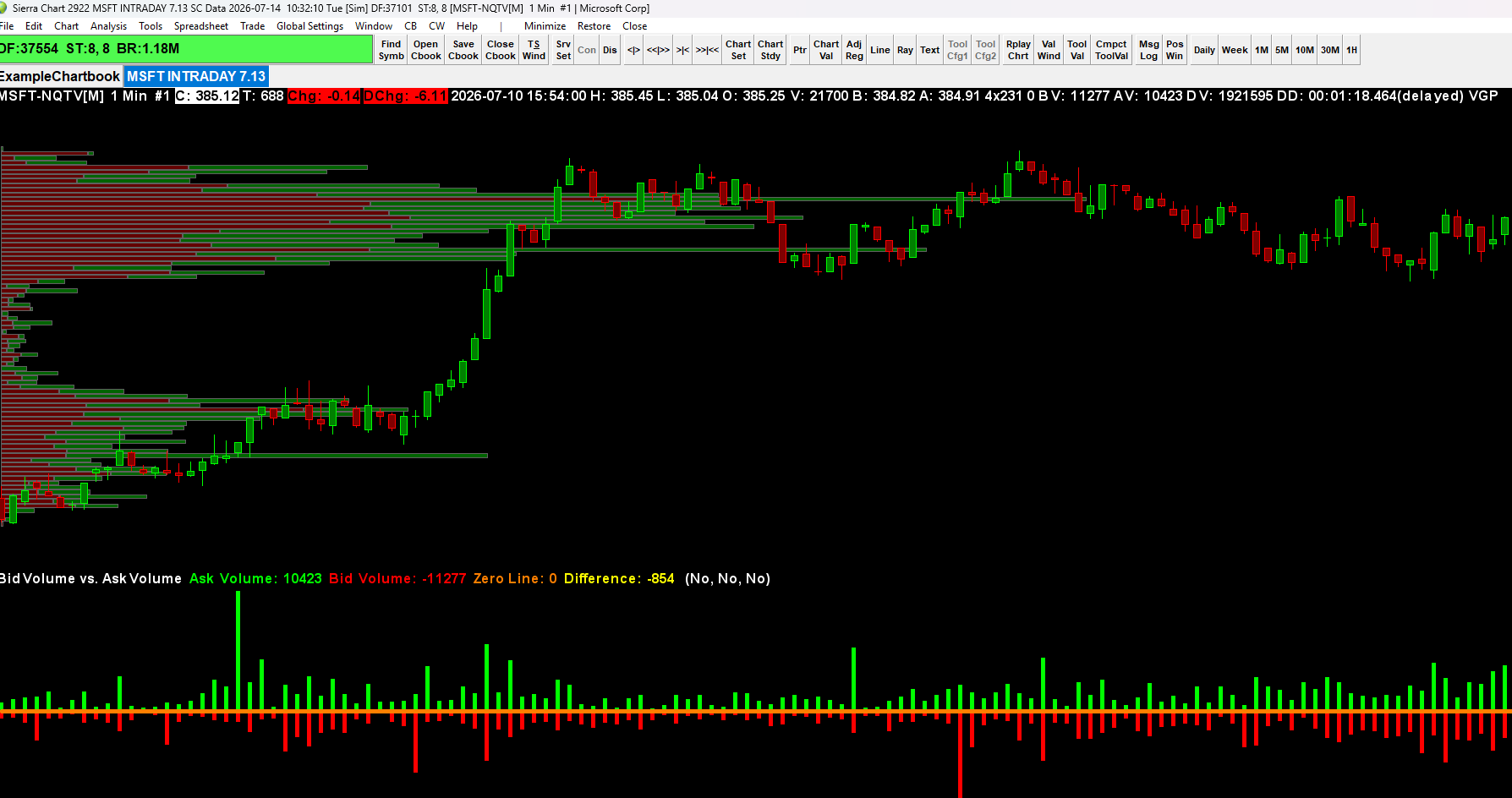

User153304 - Posts: 6
Am not seeing the Volume at price, and i have purchaed package 11. I have installed the current version but no success.

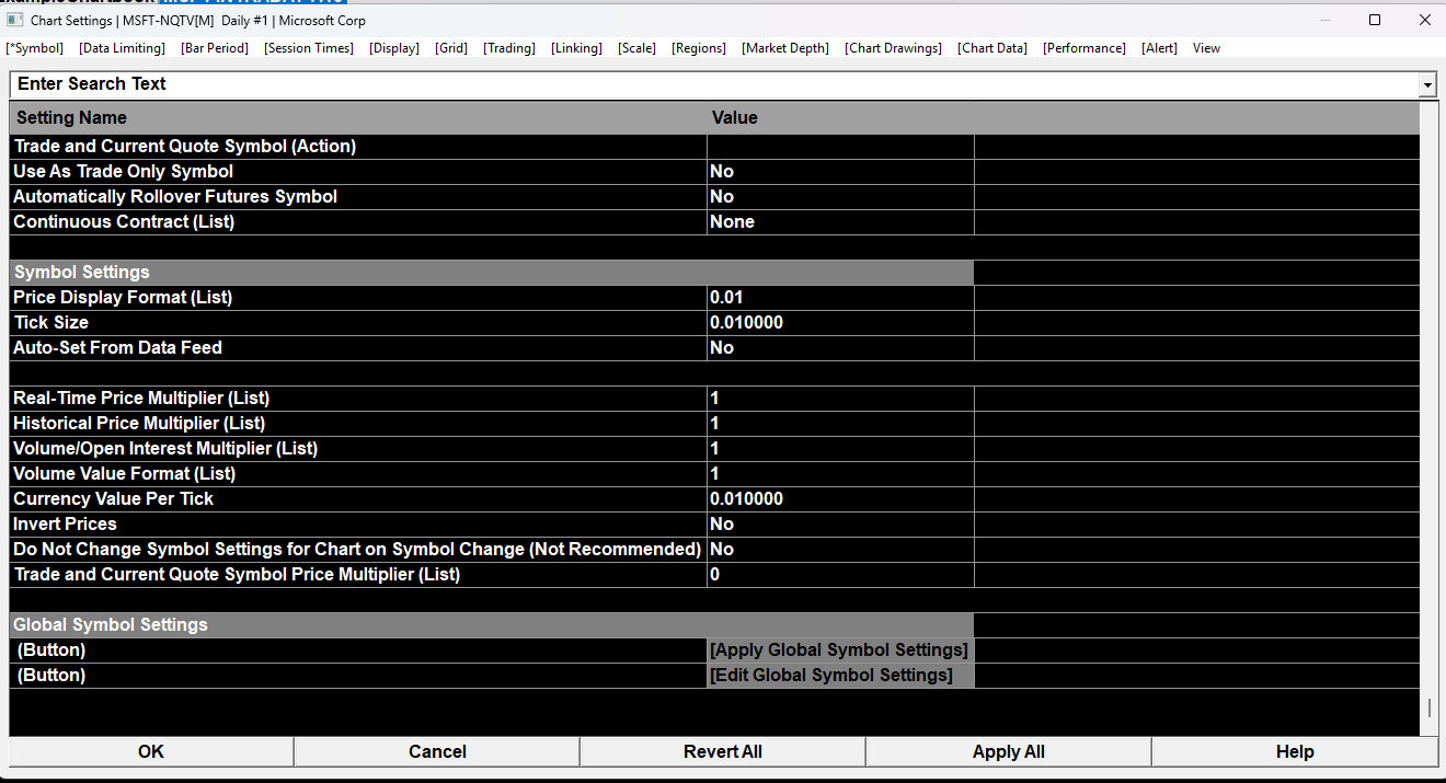

[2026-07-14 16:57:33]
Picture attached of Symbol. The reason I think am still in delay because am missing some studies,
like the Volume at Price study.
imageChart setup on symbol.png / V - Attached On 2026-07-14 16:53:21 UTC - Size: 60.45 KB - 85 views
[2026-07-14 18:12:40]
John - SC Support - Posts: 48193
Delayed data does NOT have any impact on what studies are available.
We do not believe your data is delayed. Everything about your account shows that you should be getting the real-time data for the symbol "MSFT-NQTV", which is the symbol in the image you provided.
To know for sure if your data is delayed, look in your chart header for an entry that is prefaced with "DD:". The time showing after that "DD:" is the difference in time between your local computer clock and the exchange clock, as determined by the timestamps on your incoming data. If you do not see "DD:" in your chart header, then add or move it so that you can see it and the value after it. Refer to the following:
Working With Charts: Region Data Line / Chart Header
A value of a few seconds to even a few minutes typically indicates a difference in the clocks and can be ignored. If your data is actually delayed, then the DD: value will be at least 15 minutes for the NASDAQ TotalView data.
Given the above, the next question becomes what exactly is occurring when you add a Volume by Price study to your chart?
What "Volume Graph Period Type" are you using?
The chart for which you showed the Chart Settings is set to be a Daily chart. If you are setting up a Volume by Price for a day, then you will not get much information for that from a Daily chart, but it should still be displayed. Refer to the following:
Volume By Price Study: How Volume by Price is Calculated for Historical Daily and Higher Timeframe Charts

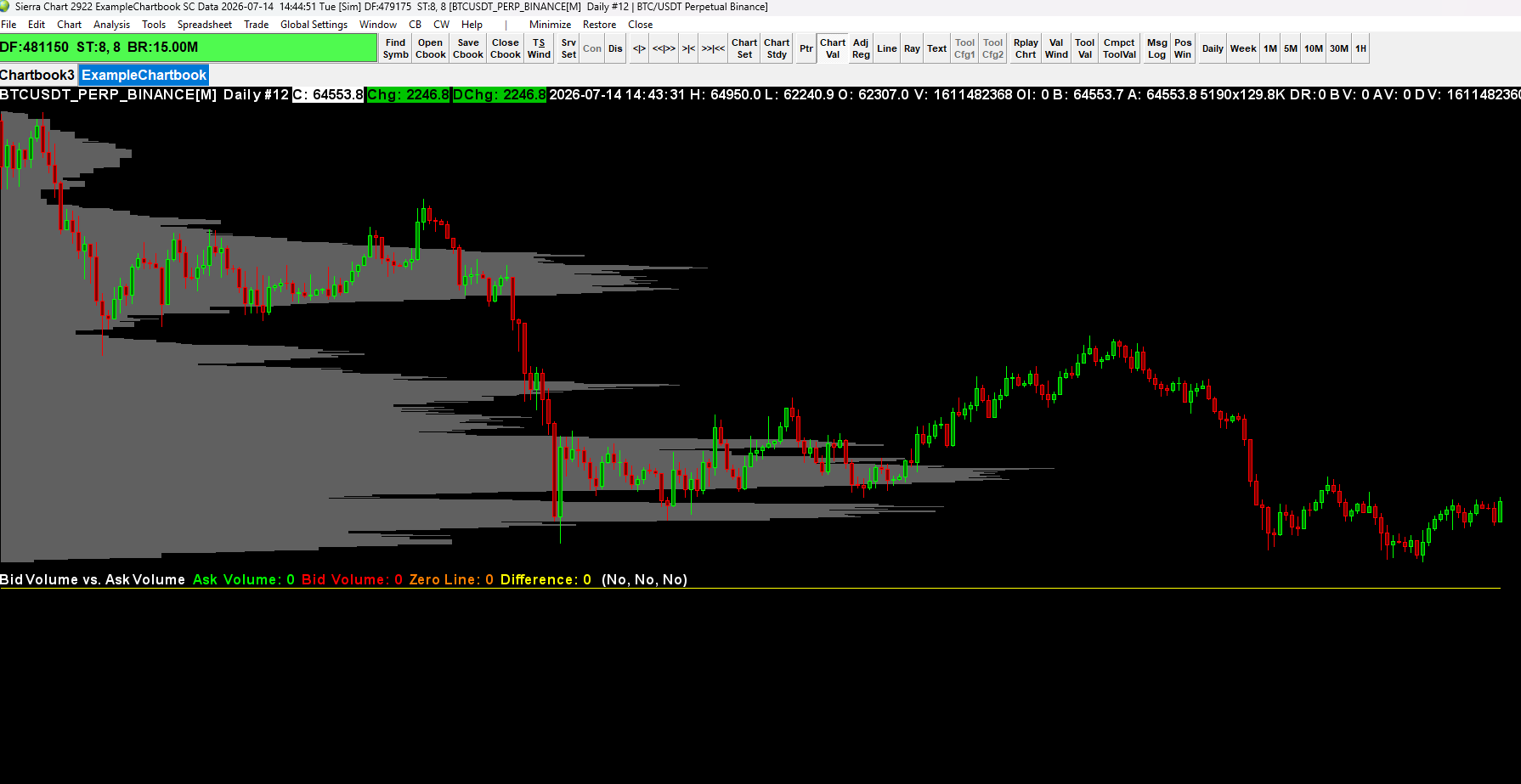

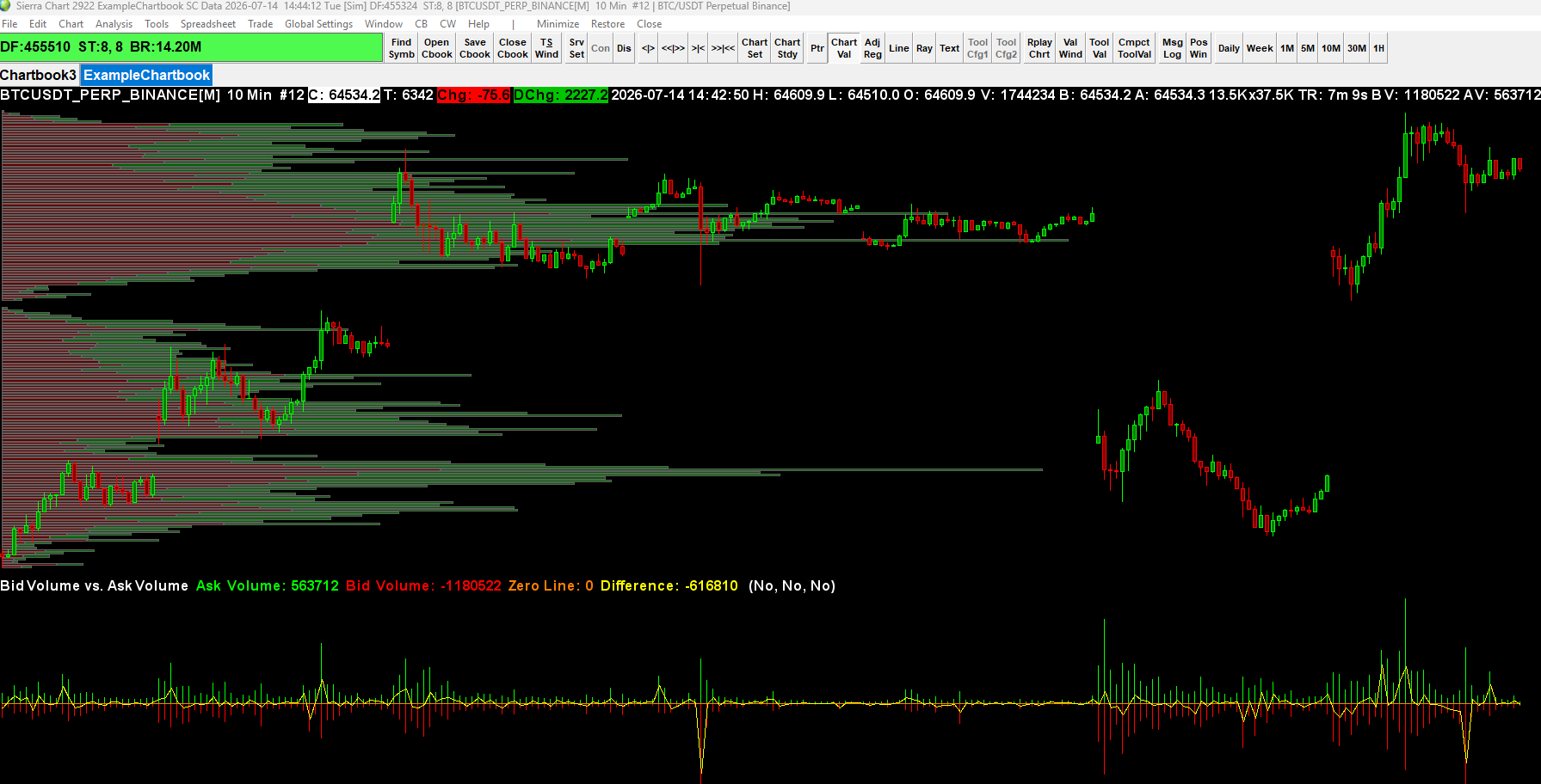

What I am trying to acheive is the volume profile and the volume bars for the daily charts that have the different colors showing similar to the 10 min chart thats attached. The shows bid volume verses ask volume.
We want to be able to look back at historical data say January 1st, 2024 - December 31st, 2024 and want to be able to get the same output as the 10 min chart.

[2026-07-14 19:23:49]
The reason why you are not seeing the colors in the image named "Daily chart.png" is that the volume bars are too close together. You need to increase the "Ticks per Volume Bar". Refer to the following:
Volume By Price Study: Ticks Per Volume Bar
We are a bit confused by that image, since it is a Daily chart, what is the time period of that Volume Profile?
And keep in mind the information we linked you to related to how the Volume by Price is calculated on Daily Historical Data.

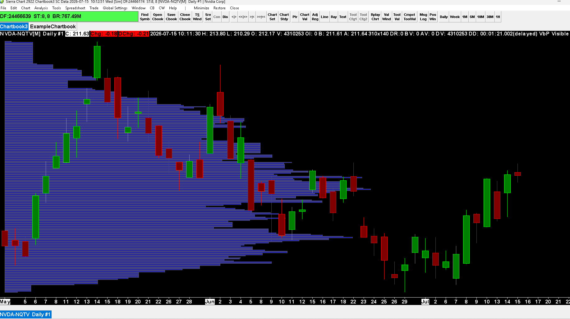

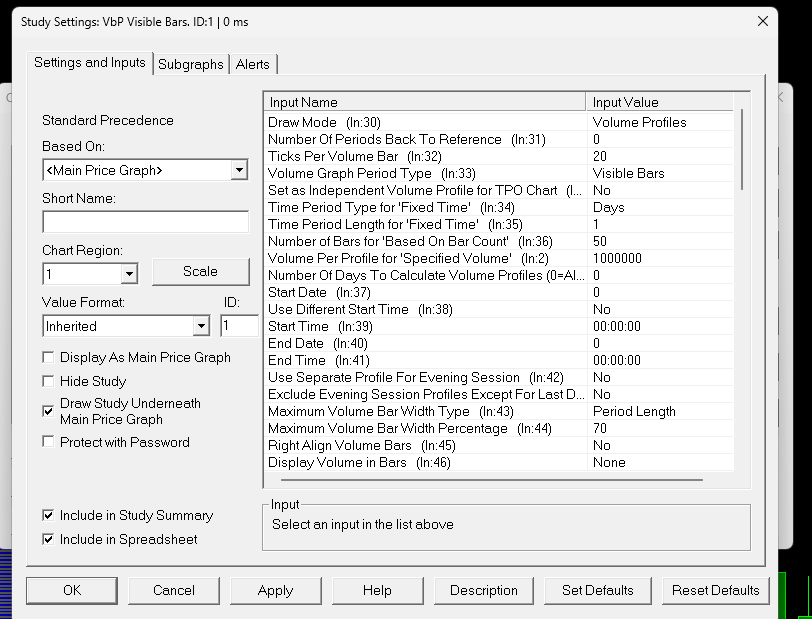

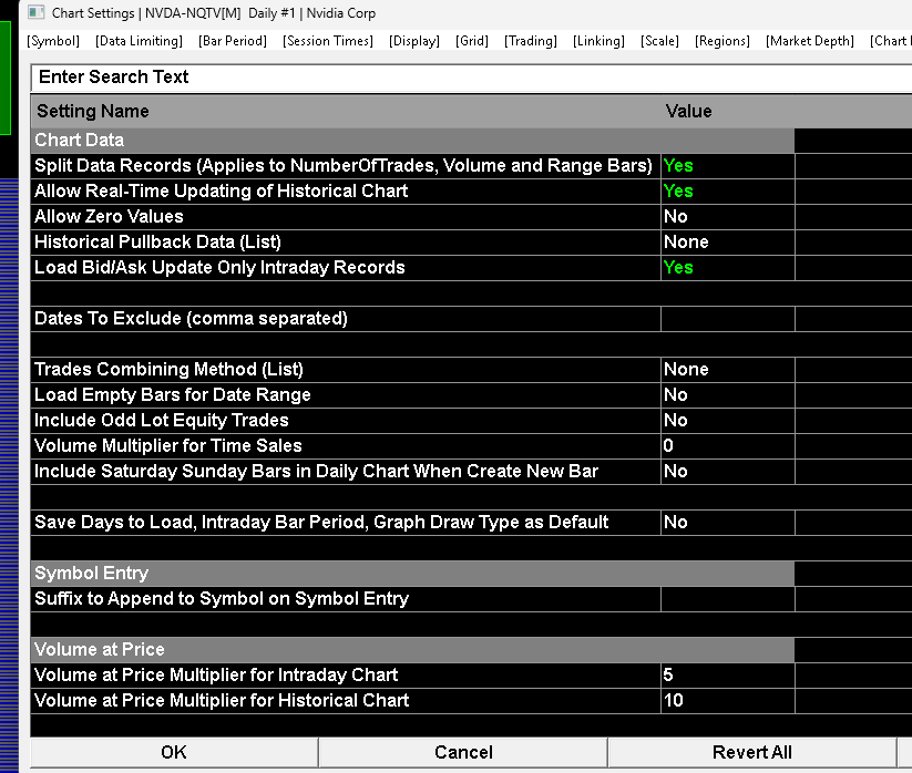

Morning
I did increase the volume bar ticks and the chart setting but I still only get blue lines. I want the chart to look just like the 10 min chart with BTC which I had previous sent. Also attached is the daily chart view of NVDA and how it looks now, the chart setting, and VPB bar setting pictures.
I appreciate all that your are giving me and your time.
Thank you.
Colm
imageNVDA daily.png / V - Attached On 2026-07-15 14:17:52 UTC - Size: 57.52 KB - 72 views
imageVPB bar settings.png / V - Attached On 2026-07-15 14:18:46 UTC - Size: 34.29 KB - 76 views
imageChart setting - chart data.png / V - Attached On 2026-07-15 14:18:58 UTC - Size: 32.28 KB - 80 views
[2026-07-15 15:41:56]
Refer to the following Volume by Price Input and make sure it is set how you want:
Volume By Price Study: Bid Volume and Ask Volume Coloring Method
You may need to increase the "Ticks per Volume Bar" some more in order to make sure you are seeing the information you want.
