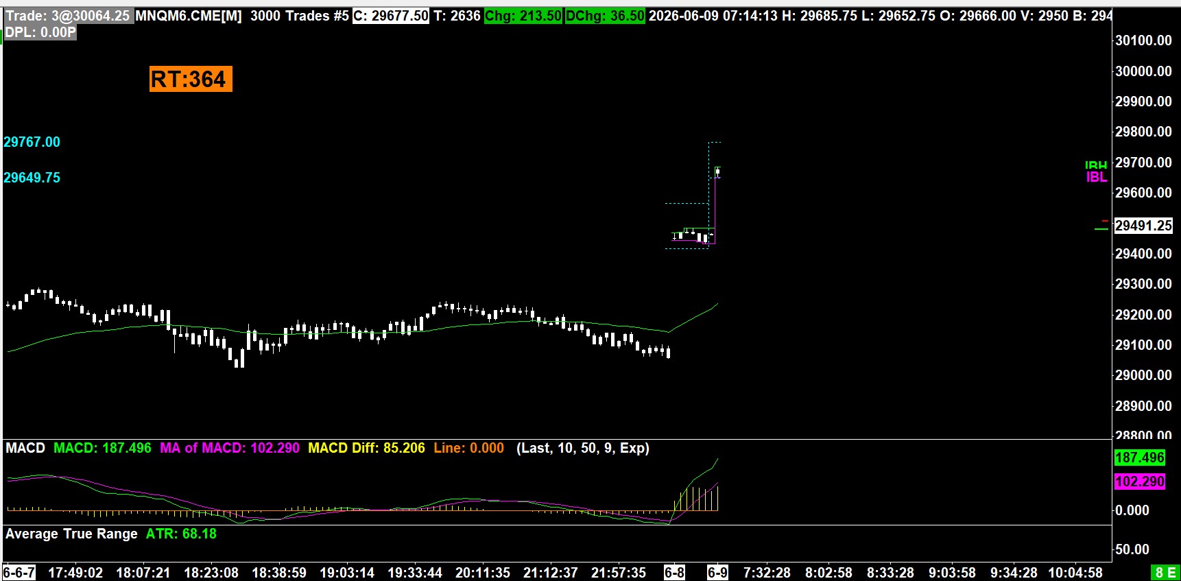

All my charts are either NQ or MNQ. The rest of the charts are showing fine (NQ), except for the MNQ. I've tried using different bar intervals, but current day bars are still not showing. Previous day bars are showing on the left-hand side of the chart. For the current day, price is moving, but no bars is shown on the chart.
imageScreenshot 2026-06-09 071430.jpg / V - Attached On 2026-06-09 14:14:48 UTC - Size: 194.63 KB - 122 views
[2026-06-09 16:44:22]
Please go through the items at the following link:

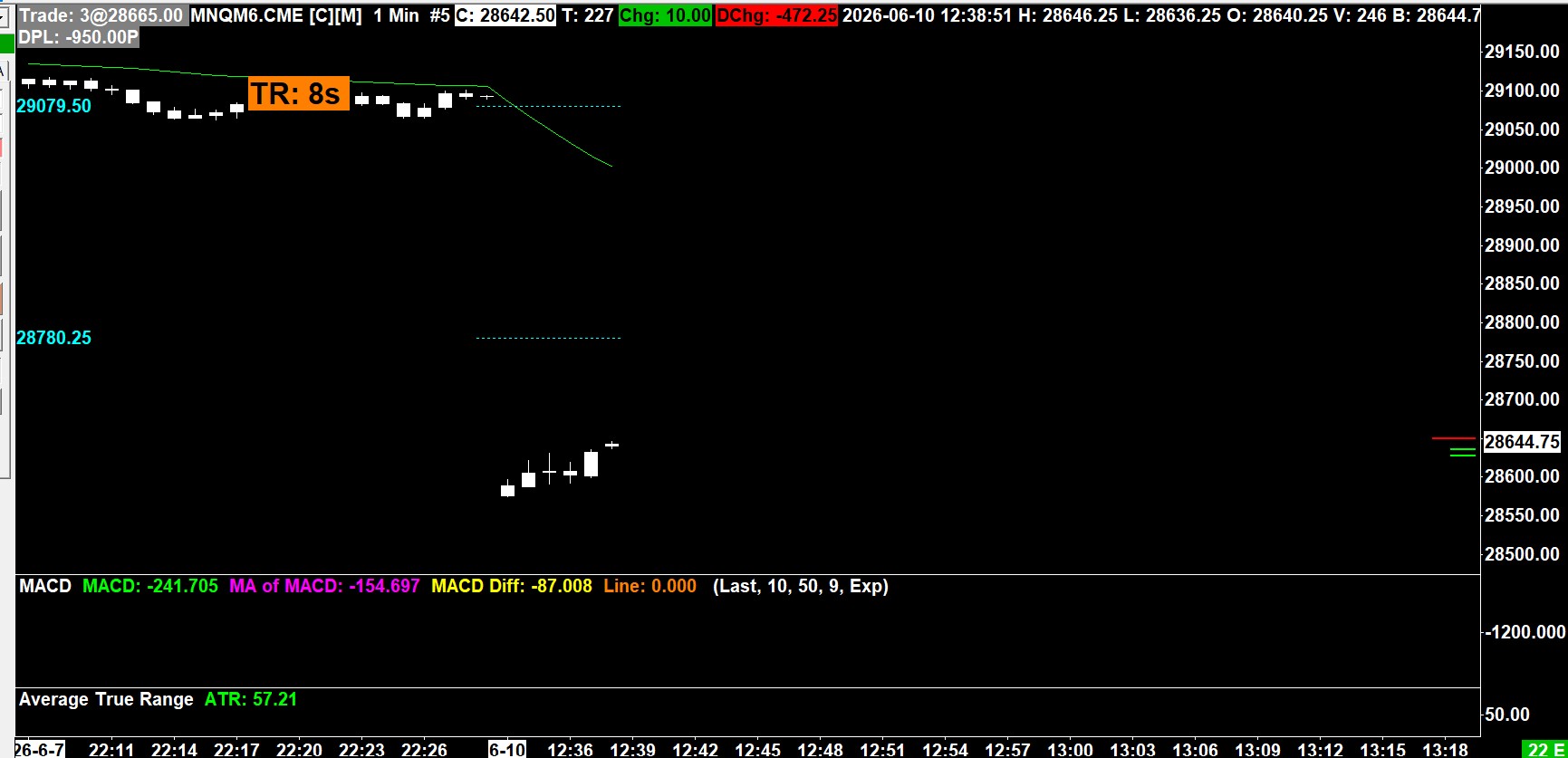

I've deleted the expired symbols files and that freed up space, including the MNQM6.CME. There is now 42gb of space available. The intraday chart finished downloading for this symbol. However, the chart still looks like this. The studies below the chart are blank, there are missing bars from today, the current bar is not printing as price moves up and down. I've attached a new screenshot.

[2026-06-10 20:49:08]
From the image, the current bar appears to be in line with the current price, so we do not think there is an issue with this. If this does get offset, then check your "Session Times" to ensure they are set to cover the time periods you want.
