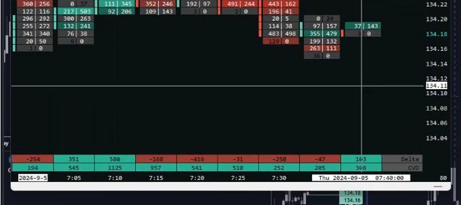

I am trying to replicate the Delta and CVD rows visible in the attached screenshot, which shows a 5-minute footprint chart with two compact rows sitting neatly beneath the footprint bars — one labelled Delta and one labelled CVD.
The rows appear to be the same height as a single footprint cell, with coloured backgrounds (red for negative delta, teal/green for positive) and a single number per bar.
I have tried using the Numbers Bars Calculated Values study in Chart Region 2 with Numeric Table as the Graph Draw Type, but the rows produced are much taller than what is shown in the screenshot and do not match this appearance.
Can you advise what study or configuration produces the Delta and CVD rows shown in the attached image?
Any help is very much appreciated. Thanks.
imageDelta and CVD Rows.jpg / V - Attached On 2026-05-26 14:55:24 UTC - Size: 125.93 KB - 125 views
[2026-05-26 16:55:19]
That is the "Numbers Bars Calculated Values" study those particular items.
If the issue is strictly the height, then you need to adjust the size of the Region where that study is showing. Refer to the following:
Working With Charts: Chart Window and Regions

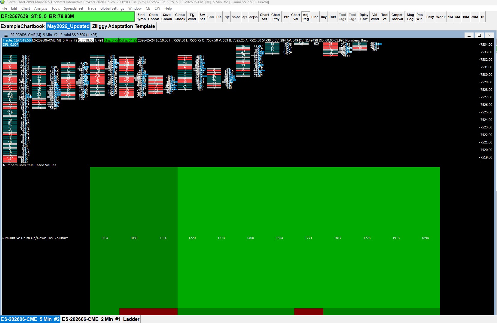

[2026-05-26 19:17:03]
trader884 - Posts: 2
Hi John, thank you for your quick response — really appreciated.
I've followed your advice and have the Numbers Bars Calculated Values study displaying in Chart Region 2 with two rows showing — Delta (SG1) and CVD (SG47) — with red/green background colouring working correctly.

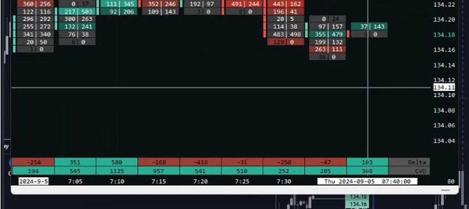

However, comparing my setup to the reference image I'm trying to replicate (both attached), they look completely different. In my setup the rows are very tall empty boxes with a single number floating in the middle. In the reference image the rows are compact — the same height as a single footprint cell — with the number filling the cell and sitting flush beneath the footprint bars, identical in style to the footprint cells themselves.
This leads me to wonder whether the Numbers Bars Calculated Values study is actually what produces the Delta and CVD rows in the reference image I'm seeking to emulate, or whether a completely different study or configuration is being used.
Could you take a look at both screenshots and confirm whether the Numbers Bars Calculated Values study should produce the compact appearance shown in the reference, and if so what I'm doing wrong?
Thank you again for your help.
imageNumbers Bars Calculated Valuesjpg.jpg / V - Attached On 2026-05-26 19:16:32 UTC - Size: 252.93 KB - 121 views
imageDelta and CVD Rows.jpg / V - Attached On 2026-05-26 19:16:45 UTC - Size: 125.93 KB - 119 views
[2026-05-26 22:14:38]
As we stated, this is due to the size of your region. You need to shrink the region size down by following one of the options given at the following link:
