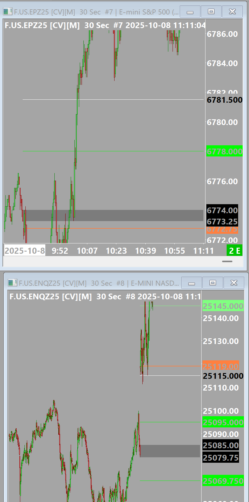

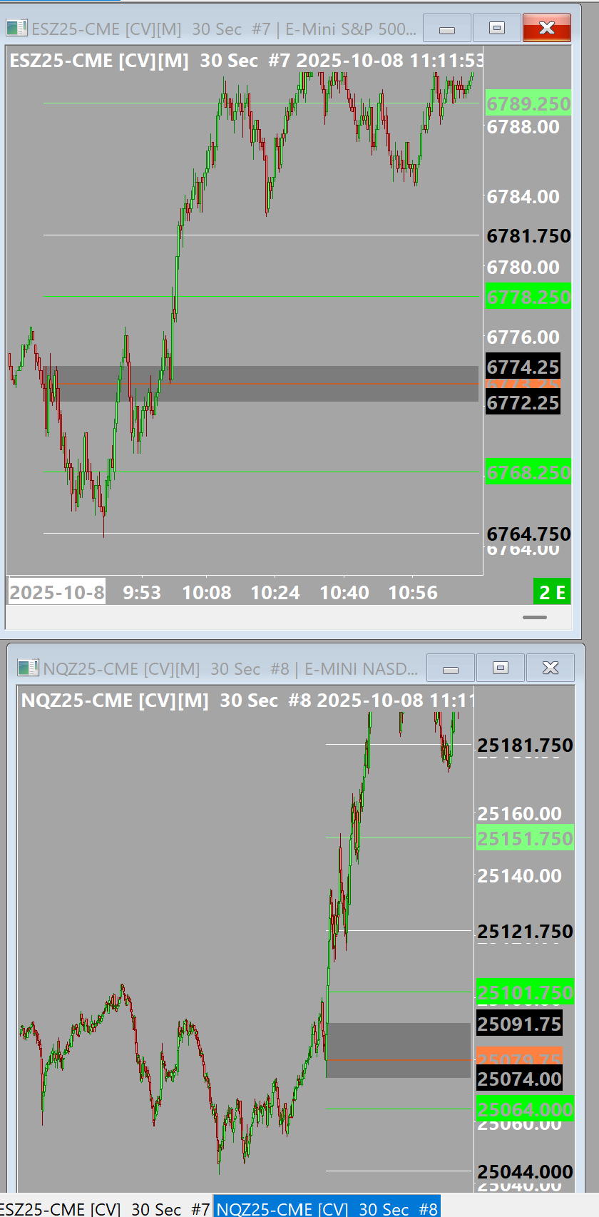

On the RTH equities open this morning at 9:30am EST, the data for the ES, NQ and RTY did not load in correctly. I am using the denali data feed with CQG routing. Why did this happen? When I switch to SC Data all, all data loads in correctly. When I switch back to CQG webapi, my data is not loading in correctly. It was not just me, happened for multiple users. I have attached two pictures for your reference. One being the CQG web api data not loading in correctly, then the SC Data showing how it should have been loaded in.
imageSC Data.png / V - Attached On 2025-10-08 15:12:44 UTC - Size: 101.05 KB - 177 views
imageCQG web api.png / V - Attached On 2025-10-08 15:12:52 UTC - Size: 86 KB - 240 views

[2025-10-08 17:46:49]
User415279 - Posts: 27
I have closed my system down, last message in my log is at 13:27:23, so I will not show anything for the 9:30 open. What you will see in the pictures attached in previous message is as follows. I have a high/low for time period extended. It populates the high/low for the first 30 seconds and the opening print. The H/L are in black, and the opening print in orange. The correct data is as follows: ES: 6774.25 High, 6772.25 Low, 6773.25 opening print. NQ: 25091.75 high, 25074 low, 25079.75 opening print, this populated on the SC data correctly. On the CQG webapi it populated as follows off the open: ES: 6774 high, 6773.25 low, 6772.75 opening print. NQ: 25085 high, 25079.75 low, 25119.00 opening print. System froze on the open, then had to disconnect and reconnect for feed to come back, but did not have any of the right data. I have fixed it by deleting and redownloading that data now, but I was wondering why it happened and how to avoid this issue in the future?

[2025-10-09 20:46:13]
Sierra_Chart Engineering - Posts: 25481
We are fairly sure this related to an interruption with one of the Internet carriers at that time.
You just need to re-download the data which you have done.
