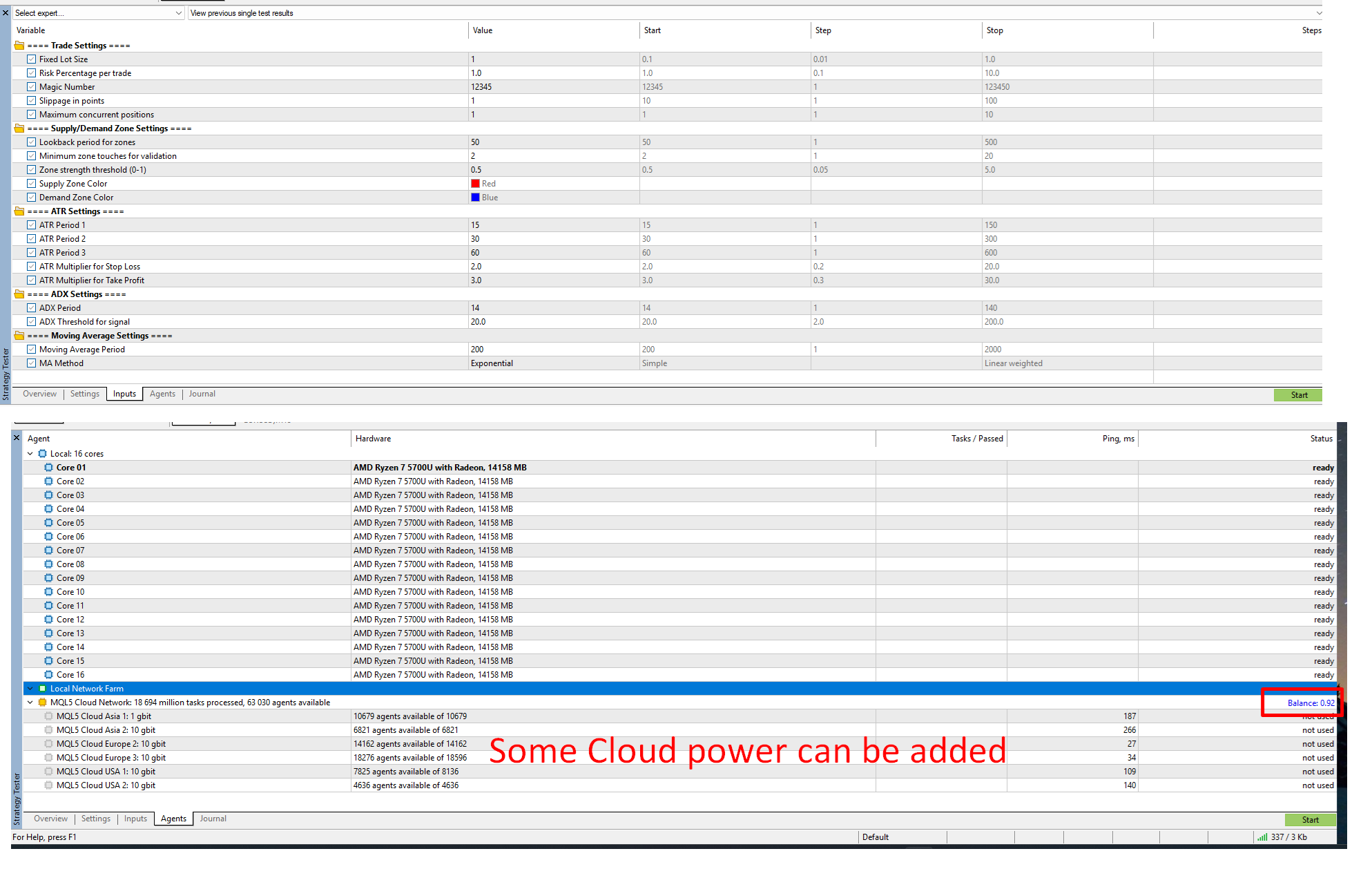

Thnx, im just wonderng does the custom study / bot makes all the calculations I require to make...
2. im asking abt optimization func. for the advanced custom study settings on SC. Like on MT5 > C attached.
thnx,

[2025-09-29 20:18:00]
The general rule is that the study is called whenever there is new data or an order update. But, you can force an additional update at each "Chart Update Interval" by setting the sc.UpdateAlways variable. Refer to the following:
ACSIL Interface Members - Variables and Arrays: sc.UpdateAlways
In the end, your study will get called often enough. If there is an issue, then most likely it is something in your code not doing what you are expecting.
We know nothing about MT5 and we do not pay attention to what other systems do. If you are looking for something specific, then we need to know what exactly it is. We have no idea what you are looking for in terms of "optimization".

Thank you, basically optimization func is making 1000-s of backtests (or replays) with different settings starting from one value, steps of values and final value * different parameters. Based on that making report ranking the best values targeted. Doable?
[2025-09-30 14:31:50]
This is not something we would do in relation to a custom study. The system does not know anything about your study and what parameters you would want to change.
It is fairly simple for you to do this yourself. You can have one study that controls the backtesting and adjusting parameters for another study. Refer to the following:
ACSIL Interface Members - Functions: sc.StartChartReplay()
ACSIL Interface Members - Functions: sc.SetChartStudyInputInt()
