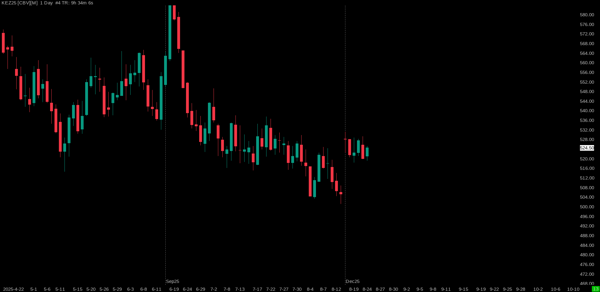

KEZ25 volume based back-adjusted continuous chart has a gap on rollover
https://www.sierrachart.com/image.php?Image=175612596311.png
Based on a recent support thread where you fixed ZC with a similar issue, I'm pretty certain it is KE's default Symbol Settings > Rollover Method that's causing this.
Also a question about what Rollover Method is:
For volume based rollover continuous charts, is the Rollover Method a fallback condition that triggers the roll if the next contract's volume does not surpass the previous contract's volume in time?

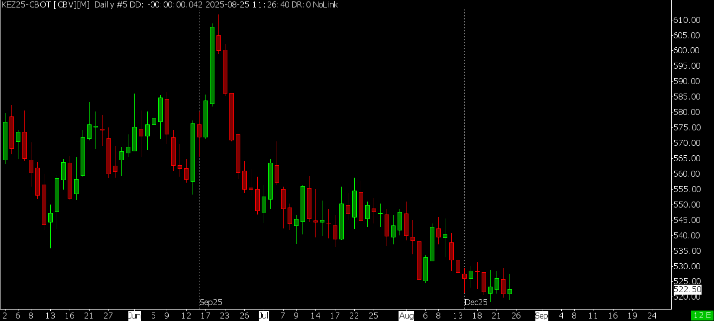

[2025-08-25 16:29:45]
We are not seeing an issue with this, so we do not think this is related to the other thread. Attached is an image of what we see for the Daily Historical data for KE.
We did initially see an issue with the Intraday data, where it was not lining up correctly, but we redownloaded the data and it was correct after that.
Therefore, please redownload the data by following these instructions and let us know if the problem is not corrected:

imageKEZ25-CBOT [CBV][M] Daily #5 2025-08-25 11~26~51.065.png / V - Attached On 2025-08-25 19:08:04 UTC - Size: 27.93 KB - 297 views
There's no attachment.
I'm redownloading all data for all my charts now for another reason, so I will compare when that's done
[2025-08-25 19:08:30]
Sorry, we added the image to post #2.
