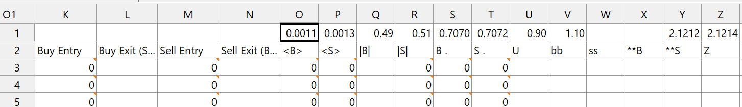

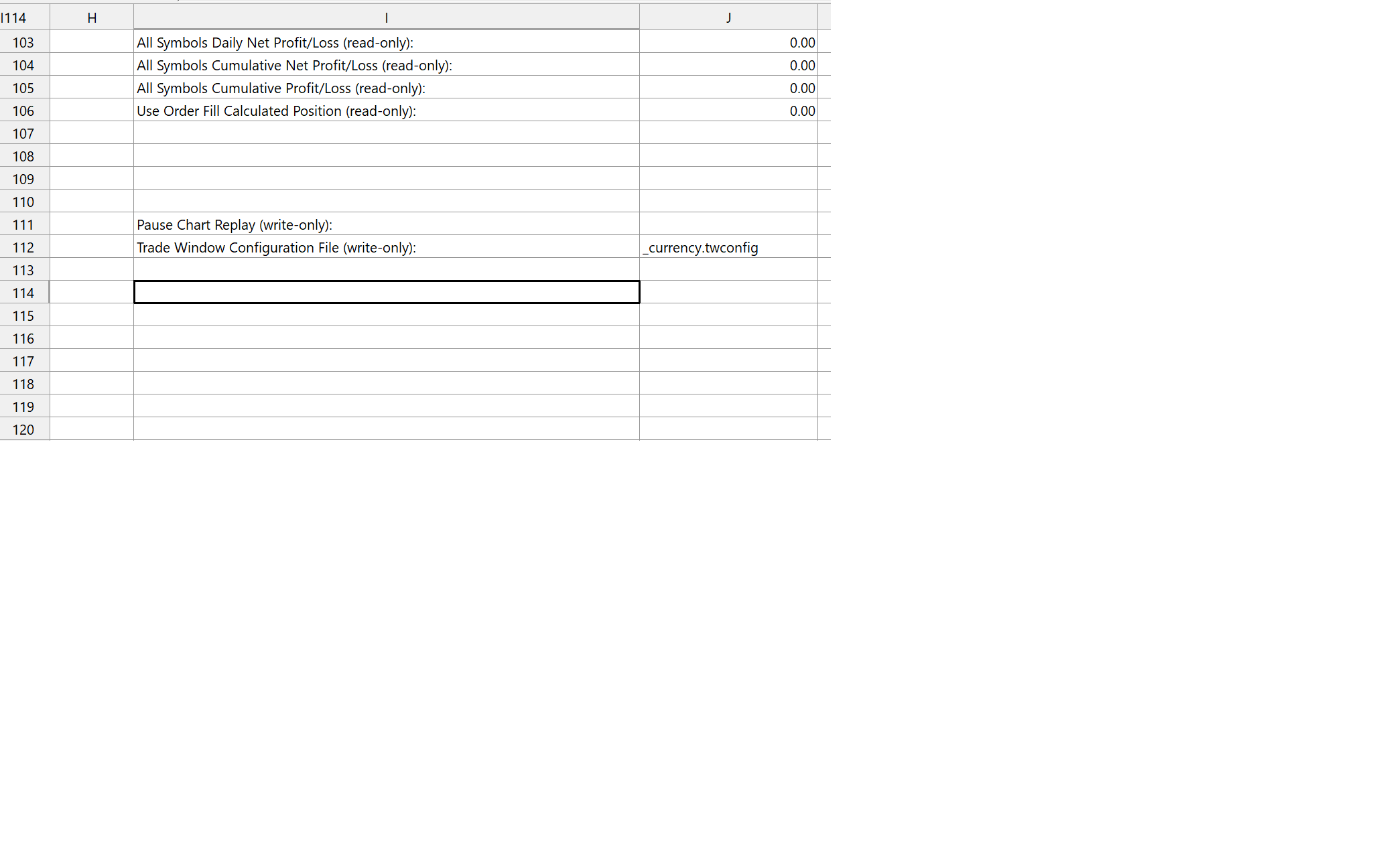

2garin - Posts: 189
if I understood your answer correctly.
constants should be written in columns I and J in rows below 114, right?
while waiting for an answer, I conducted an experiment: I wrote constants in cells O1-Z1, selected the number of decimal places, wrote a formula in cell R3, I refer to the cell with the constant using $ symbols from the formula, the formula works correctly.
question: is it acceptable to use this method, won't the table use (rewrite) the cells in the first row?

[2025-06-12 13:20:43]
Sawtooth - Posts: 4362
Row 1 of Formula Columns are free and open cells; they won't get overwritten.
IOW, only Rows 3 and below will auto-populate.
