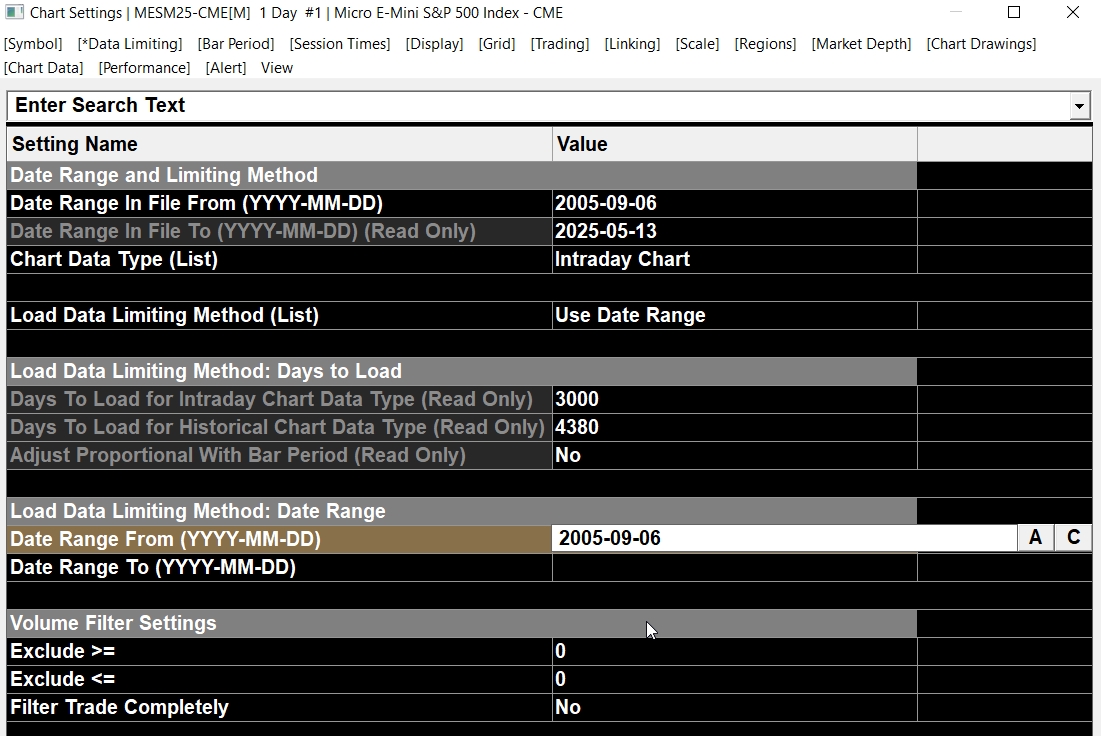

[2025-05-13 09:09:08]
User310606 - Posts: 2
Hi John, thanks for your help.
Yes I am trying to import the data into an existing symbol, MESM25-CME.
If I import using a random name such as MiniESM25 it works fine, but when I am using an existing symbol it wont display all the data.
In chart settings it says 'data range in file' 2005-09-06
If I try and select 2005-09-06 in ' Load data limiting Method: Date Range From' - it is defaulting to 2025-05-03
Is the any issue with importing years of continuous futures data onto the current existing symbol such as MESM25-CME?
image2025-05-13 09_48_36-Chart Settings _ MESM25-CME[M] 1 Day #.jpg / V - Attached On 2025-05-13 08:50:37 UTC - Size: 382.79 KB - 280 views
[2025-05-13 13:35:46]
We see you are on a trial. As such, we are surprised you were able to get this to work at all, as you are limited in the data you can use while on a trial. And the reason you can only view 10 days of data when you use the MESM25-CME symbol is due to the trial limitation. Refer to the following:
Sierra Chart Trial Account
