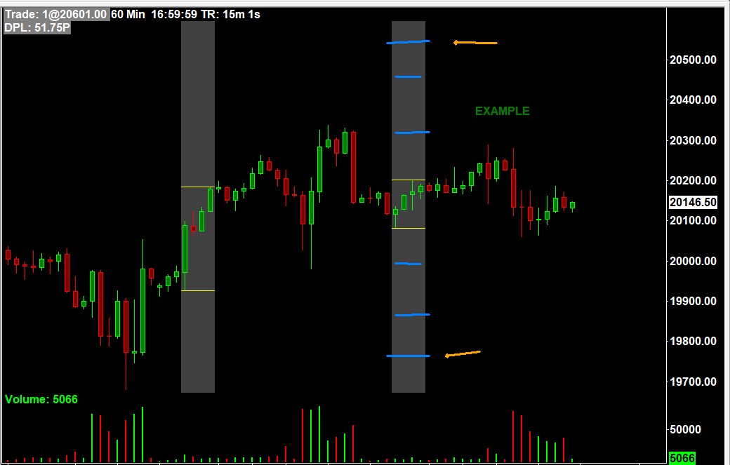

I would also like to know if the following is possible.
Currently i have my intraday data back to 5-10-2023, but once Monday comes i it will roll forward to 5-11-2023 is there any way to leave it at 5-10-2023 and just keep adding the new days that come?
(I want to set up 5 standard deviations up and down based on a specific high and low within a time range window. Is this possible and if so how?)
imageScreenshot 2025-05-10 094209.jpg / V - Attached On 2025-05-12 17:24:59 UTC - Size: 80.05 KB - 345 views

[2025-05-13 09:17:05]
User431178 - Posts: 910
This part was answered.
If this is a separate unrelated question, why the parentheses?
At a glance it reads as though the wanting to setup standard deviations up and down based on a specific high and low within a time range window is the reason for needing a specified data window to be loaded.
Anyway, the answer is yes, example of one method is attached.
Date Time Of Last Edit: 2025-05-13 09:17:17
attachmentRangeWithStandardDeviation.Cht - Attached On 2025-05-13 09:16:40 UTC - Size: 9.73 KB - 348 views
