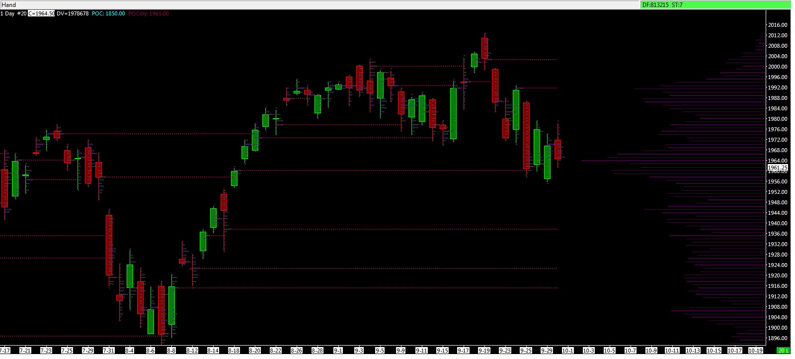

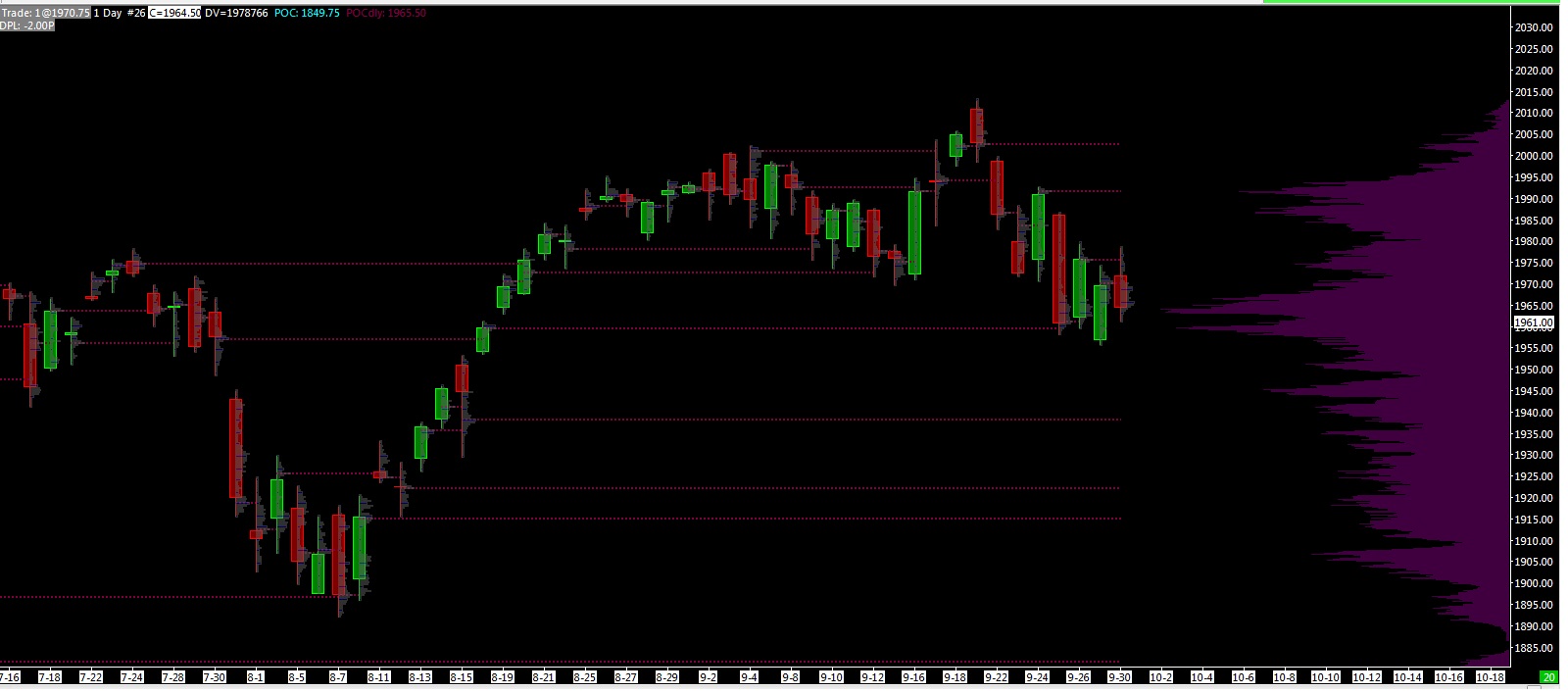

Without me doing anything (or at least not aware of having done anything), the volume profile on my key chart lost granularity. More precisely, it seems that it is now plotting volume bars every 5 ticks instead of every 1 tick, as it was and should (because that is how it is setup).
To illustrate my problem I am attaching two ES charts. Chart settings for each are identical. I have applied to both the same studies and settings (via a saved template). End result should be identical, but it is not. One is plotting volume profiles with 1 tick per volume bar, the way I have it setup. The other is not. This is the problem chart. I can't just delete it because it is my main chart where I have quite a few dozens lines drawn.
Would you know what could have happened?

[2014-09-30 21:55:07]
Set the Chart >> Chart Settings >> Volume at Price Multiplier to 1.
