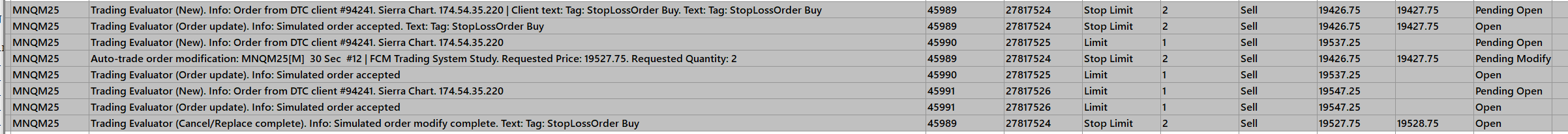

The trade activity log out related to order 45989 is shown below. I also attached a screen shot of the activity log to make it easier to view.
ActivityType  DateTime  TransDateTime  Symbol  OrderActionSource  InternalOrderID  ServiceOrderID  OrderType  Quantity  BuySell  Price  Price2  OrderStatus  FillPrice  FilledQuantity  TradeAccount  OpenClose  ParentInternalOrderID  PositionQuantity  FillExecutionServiceID  HighDuringPosition  LowDuringPosition  Note  AccountBalance  ExchangeOrderID  ClientOrderID  TimeInForce  Username  IsAutomated
Orders  2025-04-30 01:11:26.060051  2025-04-30 01:11:26.060032  MNQM25  Trading Evaluator (New). Info: Order from DTC client #94241. Sierra Chart. 174.54.35.220 | Client text: Tag: StopLossOrder Buy. Text: Tag: StopLossOrder Buy  45989  27817524  Stop Limit  2  Sell  19426.75  19427.75  Pending Open      fcm_ldt  Close    2        StopLossOrder Buy  0.00    45989.89569  Good till Canceled  Richard Novak  Y
Orders  2025-04-30 01:11:26.060093  2025-04-30 01:11:26.060091  MNQM25  Trading Evaluator (Order update). Info: Simulated order accepted. Text: Tag: StopLossOrder Buy  45989  27817524  Stop Limit  2  Sell  19426.75  19427.75  Open      fcm_ldt  Close    2        StopLossOrder Buy  0.00  27817524  45989.89569  Good till Canceled  Richard Novak  Y
Orders  2025-04-30 01:11:26.060103  2025-04-30 01:11:26.060102  MNQM25  Trading Evaluator (New). Info: Order from DTC client #94241. Sierra Chart. 174.54.35.220  45990  27817525  Limit  1  Sell  19537.25    Pending Open      fcm_ldt  Close    2          0.00    45990.97473  Good till Canceled  Richard Novak  Y
Orders  2025-04-30 01:11:26.213169  2025-04-30 01:11:26.213166  MNQM25  Auto-trade order modification: MNQM25[M] 30 Sec #12 | FCM Trading System Study. Requested Price: 19527.75. Requested Quantity: 2  45989  27817524  Stop Limit  2  Sell  19426.75  19427.75  Pending Modify      fcm_ldt  Close    2        StopLossOrder Buy  0.00  27817524  45989.89569  Good till Canceled  Richard Novak  Y
Orders  2025-04-30 01:11:26.275828  2025-04-30 01:11:26.275822  MNQM25  Trading Evaluator (Order update). Info: Simulated order accepted  45990  27817525  Limit  1  Sell  19537.25    Open      fcm_ldt  Close    2          0.00  27817525  45990.97473  Good till Canceled  Richard Novak  Y
Orders  2025-04-30 01:11:26.275888  2025-04-30 01:11:26.275886  MNQM25  Trading Evaluator (New). Info: Order from DTC client #94241. Sierra Chart. 174.54.35.220  45991  27817526  Limit  1  Sell  19547.25    Pending Open      fcm_ldt  Close    2          0.00    45991.51616  Good till Canceled  Richard Novak  Y
Orders  2025-04-30 01:11:26.275920  2025-04-30 01:11:26.275919  MNQM25  Trading Evaluator (Order update). Info: Simulated order accepted  45991  27817526  Limit  1  Sell  19547.25    Open      fcm_ldt  Close    2          0.00  27817526  45991.51616  Good till Canceled  Richard Novak  Y
Orders  2025-04-30 01:11:26.276063  2025-04-30 01:11:26.276061  MNQM25  Trading Evaluator (Cancel/Replace complete). Info: Simulated order modify complete. Text: Tag: StopLossOrder Buy  45989  27817524  Stop Limit  2  Sell  19527.75  19528.75  Open      fcm_ldt  Close    2        StopLossOrder Buy  0.00  27817524  45989.89569  Good till Canceled  Richard Novak  Y

imageActivity Log Screen Capture.PNG / V - Attached On 2025-04-30 06:38:30 UTC - Size: 48.3 KB - 239 views
