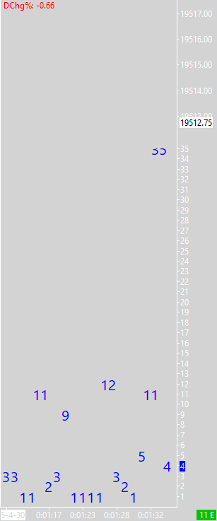

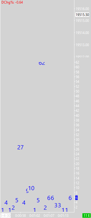

I am displaying volume in Chart region 2 but instead of doing bars, I am using the Draw Style "Value of Subgraph".
The problem I am facing is, the value printing at boundary of Main chart and volume indicator is getting cut into half.
How do I correct this?
I am attaching a couple of examples to show how this looks like.
image8jAetcb48i.png / V - Attached On 2025-04-30 05:04:38 UTC - Size: 10.18 KB - 265 views
imagebytGZexDjz.png / V - Attached On 2025-04-30 05:04:43 UTC - Size: 10.96 KB - 292 views
imagezpEUwpPk1Z.png / V - Attached On 2025-04-30 05:05:12 UTC - Size: 10.7 KB - 306 views

I see 2 things with the 2nd one .
1- The 62 is at the top of the scale, and you either need to add a % to the top and bottom of the scale range or increase the scale range.
2 - the number are cutting the prior one off either because you are using too large a font or you need to increase the bar spacing to allow fo a large font.
Hope this helps,
