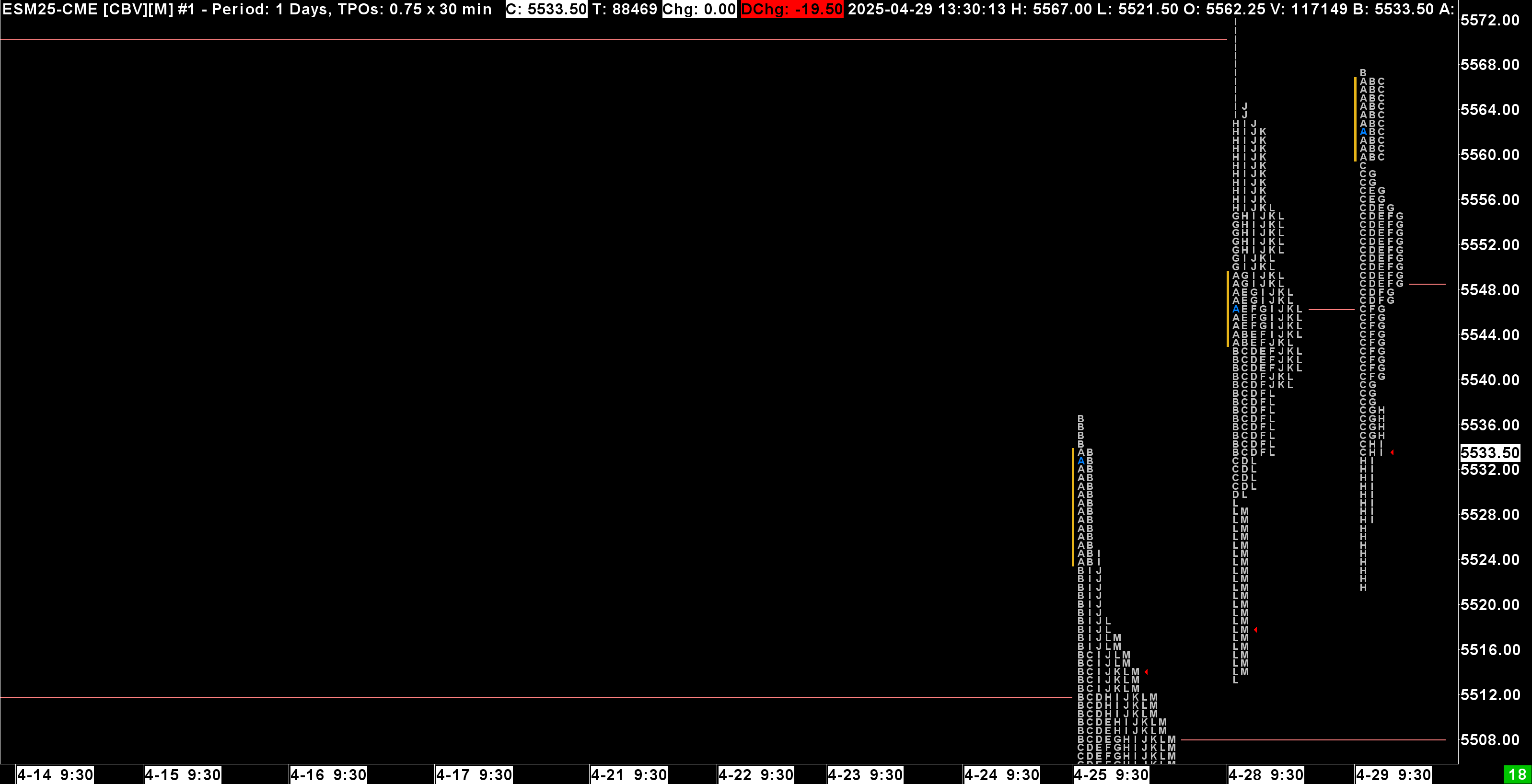

jkaneutah - Posts: 8
Sorry don't mean to spam you, but when I opened my chart at 0815 CDT this morning, it was already on the H period. Then at 0840 just as I was getting ready to upload the chart image, it switched to the I period. I looked at the chart settings and session times and I think those are ok, but I'm just not sure what I'm missing here. I super appreciate your help.
[2025-04-29 14:44:45]
Your image shows your TPO starting time as 09:30 for the chart. If the Time Zone of your chart is the same as your actual time, then this would mean that at 08:15 you would be looking at the end of session that started the previous day.

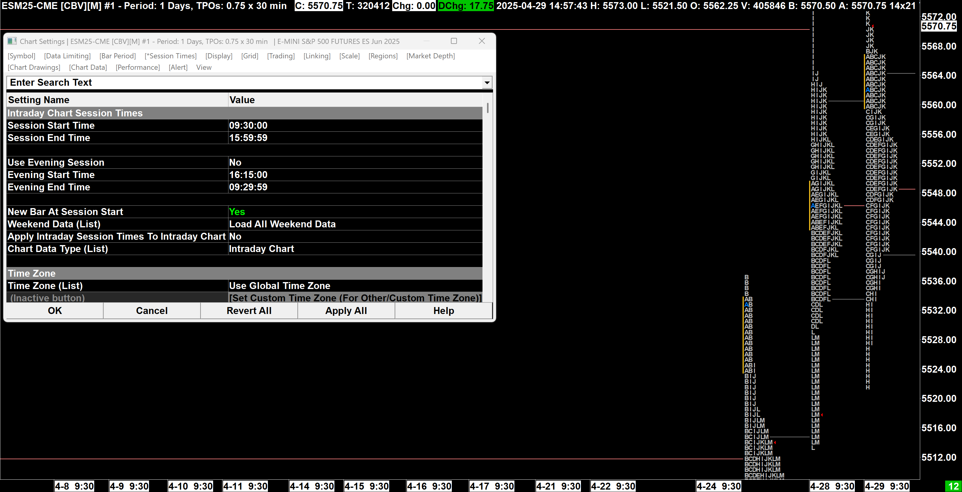

[2025-04-29 15:16:17]
https://www.sierrachart.com/image.php?Image=1745939275868.png
I took the screenshot in #6 at 0840 CDT. This new screenshot I am adding I just barely took with the overlay of the settings.
The TPO study in that chartbook in question now disappeared. The chartbook itself exists, but when I went to open it, it was blank. So I've duplicated it again, now "chartbook2", and added a screenshot that should contain the information you asked for. I have messed with the time zones, but nothing but nothing has helped. And my computer is on the correct date/time zone.
Not to muddy the waters, but there are other charts within the same chartbook that are doing something weird whenever I open Sierra Chart. I may try to create a new chartbook from scratch and see if that helps, but I'm not sure which settings to change at this point.
attachmentChartbook2.Cht - Attached On 2025-04-29 15:08:25 UTC - Size: 4.51 KB - 329 views
[2025-04-29 15:52:43]
I think I fixed the time zone issue, whenever I would change it to "Chicago" (CST/CDT), enter the start and end times, and hit apply, it would also change the time I had entered to something completely off. So I had to change the time zone to Chicago, change the time manually, and hit "OK" rather than "apply". Because again, if I hit "apply", it changed the time to something different than what I had manually entered if that makes any sense. But my letter blocks seem to be on the right time now, but just 10 minutes delayed and I think that makes sense with my service package.
Thanks again for taking the time to look into this, I probably should have tried just a touch harder to figure it out before sending it up.
[2025-04-29 18:55:28]
We figured it had something to do with the Time Zone as the times in the chart did not make sense relative to your local time.
It is normal that if you change the Time Zone, the Session Times will adjust to reflect that new Time Zone. Therefore, you may have to then adjust the actual Session Times for the selected Time Zone.
Unless you have some reason for using multiple time zones, we recommend setting your "Global Time Zone" (Global Settings >> Time Zone) to the time zone you want for all charts. Then make sure all the charts have their Time Zone set to "Use Global Time Zone".
