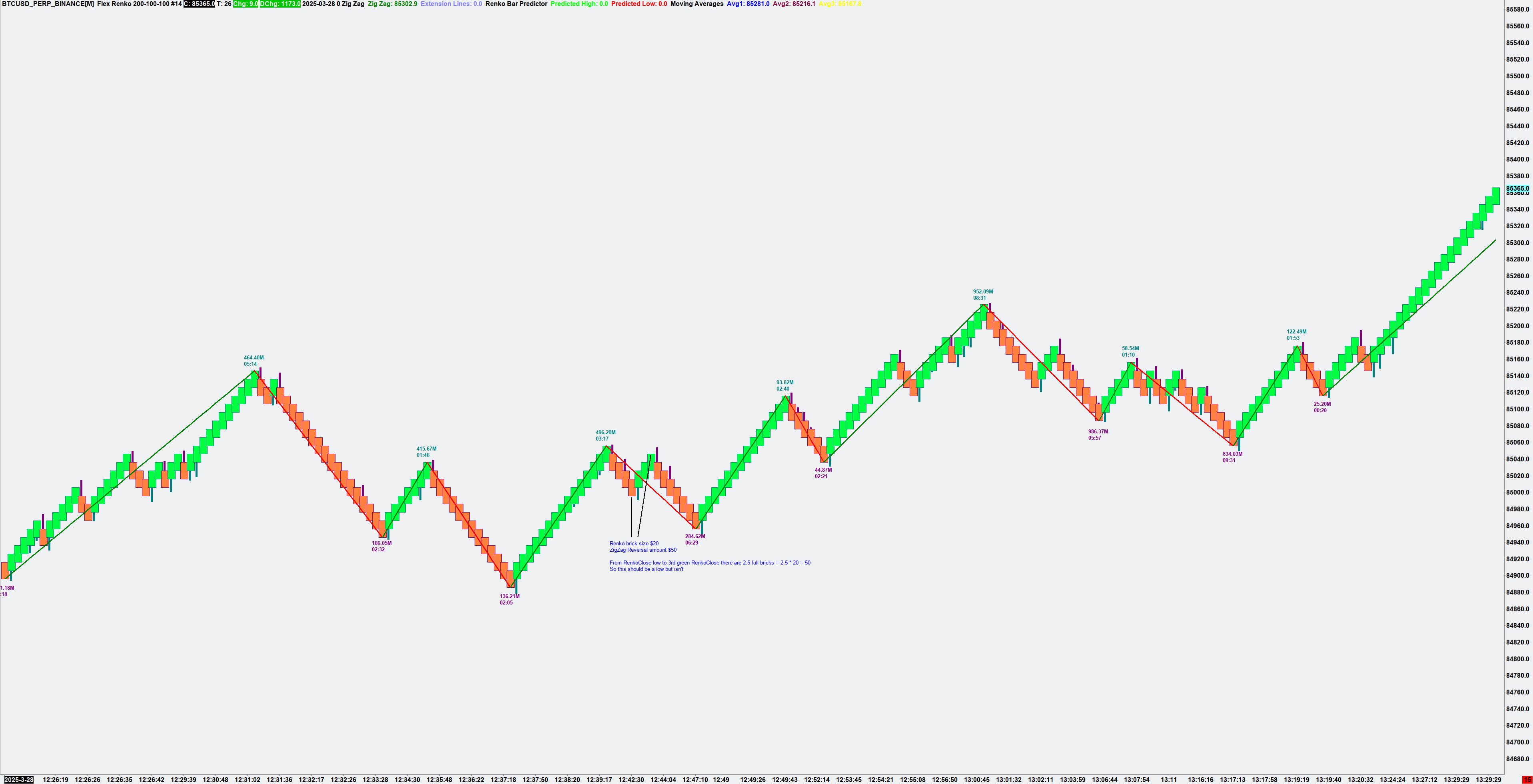

Example 1:
- Renko brick size: $20
- ZigZag Reversal amount: $50
- From low point to 3rd green Renko close: exactly 2.5 bricks = $50
- Expected: A node should be created at the low point
- Actual: No node is created
- https://www.sierrachart.com/image.php?Image=1745590873605.png

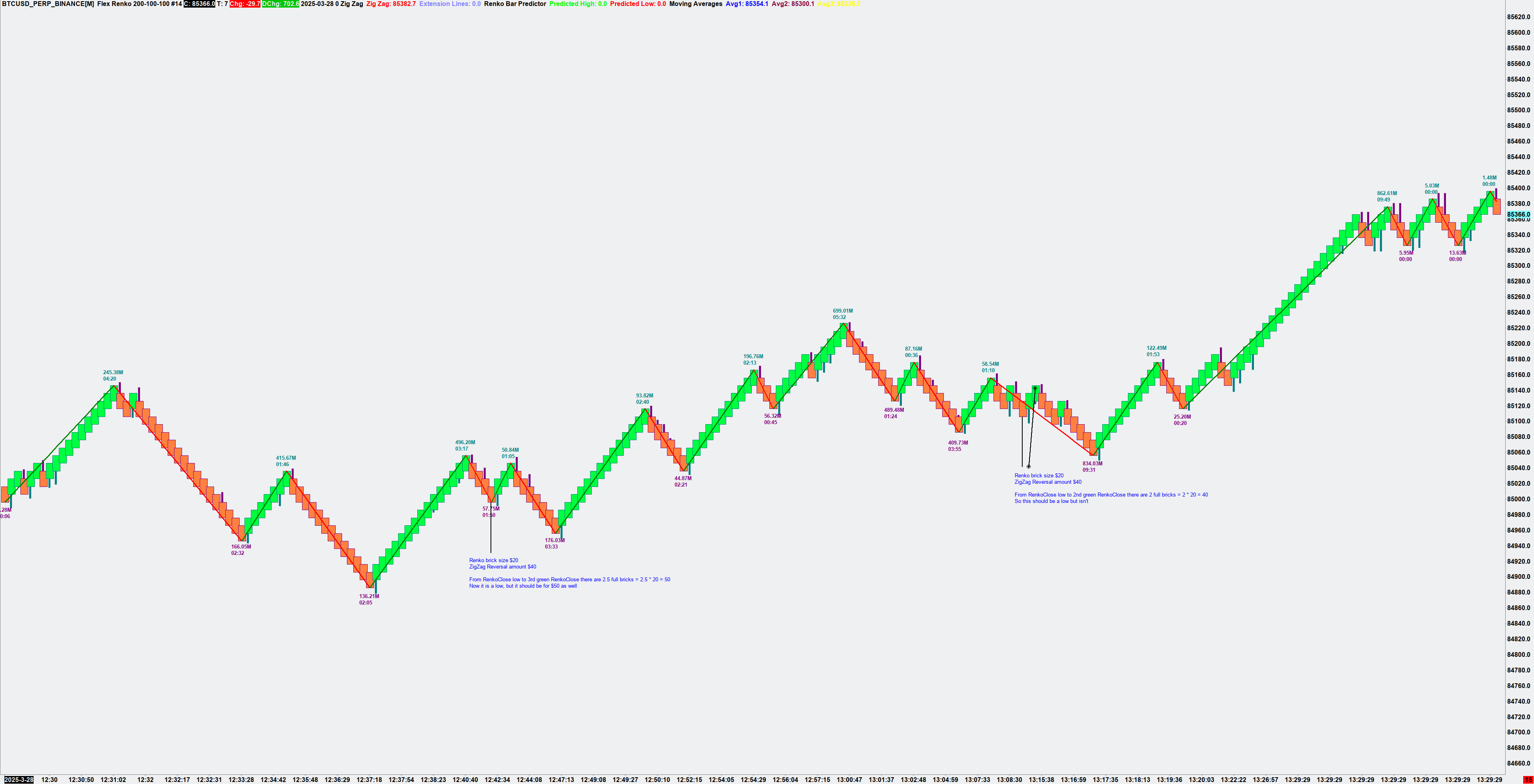

Example 2:
- ZigZag Reversal amount: $40
- From low point to 2nd green Renko close: exactly 2 bricks = $40
- https://www.sierrachart.com/image.php?Image=1745591289741.png
Settings used:
- Zig Zag Input Data: Renko Close
- Number of Bars Required for Reversal: 1
Workaround found:
Using reversal amounts slightly less than the target value (e.g., 49.9 instead of 50, 39.9 instead of 40) creates nodes as expected.
This suggests the ZigZag2 built-in function might be using a "greater than" comparison instead of "greater than or equal to" when checking if a price movement qualifies as a reversal.
Could the ZigZag2 function be modified to recognize price movements that equal the exact reversal amount?
This would make zigzag behavior more predictable when used with Renko charts where price movements occur in precise brick increments.
