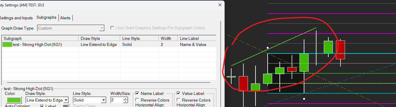

I am trying a simple graph
SCSubgraphRef StrongLines = sc.Subgraph[0];
StrongLines.Name = "Test";
StrongLines.PrimaryColor = RGB(100,200,300);
StrongLines.LineWidth = 2;
StrongLines.DrawStyle = DRAWSTYLE_LINE_EXTEND_TO_EDGE;
int idx1 = sc.ArraySize - 10;
int idx2 = sc.ArraySize - 3;
StrongLines[idx1] = sc.High[idx1];
StrongLines[idx2] = sc.High[idx2];
Just draw a line, not a ray as expected. Is it supported or I am doing something wrong?

[2025-04-28 11:08:26]
We are not understanding this. We do not know from the chart image, what that study is drawing.
[2025-04-28 19:52:00]
man2002ua - Posts: 3
Sorry for misunderstanding.
I want SCSubgraph to draw a horizontal line to the right edge, similar behaviour as s_UseTool DrawingType = DRAWING_RAY;
But in example above it draws the line between two points only.
Question - what is missing?
[2025-04-29 13:51:57]
The "Line Extend to Edge" takes the value of the study at the current bar and extends that to the edge. In your example, that value is 0, so you are not actually seeing it extend to the edge.
To do what you want, you would have to include specific information for the remaining bars in the chart and then the line will extend to the edge.
