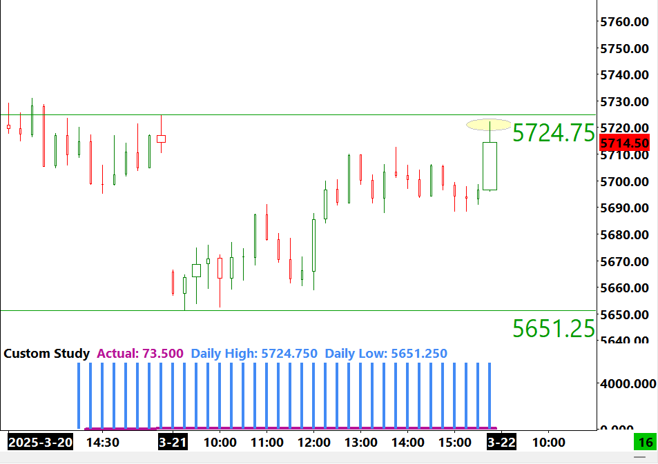

I'm using sc.DailyHigh and sc.DailyLow to compute the current day's range.
However, I noticed that these values refer to the prior session's high or low at the open of a new day.
How can these values be reset at the start of the next trading session?
I've attached a couple of screenshots of the test I ran.
I have a study where Actual is the current day's range.
Daily High and Daily Low are the sc.DailyHigh and sc.DailyLow variables stored in subgraphs.
The Actual value is computed as the difference between the sc.DailyHigh and sc.DailyLow stored in a variable then stored in the subgraph.
Looking at Screenshot 1 you can see the Actual has a value of 73.50. However, the Daily High of 5724.75 is the high of the last bar prior to the start of the current session.

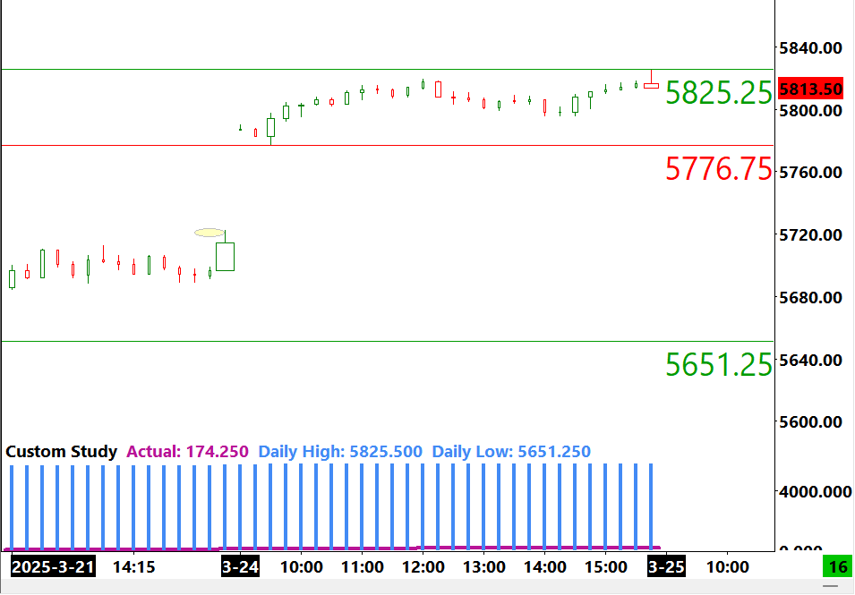

Viewing Screenshot 2, the Actual value is 174.25 because the Daily Low is still set to the prior session's Daily Low of 5651.25. The actual Daily Low for the current session is 5776.75.
This creates an inaccurate Actual daily range value.
Is there a method that resets these values at the start of the session?
imageDailyRangeError1.png / V - Attached On 2025-04-18 02:22:17 UTC - Size: 26.77 KB - 417 views
imageDailyRangeError2.png / V - Attached On 2025-04-18 02:22:26 UTC - Size: 24.7 KB - 389 views

Regarding post #1, those values come from the real-time data feed. So if you are looking at a CME symbol and we do not know what symbol you are looking at, then they are what are transmitted by the CME data feed.
There is definitively no problem with them. There could not be.
And the screenshots you attached did not follow our rules:
And this is an exceptionally good example of where you are hiding important information.

Gradient - Posts: 219
I’m confused.
What information could be hid and for what reason? There’s no benefit to hiding information when seeking a resolution to an issue.
Check my posts. I’ve used the same method of uploading screenshots with no issues.
The study is simple. Take the difference between sc.DailyHigh and sc.DailyLow and store it in a variable (ie range).
Store that variable in a subgraph.
Store the raw values of sc.DailyHigh and sc.DailyLow in subgraphs.
The instrument is the ES.
What other information could alter this process? There’s no trading signals being generated. Simply attempting to compute the developing daily range.
Could the data feed used affect the values? For example if Rithmic is used vs Teton. That seems more plausible given the study isn’t very complex.
Another consideration is that this was during a replay.
At any rate the implementation in the second post resolves the issue.

We are not able to see the symbol of the chart. We are not able to see the most recent timestamp of the chart which will be on the header line. Although the specifications do not say that needs to be shown. But usually we can see it.
We do not see the chart bar timeframe.
This is the problem:
The daily high and low, do not reset during a chart replay.
If the header was included as the instructions specify for posting an image of a chart, we would have seen there is a chart replay.
