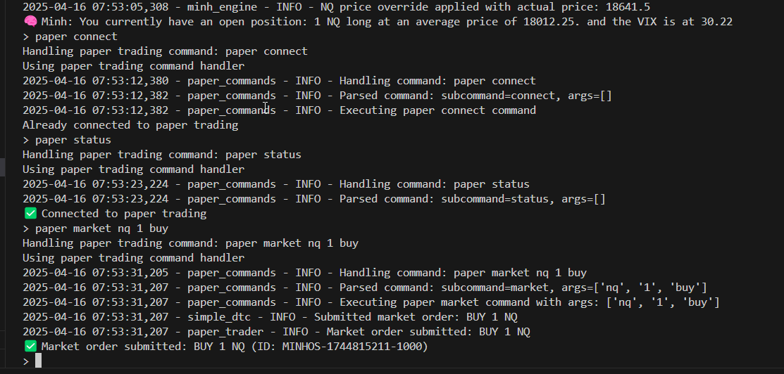

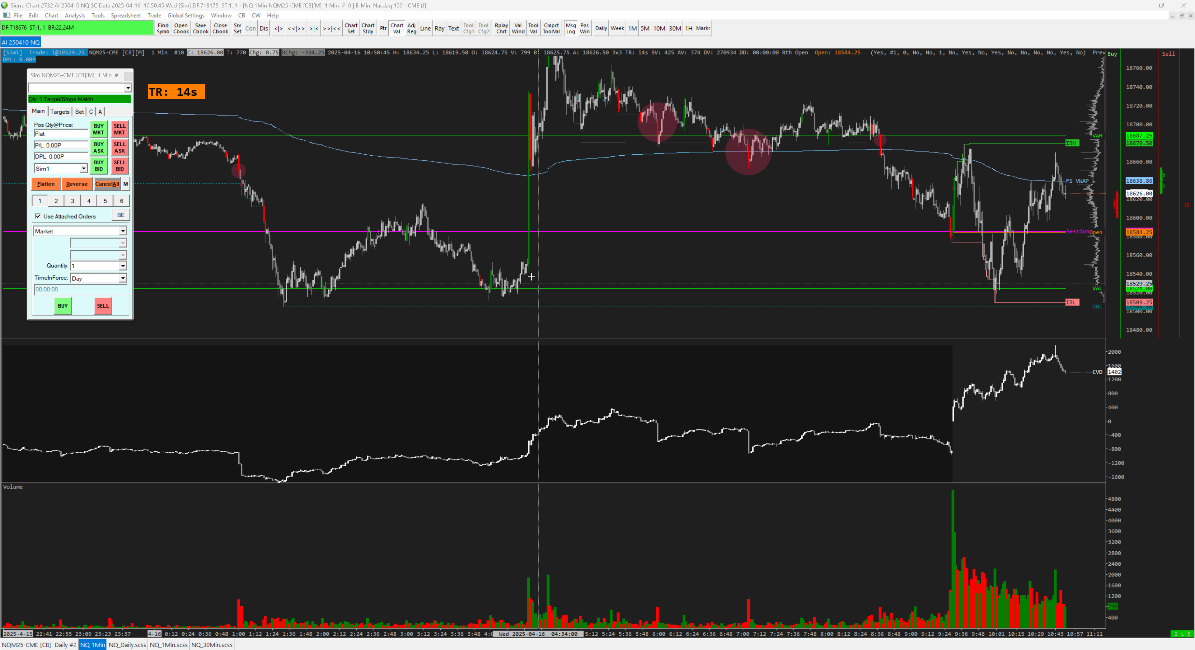

Hello Sierra Chart Support,
I've successfully implemented a DTC Protocol client that connects to Sierra Chart and can submit orders. The logs on both sides confirm the connection is working correctly:
- My application logs show successful connection to the DTC server
- Sierra Chart logs show receiving the messages, including order submissions
- Sierra Chart acknowledges the orders with "Received unknown message type from client. Type = 3001"
The issue I'm facing is that while the DTC communication works, the paper trading orders submitted through DTC Protocol don't appear in the Trading DOM interface or anywhere else in Sierra Chart's UI.
In my order submission, I'm including:
- IsSimulated: 1
- IsAutomatedOrder: 1
- TradeAccount: "SIM"
What specific configuration is needed to have Sierra Chart display paper trading orders submitted via DTC Protocol in the Trading DOM interface? Is there a specific account designation required or settings that need to be enabled?
Thank you for your assistance.

PS D:\minh_os> python minh.py
2025-04-17 09:26:47 - minh_os - INFO - Initializing Minh OS...
2025-04-17 09:26:47 - symbol_manager - INFO - Added symbol: ES
2025-04-17 09:26:47 - symbol_manager - INFO - Added symbol: NQ
2025-04-17 09:26:47 - symbol_manager - INFO - Added symbol: VIX
2025-04-17 09:26:47 - risk_manager - INFO - Daily risk metrics reset
2025-04-17 09:26:47 - minh_os - INFO - Minh OS starting...
2025-04-17 09:26:47 - minh_os - INFO - Connecting to DTC server...
2025-04-17 09:26:47 - dtc_client - INFO - Connected to localhost:11099
2025-04-17 09:26:47 - minh_os - INFO - Subscribed to ES
2025-04-17 09:26:47 - minh_os - INFO - Subscribed to NQ
2025-04-17 09:26:47 - dtc_client - ERROR - Error sending message: a bytes-like object is required, not 'dict'
2025-04-17 09:26:47 - order_manager - ERROR - Failed to send trading accounts request
2025-04-17 09:26:48 - dtc_client - ERROR - Cannot send message: Not connected
2025-04-17 09:26:48 - order_manager - ERROR - Failed to send open orders request
2025-04-17 09:26:48 - order_manager - ERROR - Failed to send positions request
2025-04-17 09:26:48 - minh_os - INFO - Minh OS running, press Ctrl+C to exit
2025-04-17 09:26:53 - minh_os - INFO - Running trading test...
2025-04-17 09:26:53 - minh_os - INFO - Placing test order for ES
2025-04-17 09:26:53 - dtc_client - ERROR - Cannot send message: Not connected
2025-04-17 09:26:53 - order_manager - ERROR - Failed to submit order for ES
2025-04-17 09:26:53 - minh_os - ERROR - Failed to submit order for ES
2025-04-17 09:26:53 - minh_os - WARNING - DTC client disconnected, attempting to reconnect...
2025-04-17 09:26:53 - minh_os - INFO - Connecting to DTC server...
2025-04-17 09:26:53 - dtc_client - INFO - Connected to localhost:11099
2025-04-17 09:26:53 - minh_os - INFO - Subscribed to ES
2025-04-17 09:26:53 - minh_os - INFO - Subscribed to NQ
2025-04-17 09:26:53 - dtc_client - ERROR - Error sending message: a bytes-like object is required, not 'dict'
2025-04-17 09:26:53 - order_manager - ERROR - Failed to send trading accounts request
2025-04-17 09:26:54 - dtc_client - ERROR - Cannot send message: Not connected
2025-04-17 09:26:54 - order_manager - ERROR - Failed to send open orders request
2025-04-17 09:26:54 - order_manager - ERROR - Failed to send positions request
2025-04-17 09:26:54 - minh_os - INFO - Reconnected successfully
2025-04-17 09:26:54 - minh_os - INFO - Connected: False, Subscribed symbols: 2
2025-04-17 09:26:55 - dtc_client - WARNING - Connection closed by server
2025-04-17 09:26:59 - minh_os - WARNING - DTC client disconnected, attempting to reconnect...
2025-04-17 09:26:59 - minh_os - INFO - Connecting to DTC server...
2025-04-17 09:26:59 - dtc_client - INFO - Connected to localhost:11099
2025-04-17 09:26:59 - minh_os - INFO - Subscribed to ES
2025-04-17 09:26:59 - minh_os - INFO - Subscribed to NQ
2025-04-17 09:26:59 - dtc_client - ERROR - Error sending message: a bytes-like object is required, not 'dict'
2025-04-17 09:26:59 - order_manager - ERROR - Failed to send trading accounts request
2025-04-17 09:27:00 - dtc_client - ERROR - Cannot send message: Not connected
2025-04-17 09:27:00 - order_manager - ERROR - Failed to send open orders request
2025-04-17 09:27:00 - order_manager - ERROR - Failed to send positions request
2025-04-17 09:27:00 - minh_os - INFO - Reconnected successfully
2025-04-17 09:27:00 - minh_os - INFO - Connected: False, Subscribed symbols: 2
2025-04-17 09:27:01 - dtc_client - WARNING - Connection closed by server
2025-04-17 09:27:05 - minh_os - WARNING - DTC client disconnected, attempting to reconnect...
2025-04-17 09:27:05 - minh_os - INFO - Connecting to DTC server...
2025-04-17 09:27:05 - dtc_client - INFO - Connected to localhost:11099
2025-04-17 09:27:05 - minh_os - INFO - Subscribed to ES
2025-04-17 09:27:05 - minh_os - INFO - Subscribed to NQ
2025-04-17 09:27:05 - dtc_client - ERROR - Error sending message: a bytes-like object is required, not 'dict'
2025-04-17 09:27:05 - order_manager - ERROR - Failed to send trading accounts request
2025-04-17 09:27:06 - dtc_client - ERROR - Cannot send message: Not connected
2025-04-17 09:27:06 - order_manager - ERROR - Failed to send open orders request
2025-04-17 09:27:06 - order_manager - ERROR - Failed to send positions request
2025-04-17 09:27:06 - minh_os - INFO - Reconnected successfully
2025-04-17 09:27:06 - minh_os - INFO - Connected: False, Subscribed symbols: 2
2025-04-17 09:27:07 - dtc_client - WARNING - Connection closed by server
2025-04-17 09:27:11 - minh_os - WARNING - DTC client disconnected, attempting to reconnect...
2025-04-17 09:27:11 - minh_os - INFO - Connecting to DTC server...
2025-04-17 09:27:11 - dtc_client - INFO - Connected to localhost:11099
2025-04-17 09:27:11 - minh_os - INFO - Subscribed to ES
2025-04-17 09:27:11 - minh_os - INFO - Subscribed to NQ
2025-04-17 09:27:11 - dtc_client - ERROR - Error sending message: a bytes-like object is required, not 'dict'
2025-04-17 09:27:11 - order_manager - ERROR - Failed to send trading accounts request
2025-04-17 09:27:12 - dtc_client - ERROR - Cannot send message: Not connected
2025-04-17 09:27:12 - order_manager - ERROR - Failed to send open orders request
2025-04-17 09:27:12 - order_manager - ERROR - Failed to send positions request
2025-04-17 09:27:12 - minh_os - INFO - Reconnected successfully
2025-04-17 09:27:12 - minh_os - INFO - Connected: False, Subscribed symbols: 2
2025-04-17 09:27:17 - minh_os - WARNING - DTC client disconnected, attempting to reconnect...
2025-04-17 09:27:17 - minh_os - INFO - Connecting to DTC server...
2025-04-17 09:27:17 - dtc_client - INFO - Connected to localhost:11099
2025-04-17 09:27:17 - minh_os - INFO - Subscribed to ES
2025-04-17 09:27:17 - minh_os - INFO - Subscribed to NQ
2025-04-17 09:27:17 - dtc_client - ERROR - Error sending message: a bytes-like object is required, not 'dict'
2025-04-17 09:27:17 - order_manager - ERROR - Failed to send trading accounts request
2025-04-17 09:27:18 - dtc_client - ERROR - Cannot send message: Not connected
2025-04-17 09:27:18 - order_manager - ERROR - Failed to send open orders request
2025-04-17 09:27:18 - order_manager - ERROR - Failed to send positions request
2025-04-17 09:27:18 - minh_os - INFO - Reconnected successfully
2025-04-17 09:27:18 - minh_os - INFO - Connected: False, Subscribed symbols: 2
2025-04-17 09:27:23 - minh_os - WARNING - DTC client disconnected, attempting to reconnect...
2025-04-17 09:27:23 - minh_os - INFO - Connecting to DTC server...
2025-04-17 09:27:23 - dtc_client - INFO - Connected to localhost:11099
2025-04-17 09:27:23 - minh_os - INFO - Subscribed to ES
2025-04-17 09:27:23 - minh_os - INFO - Subscribed to NQ
2025-04-17 09:27:23 - dtc_client - ERROR - Error sending message: a bytes-like object is required, not 'dict'
2025-04-17 09:27:23 - order_manager - ERROR - Failed to send trading accounts request
2025-04-17 09:27:24 - dtc_client - ERROR - Cannot send message: Not connected
2025-04-17 09:27:24 - order_manager - ERROR - Failed to send open orders request
2025-04-17 09:27:24 - order_manager - ERROR - Failed to send positions request
2025-04-17 09:27:24 - minh_os - INFO - Reconnected successfully
2025-04-17 09:27:24 - minh_os - INFO - Connected: False, Subscribed symbols: 2
