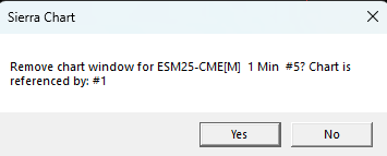

When you close a chart you are queried if you really want to close it. If the chart is referenced by another (such as a Study/Price Overlay) then it will state this in that query. See the attached image that shows this.
imageScreenshot 2025-04-23 100409.png / V - Attached On 2025-04-23 15:04:42 UTC - Size: 5.11 KB - 276 views
