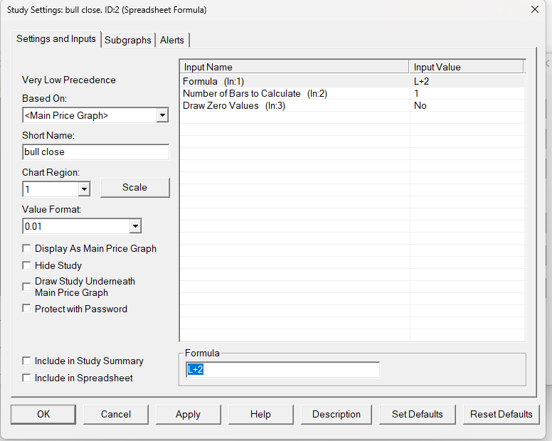

I need to retrieve the chart bar period value in a spreadsheet formula study dynamically. I mean that, look at this example:
- on image 1 you can notice that the bar period value is 20
- on my spreadsheet formula study, I need to add this value at the low of the bar. Look at Image 2
The question is: is there a way to add this value dynamically and not manually as I did in this case, putting L+2, but putting something like L + chart_bar_period
Thank you.
Kindly,
imageimage 2.png / V - Attached On 2025-03-24 16:44:15 UTC - Size: 36.83 KB - 289 views
imageimage 1.png / V - Attached On 2025-03-24 16:44:19 UTC - Size: 64.7 KB - 300 views

The Spreadsheet Study has fields in the I/J columns for the Bar Period. Refer to the following and the 3 items below it:
Spreadsheet Systems, Alerts and Automated Trading: Seconds Per Bar - Intraday (read-only) [v1:J36]
You would need to reference the appropriate J column entry into one of the Formula columns so you could then pick that up and display it as you want - most likely using the "Study Subgraph Above/Below Bar as Text" from what you state. But also refer to the "Text Display for Study" study:

Sawtooth - Posts: 4362
It can't be done with the Spreadsheet Formula study.
(Despite its name, it's not a spreadsheet study.)
Use the Spreadsheet Study study:
Cell J39 returns the range of range bars, in ticks.
To get it to a subgraph where it can be used in calculations, or to display it, use a formula like this in a Formula Column, e.g., K3 (Column K is SG1):
=$J$39
If you want to convert it to points:
=$J$39*$J$21
