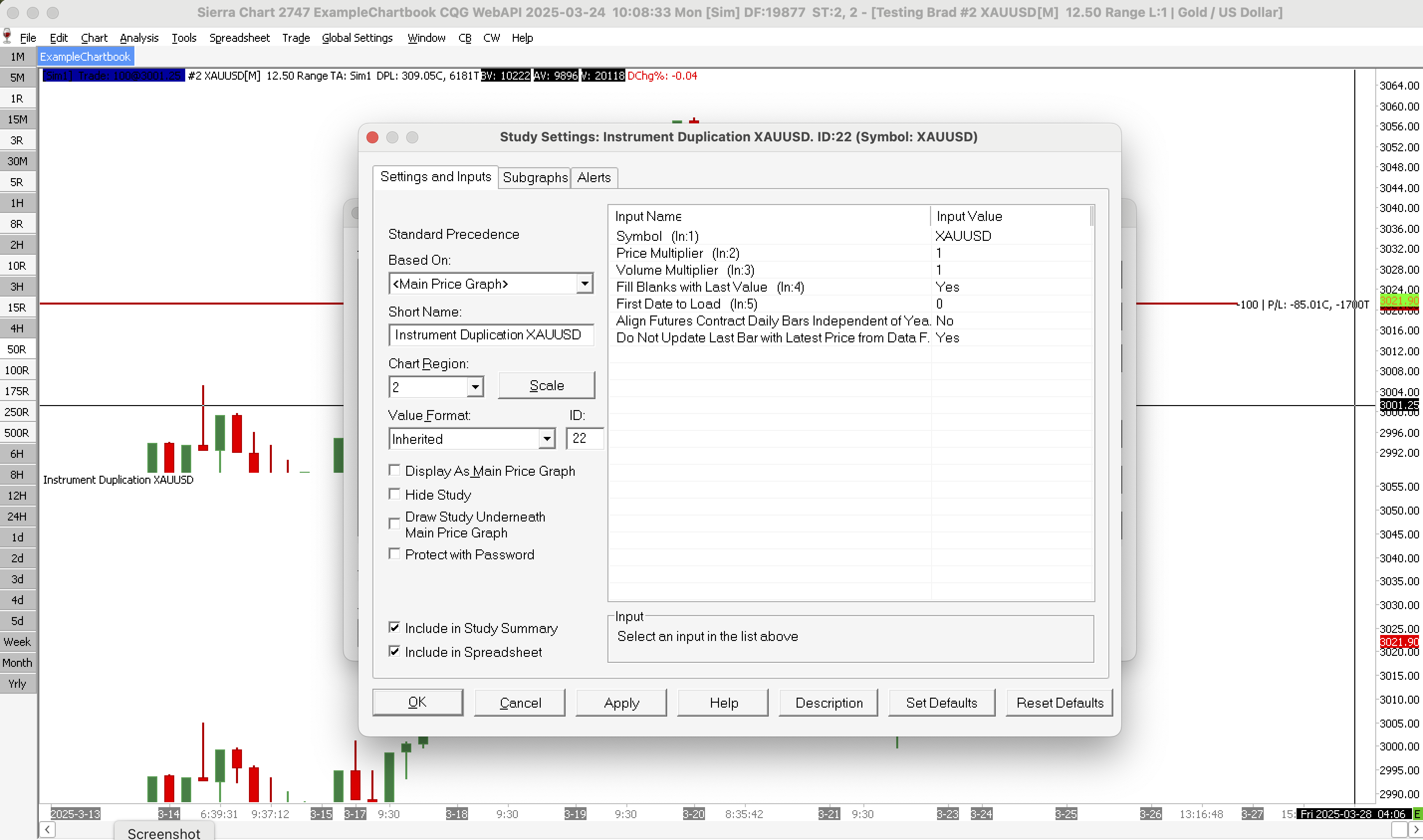

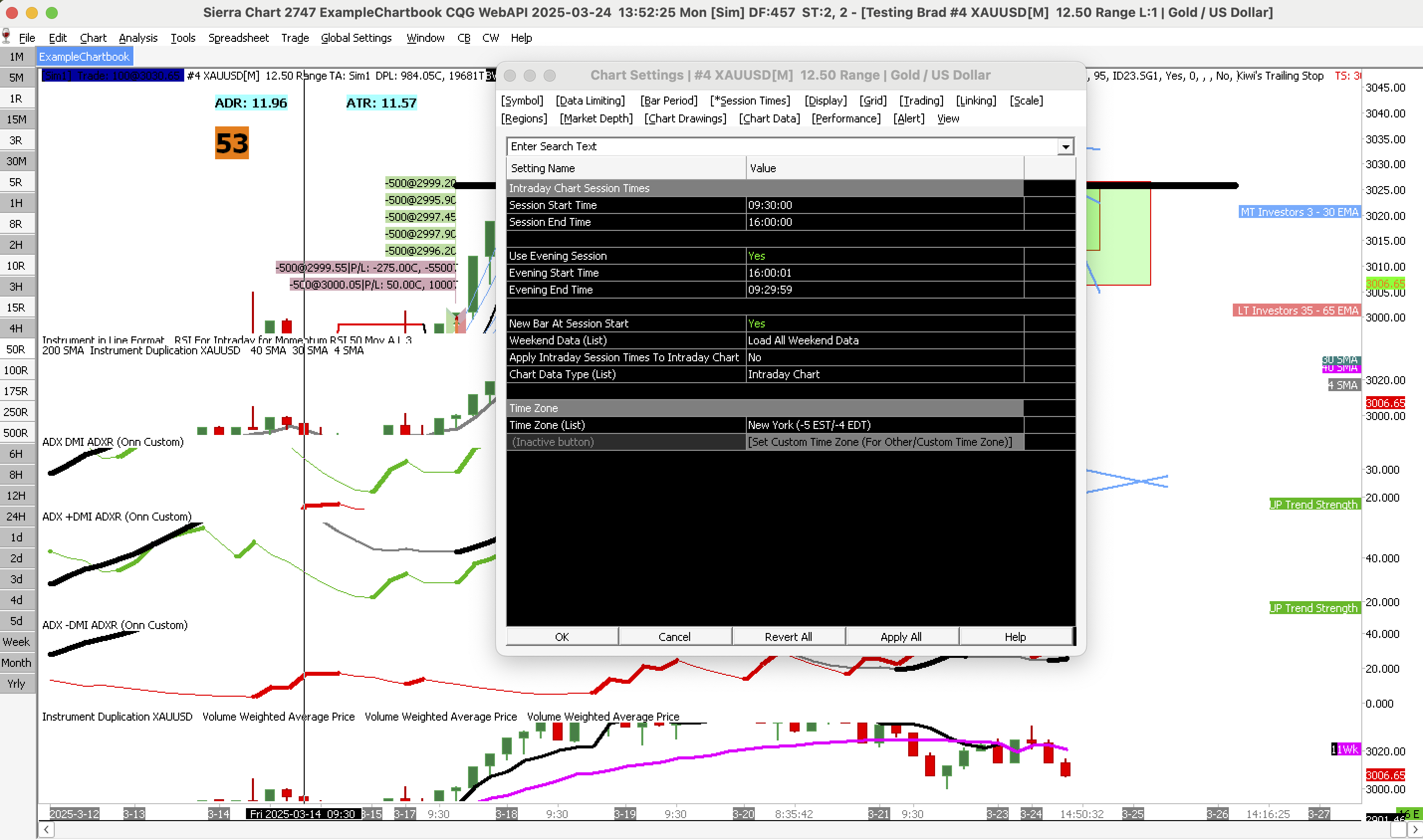

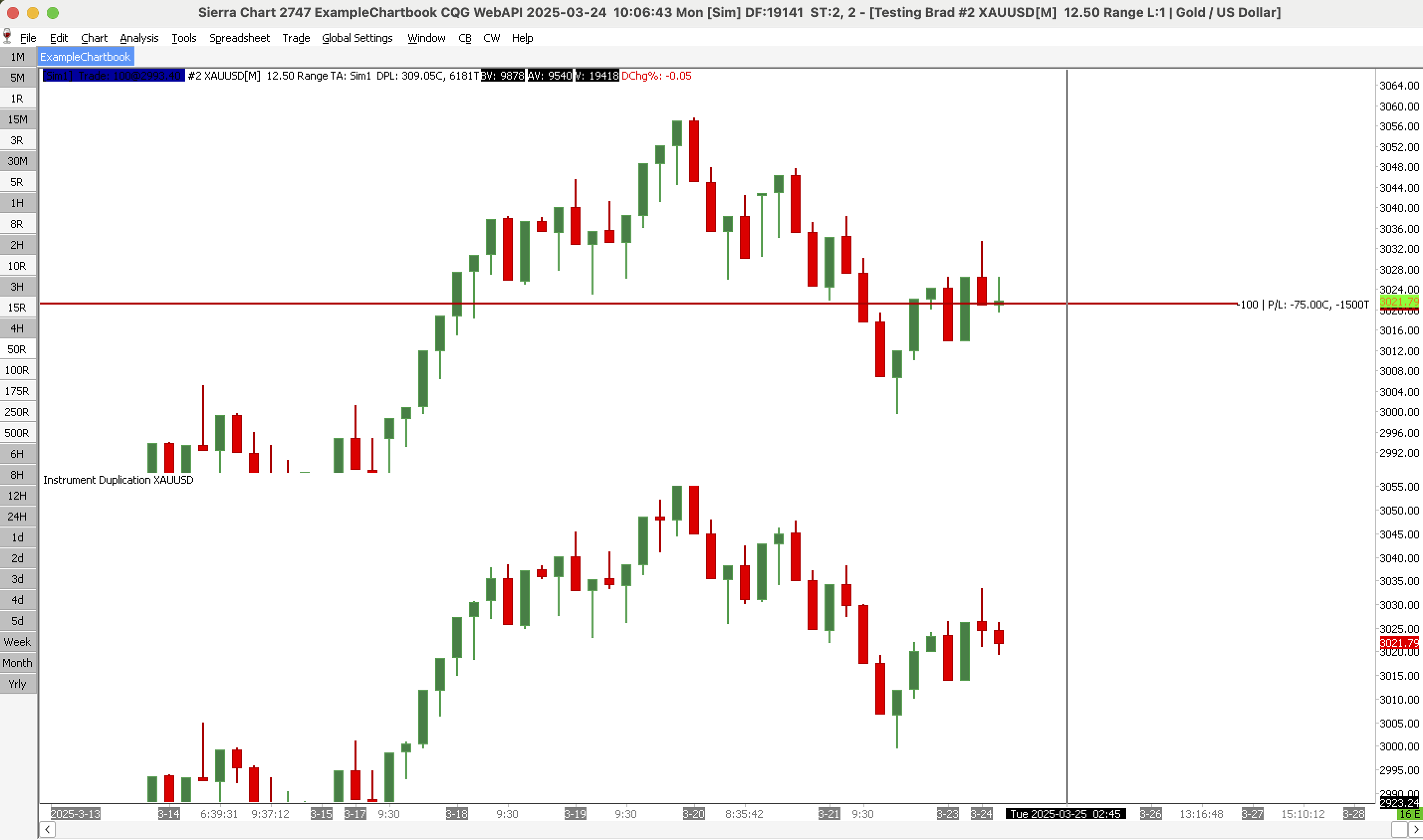

alright lads, please see the attached screenshots. one is for the setting of the study and the other is showing a comparison between the main price chart and the instrument duplication study. my question is, why are the candles printing differently on the study. i thought it was duplication study and i require them to print the same. please note the candles to the far right, which are the most prominent

Do you have the option for "New Bar At Session Start" set to "Yes" for this chart? If not, then the differences you are seeing would most likely be due to a different amount of data loaded for the main chart versus the "Add Additional Symbol" study.
[2025-03-24 16:50:58]
SafSaf - Posts: 160
Where would I find that option to check?
[2025-03-24 17:53:13]
SafSaf - Posts: 160
found it, as per attached, and it is set to yes? what next?

We are not sure exactly why there is this difference, but we think it comes about due to the Range bars and what is described at the following link:
Chart Settings: Range Per Bar - Standard (in ticks) (Chart >> Chart Settings >> Bar Period >> Intraday Chart Bar Period Settings >> Bar Period Type)
Instead of using the "Range per Bar" use the "Range per Bar - True". This will give the proper alignment between the Main Graph and the study.
