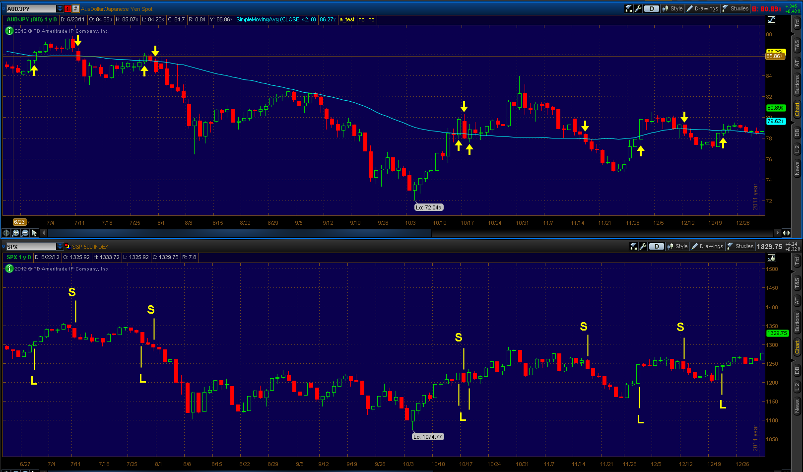

Will you consider adding a print option and arrows that don't require two points in order to be drawn and look like those in the attached image?
imageAUD-JPY.png / V - Attached On 2014-09-30 22:22:11 UTC - Size: 130.78 KB - 518 views
[2014-09-30 22:49:55]
This exists and we will put together a code example for you.
