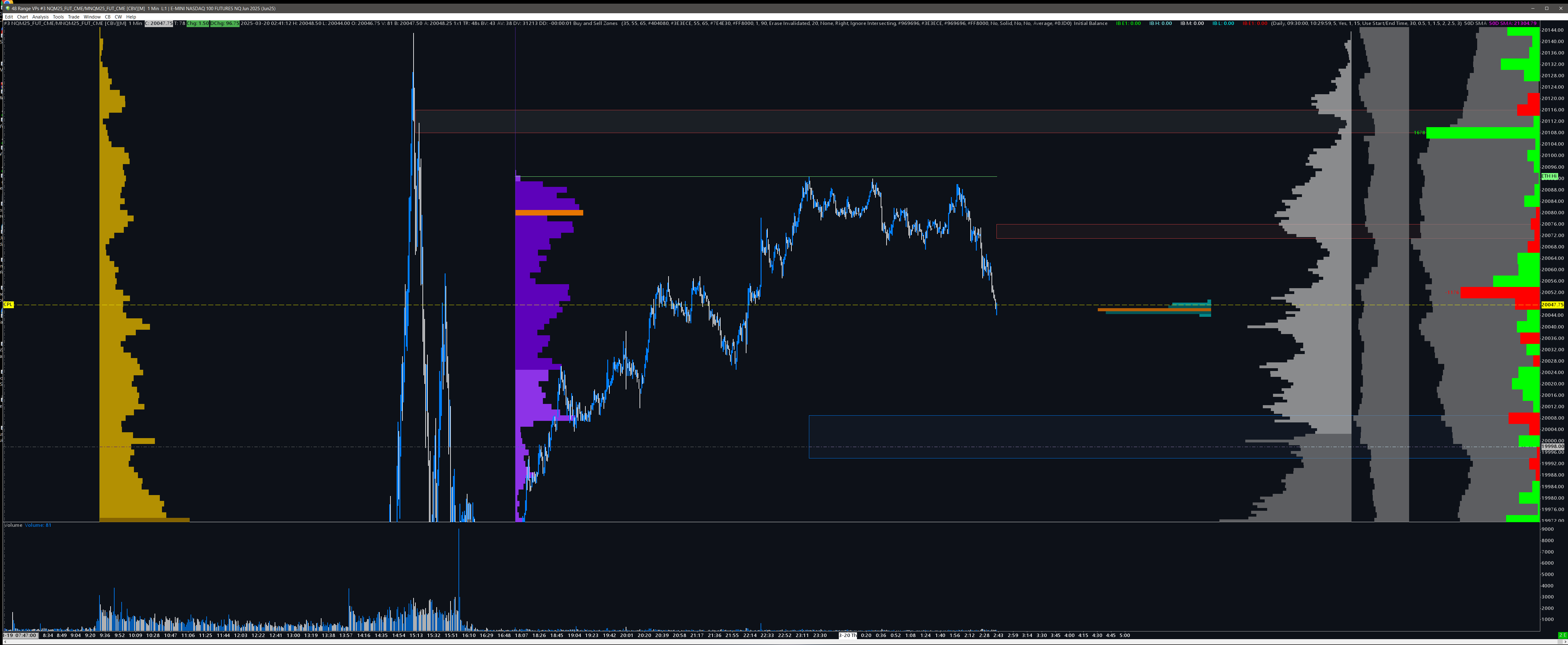

I use Volume by Price extensively in my trading. Attached you'll see I have many volume profiles, 2 on the left are for ETH and RTH, those on the far right are various 365 day, 200 day, etc...
I also trade the 1 hour ( 930 to 1030 ) initial balance and have a volume profile setup to form during this period. It is the cyan blue profile in the middle and the settings box for this profiles shows it is setup for 'Start time to end time' and those times are setup 09:30:00 to 10:29:59.
BUT, you can see this profile is forming after hours, its currently 3:10 am or so when the screen shot was taken. And the volume profile seems to be forming for a single 48 range candle! Very odd. Please help.
Note: it does reset and form correctly during the IB period.
https://www.sierrachart.com/image.php?Image=1742293361584.png
( using your screen shot tool I cannot get a screen shot with the setting dialog open, happy to upload one or email a screen shot to you directly )

Apart from a few specific exceptions, Sierra Chart studies are based on the bars in the chart. As such, you can not specify that you want a Volume Profile from 09:30:00 to 10:29:59 if the bars do not fall into that range. Otherwise, you get what you are seeing - the Volume Profile will be for the entire bar that includes that time period.
In the end, if you want to see a 1 hour profile on a range bar chart, it cannot be done.
