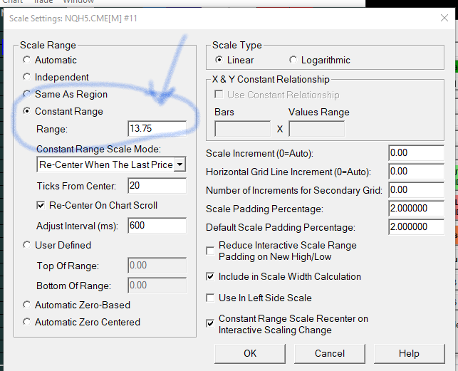

My DOM size scale changes when changing symbol from symbol list. See the attached pic. The circled area is what changes from my set 19 down to the 13.75. Is their a way for the system to stop doing this. It is very annoying to constantly have to change the settings every time I change symbols.

attached are the setting you are looking for.

Thanks.
So the scale is not being reset due to linking. That is what we wanted to make sure of.

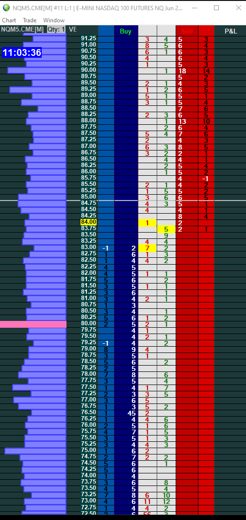

When the symbol changes from the NQ to the MNQ, the prices and range are the same. The size of each row should not change when doing this? See attachment of each DOM. First the starting and the second showing much larger rows.
Please advise how to correct.

Sierra_Chart Engineering - Posts: 25484
There is not a way to solve this. This is just how it is and for a very very good reason. If there is any changes to this, then there will be a new set of complaints, which we do not want. Those are considered different symbols.
