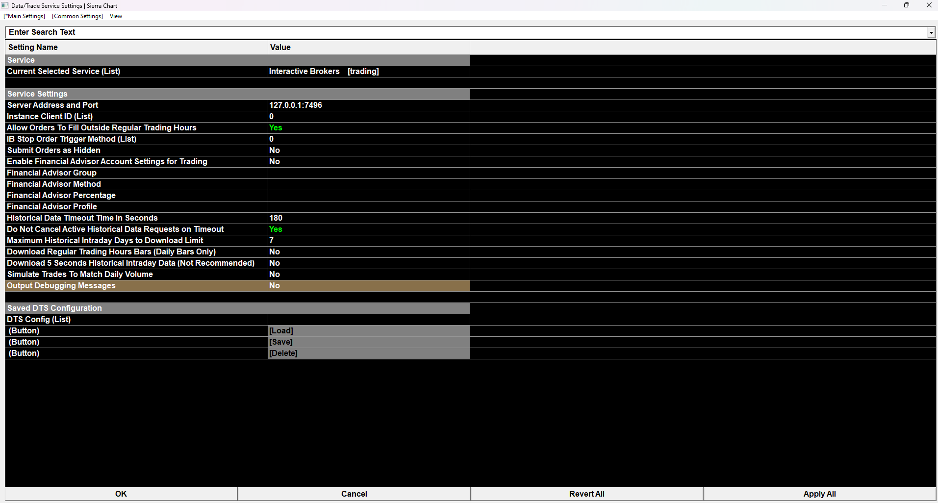

I've been following this documentation to set up the IBKR connection: https://www.sierrachart.com/index.php?page=doc/InteractiveBrokers.php#Introduction. On step 23, it states "Set the Service Setting >> Default Currency Code to the currency code that will be specified with stock symbols when a currency code or exchange is not specified with the symbol." However, I cannot find a "Default Currency Code" setting in Sierra, even after redoing the steps from the beginning multiple times(see the attached screenshot). I am using version 2744 of SC.
I understand your reluctance to help with external integration questions, but I do believe this is on Sierra's end as either the setting should be there or the documentation should be edited. Thanks in advance.

That is (or was) an Interactive Brokers setting. We do not know if they moved it or even possibly removed it.
It really should not be an issue, as Interactive Brokers requires that you specify the currency with the symbol, so you would enter the symbol as "IBM-STK-SMART-USD".
